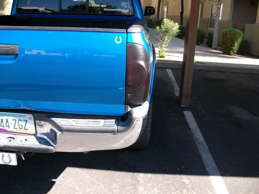

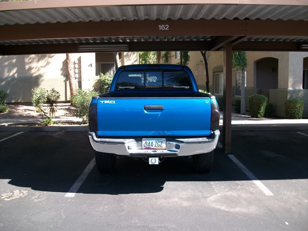

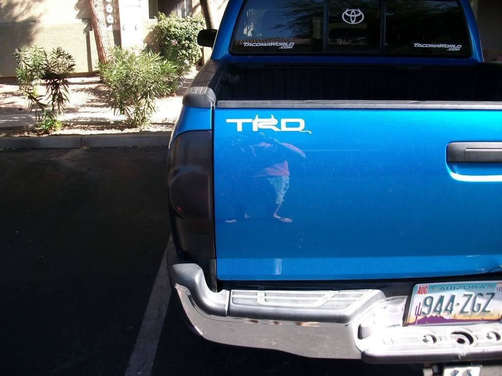

    The pics aren't very good because of the high sun but here ya go...

    what did you use? I thought they were suppose to be glossy, some people's are and some arn't? I wanna do it but haven't quite got the balls yet to potentially mess up my taillights.

    I used Nite Shades Spray Tint. I wet sanded the hell out of em with 400 grit sand paper and let them air dry. Then I used rubbing alcohol to clean the surface and put 3 coats of Nite Shades on and 3 layers of Clear Coat waiting 20 minutes between each coat. I like the dull matt black look better...i'm not much into shiney things :cool:
    The shiney ones your refering to are like clear black stickers people put on their tails. I think this is more durable
