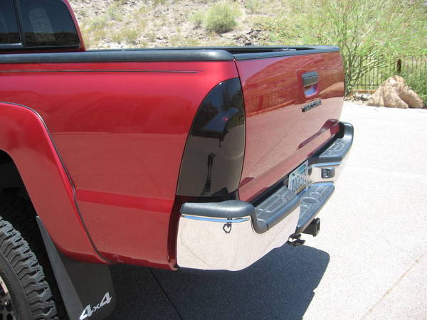

  10. Mar 21, 2010 at 7:52 AM
    THExBUSxDRIVER
    THExBUSxDRIVER Victory is reserved...
    Mar 19, 2010
    #33508
    4,139
    GOO5E
    Old Man Tan!
    Not enough.
    weekend project! Nice job btw

    Pioneer head unit, PAC steering wheel control modual, Hard wired Sirius radio, Hard wired radar detector, Hella Supertone horns, Blacked out badges, Smoked Tails, BHLM (color matched Speedway Blue), T-Rex Eyelids, Black Powder Coated Billet Grill, Color Matched Engine Cover, Lund in channel vent visors, FJ Cruiser wheels, Leer 100XQ shell, OEM bed mat, Piezo beeper for locking doors, Tinted front side windows, Black Westin bull bar, Aires tube steps, Mini Maglite Mod, D-Cell Maglite Mod, Weathertech Digifit Floor Mats
    Wow those babies are dark.....
