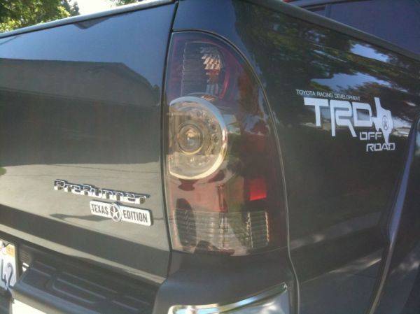

    My son is the IT manager at the Honda dealership here in town and there body shop did them. $60.00. One coat only, do not want a ticket.

    This stuff worked well for me, and a few SD CT members. Its RC window tint, from the hobby store.

    one more pic

    I wasnt the one who did my tails. Chris (from CT, cant remember his SN), did them.
    All he did was scuff the lens (outside) with a scotch brite pad, clean the lens, applied the RC tint (apply coats till satisfied with shade), then sprayed clear.
    I believe he did 3 coats on mine.
