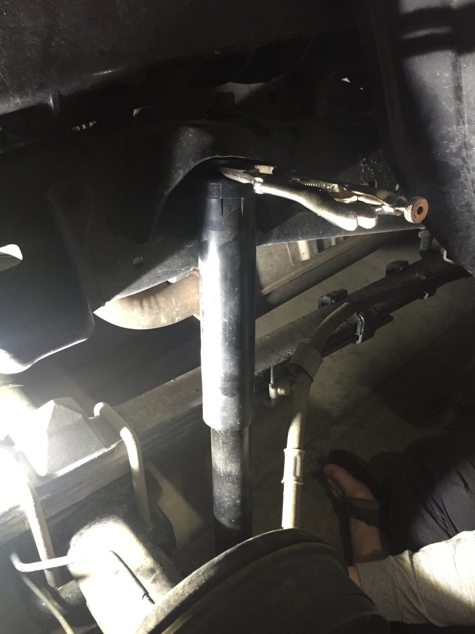

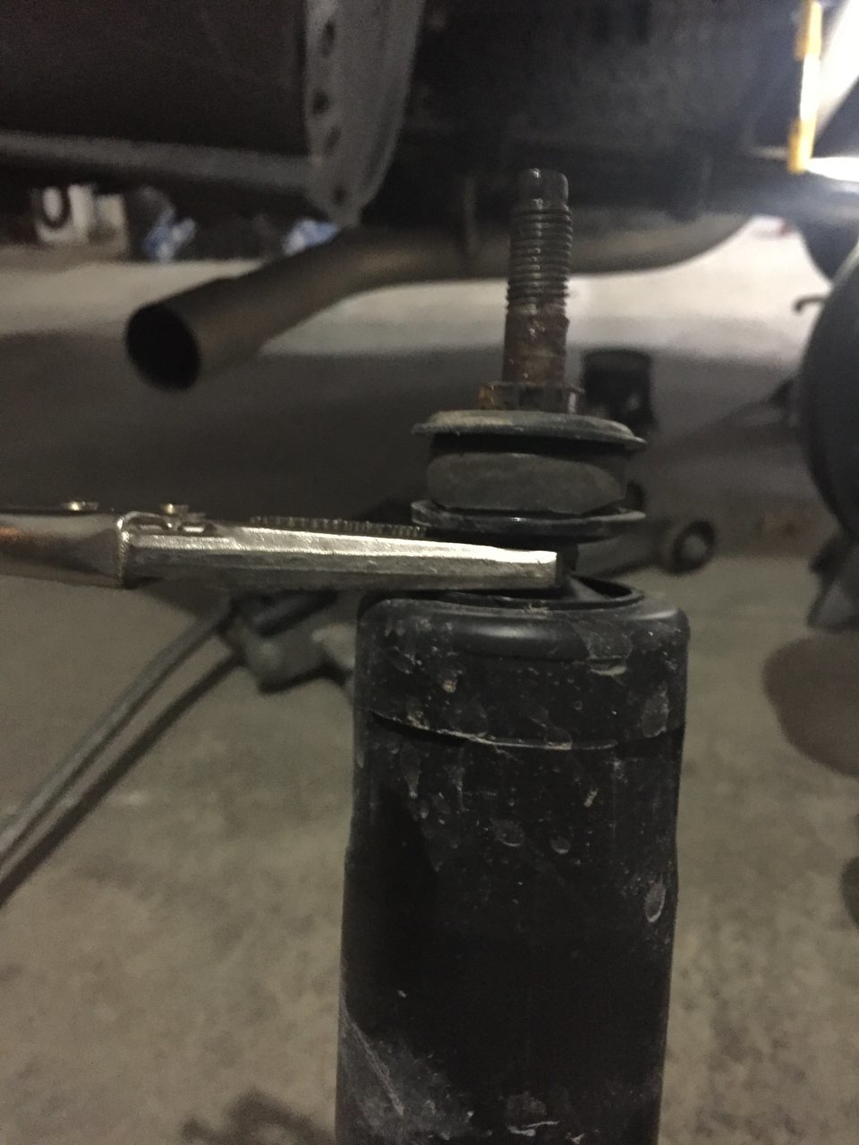

    Probably a topic that has been touched on a few times but, here it goes.
    So after 30k miles, I finally got around to swapping out the suspension on my 3rd gen SR.
    Naturally, the bolts have seen better days and were pretty seized due to corrosion despite being sprayed religiously with PB Blaster.
    When attempting to remove the rear shock absorber, the piston just spun, and spun, and spun.
    Okay, maybe it needs some uga dooga's from an impact. Nope, no luck.
    So I consult TW, did many searches and found out that people were resorting to grinders or clamping a vice grip directly to the piston after removing the dust cover.
    Here's the simplest way that I found on getting the shocks off WITHOUT cutting anything.
    Note: I have zero intention of ever re-using these parts but you might notice that the area I clamped onto isn't actually making direct contact with the piston.
    Step one: Remove the lower bolt that attaches the shock to the axle. From there, let the shock fully extend downward. This will create a cavity/clearance that will allow you to get a small set of vice grips in. This gave enough grip/bite to get the bolt off with minimal spinning of the piston.
    Note: The keyed section at the top of the shock does have a socket specifically for it that allegedly prevents shaft spin. Well, it's not very sturdy as it snapped right off on my divers side shock
    See the pictures below.

    If you are referring to the slotted tip, I did attempt to use a vice grip on the top and after two good cranks, the tip broke off.
    They make a socket for it link here: https://www.amazon.com/CTA-Tools-A4...ocphy=9023827&hvtargid=pla-449889604011&psc=1
    But it seems to be a weak spot from what I have experienced

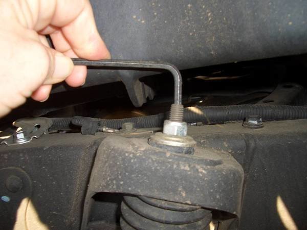

    you sure you can't put an allen wrench on top of that thing??
    take this picture as an example...

    Typically you get hex keyed or you get the kind that need the socket but not both.

    On older gens that works IIRC. The 3rd gens aren't keyed for an allen wrench.
    You also need to make sure that when working on suspension that is keyed for an allen, that its not for making adjustments to the suspension.
