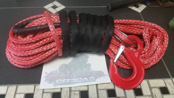

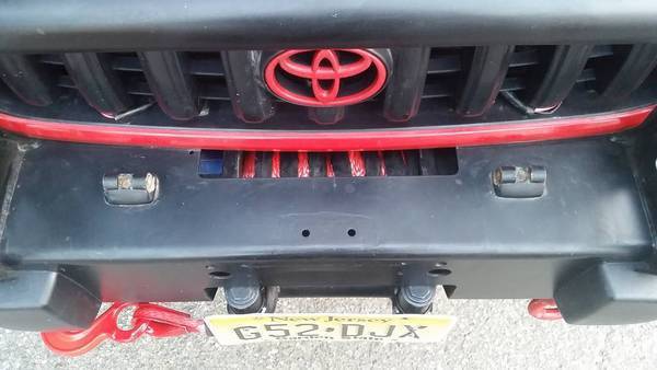

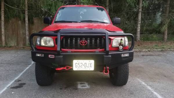

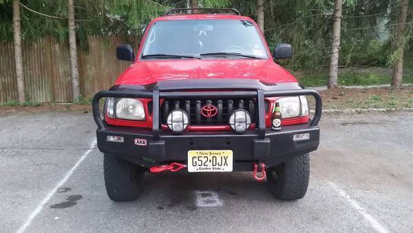

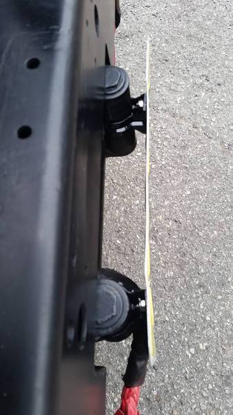

    well I finally got the line spooled yesterday! I used my BIL's truck as tension and it spooled up evenly and nice and tight on the drum. I bought a 100' rope and cut 25' off to make an extension (maybe some soft shackles too). The full 100' would not have fit on the drum anyway.. might have gotten away w/ 85' or so..
    Daystar poly rollers seemed to work just fine
    W/ the plate on
    W/ the lights

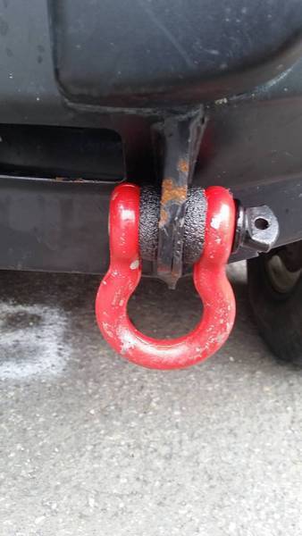

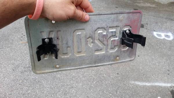

    For the license plate holder I bolted a set of D-cell Maglight brackets to the back and they snug onto the rollers perfectly!
    To prevent the shackle from rattling around I used some pipe insulation and just wrapped it around the pin.

    Do you notice much shackle rattle? I just threw some 5/8"s on my rear bumper and don't think they move at all. I am disappointed at how puny 5/8" shackles look compared to my 3/4" but 4x made the holes that way so i gotta deal.

    Honestly I haven't even driven anywhere yet with the shackle up front haha.. I figured it would shake around though and I hate the look when the shackle is cocked to the side. Had the pipe insulation lying around Soooo whahla!

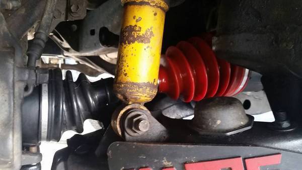

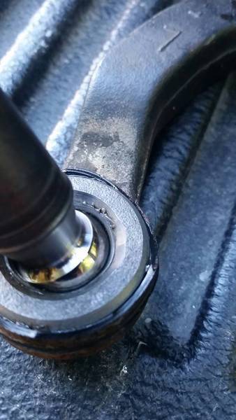

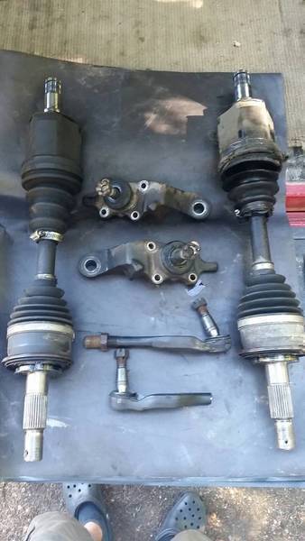

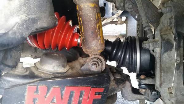

    Today I installed new CVJ axles, Oem LBJs (Camelback Toyota) and Moog inner/outer tie rods. Went pretty good, and it was my first time doing either one!!
    Axles and boots seemed to be of really high quality. I went with the high angle inner boots and from the looks of them they are definitely an improvement in the spacing of the fins. We'll see how they last. The old ones were freakin toast :eek: To pop the axles I found that a large Cat's paw worked great on the DS and a BFH on the other. Had to run out and get a deep socket 35mm b/c the one I had was too shallow. :frusty:
    out with the old
    The inner tie rods were a bit worn and the outers had a ton of slop in them. I cut open the OTRE boots and there was some significant wear. The LBJs that I took off were def showing their age too, these had ~150k on em. Buttoned it all up, took it for a spin and things felt smoooooth :). And the steering was sooo responsive !!
    Hoping to get some new rubber pretty soon so I think I'll wait to get it aligned til then most likely.. Tracking pretty good right now though.. Can't wait til I can get some new UCAs !!!
