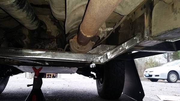

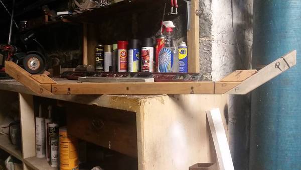

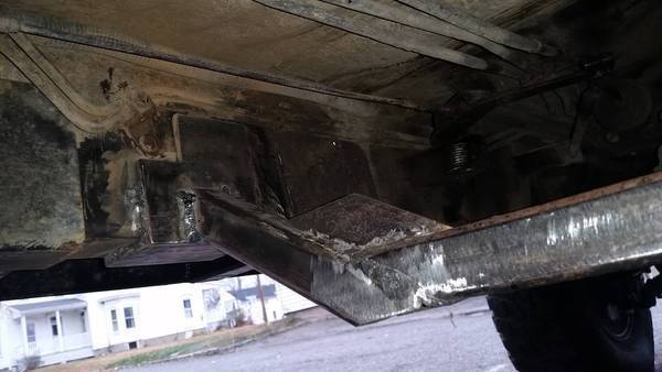

    I've been working on fabbing up a TC skid this past week.. I wanted there to be a bit more coverage than is offered by BB and Skid Row, so I designed my own based largely on the ones made by BoxRocket and HBtaco02.

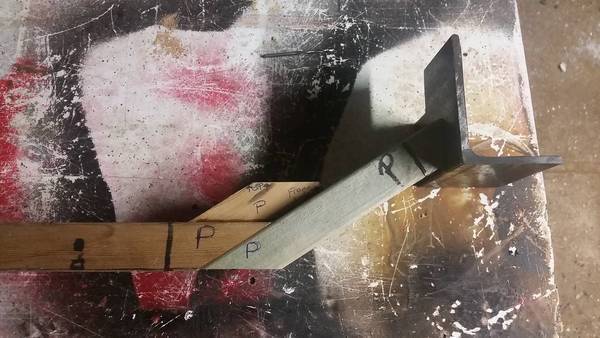

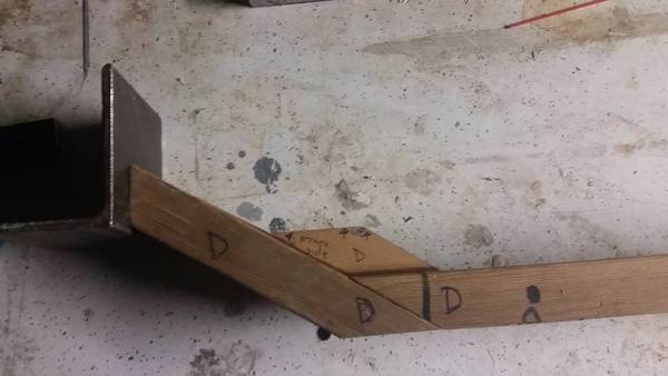

    First I made a wood template of the cross member out of some old deck spindles I had lying around. Added some gussets for strength
    then I cut some frame plates out of 1/4" angle iron

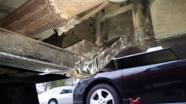

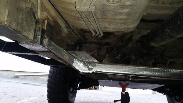

    A buddy and I then made the x-member out of 1 1/4" square tube (1/8" I think), welded on the frame plates, welded in the x-member, then welded a front-to-back support bar from the existing oem mid x-member to the new one. ... (Go easy on me about the welds.. :eek: it was literally the first time I ever used one.. they are solid as hell though)
    Frame plates could have been a bit shorter, could still cut them down if I get around to it (not fully welded)
    DS frame plate had to be notched out b/c of the hard lines in the way
    Here you can see the front-to-back support that was added

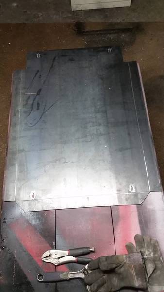

    I bought a sheet of 3/16" plate and began cutting it up.
    Only had an angle grinder to do the cutting but it came out really nice. I drilled out two holes in the new x-member for through bolts and drilled some oblong holes into the skid. Got it all mocked up into place and it fits perfectly!! The TC skid 'underlaps' my RAT tranny skid and uses the same mounting hardware.
    Just need to finish doing the 'whiskey bend' technique and get it all painted

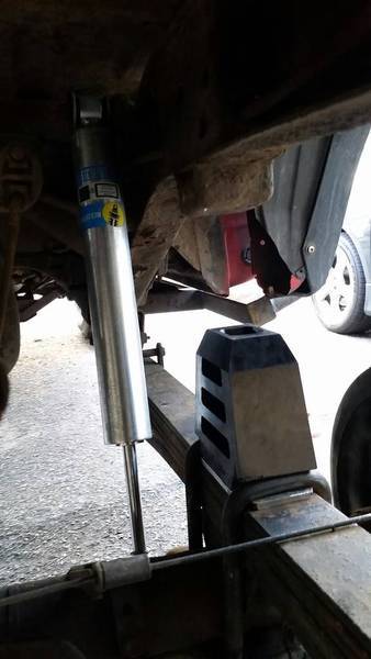

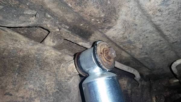

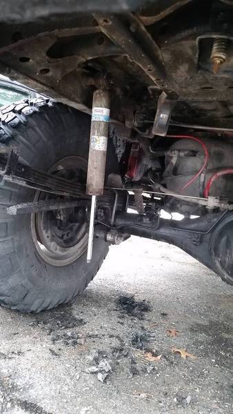

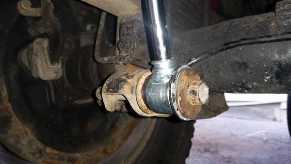

    well I finally got around to upgrading my rear shocks, 10" Bilstein 5125s 255/70 valving
    I had to drill out the bushings that came with them b/c the ID was too small to fit on the mounts, and also added an additional washer to the bolt side of the mounts to make up for the difference in 'width' of the eyelets/bushings. My previous 5100s were about 3/16" bigger (shown above)
    I ordered a pair of Daystar 4.5" wedge style bump stops that I'm gonna bolt to the strike plates on the frame, should have them Tuesday
    No more over extending my shocks!!:anonymous:

    Ordered through Amazon prime.. $150 w/ free 2 day shipping .. DSM was like $30 more, "no TW discount" per whoever I spoke with, soo $$ talks this time of year !

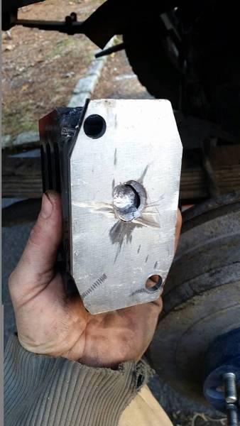

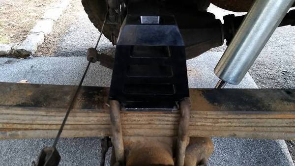

    Got the bump stops figured out.. Daystar 4 1/2" #KU09009BK
    I hated how it looked bolted to the frame, so cut off the mounting bolt, and came up w/ something that I think should work pretty good
    I modified the base to allow it to be installed flush against the leaf pack, (the two holes in the corners were there already) just had to drill out for the centering pin and shave down the corners.
    I also drilled out some of the poly bump material to make space for the bolts
