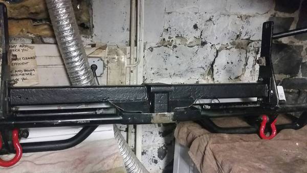

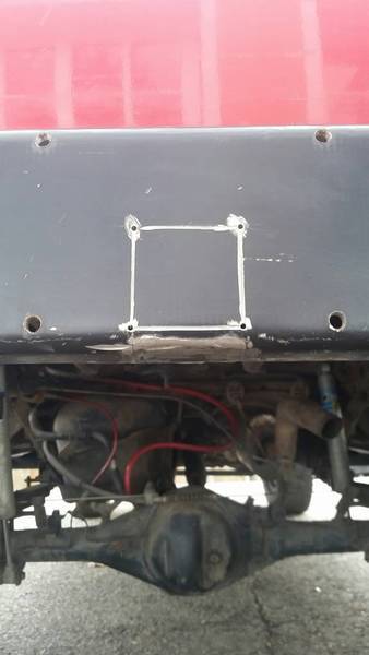

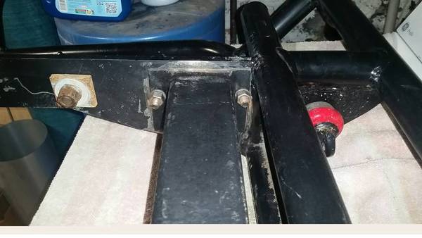

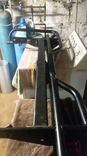

    Over the wknd I started to work on the hidden hitch in my rear bumper.
    first I cut off the existing hitch that came on the bumper, ground it smooth, and marked out where the hidden hitch receiver would be.

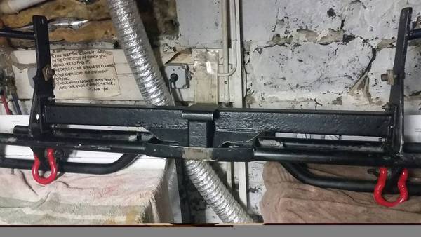

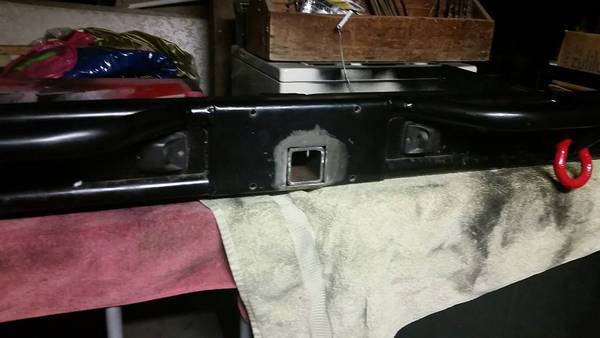

    this is a pic of the hitch that came w/ the truck

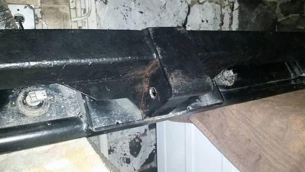

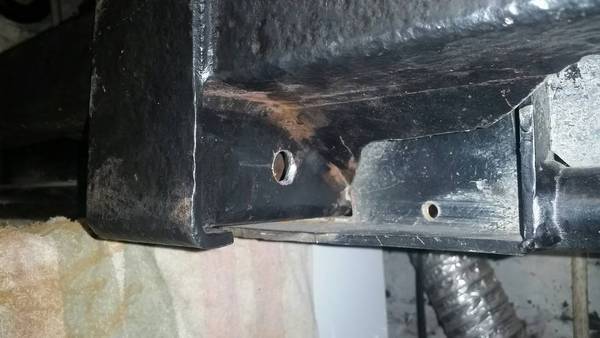

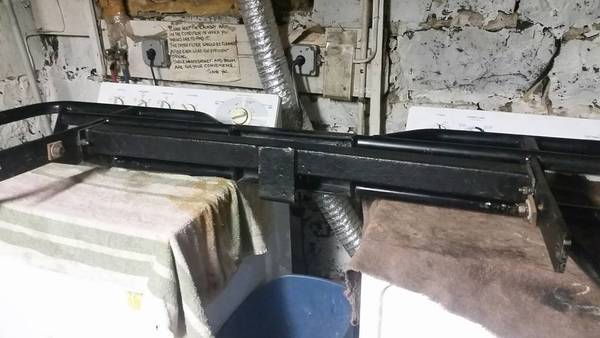

    the cross-member/receiver is attached to the mounting plates with 4 thru bolts/nuts on each side positioned at 12,3,6, and 9 o'clock. My idea was to remove it from the hitch mounting plates and bolt it to the bumper mounting plates. I figured this would save me quite a bit of fabrication as it was already the right width, already had a plate on each end and bolt holes to work with, and was rated as a class III hitch so would be plenty strong.
    After quite a bit of measuring and test fitting I was able to trim down the receiver gussets to allow the whole thing to fit in behind the license plate 'box'. I also drilled out the holes for the hitch pin.
    I then cut down the receiver tube so that it sits flush w/ the outside of the license plate box. This will allow me to get a flip-up license holder, or even just still use the 4 license mounting holes that the bumper came with, which I drilled/tapped to take a m10x 1.5 bolt.
    I had to cut down the top of each end plate on the cross-member b/c it stuck up above the frame, thus causing me to lose the bolt hole in the 12 o'clock position
    The bumper mounting plates had a 5/8" hole on each side (possibly for a shackle mount) which unfortunately interfered with the ability to use the bolt holes in the 6 o'clock position. You can kinda see what I'm talking about here vv
    So what I was left with is mounting bolts in the 3 and 9 o'clock positions
    Here are a couple more pics..
    Overall I am very happy with what I was able to come up with! the hitch seems extremely stout despite only being able to use 2 mounting bolts on each side. I used grade 8 bolts which join the 1/4" cross-member plate to the 3/8" bumper mounting plate. When my buddy gets back from Hawaii :)jellydance:) I'm gonna get over to his shop and add a few small welds to the mounting plates (top, bottom, and maybe a couple tacks to each side) and where the receiver tube exists the license plate 'box'
