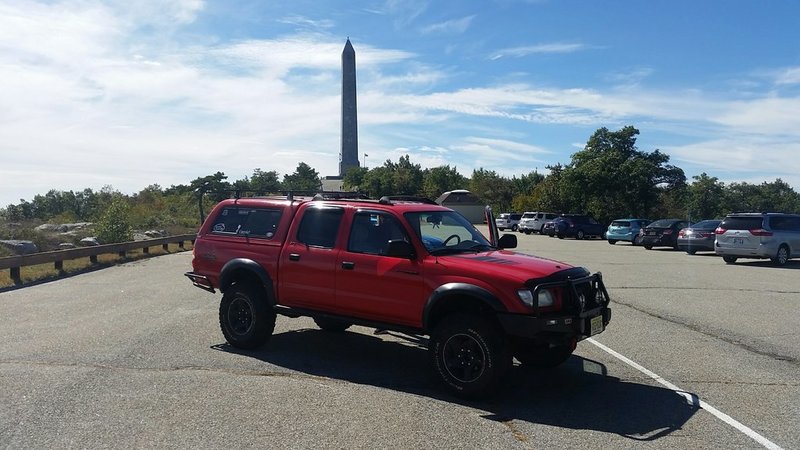

    This past week I addressed a few little rust areas on the undercarriage and did some painting. Threw on the skids and km2s. Also replaced a valve stem that got destroyed last trip to RC. Then took a nice scenic cruise up to High Point State Park with my wife and dog. Beautiful weather and beautiful country!!
    got a trip to Rausch planned for this upcoming wknd, should be a great time, pics coming soon!

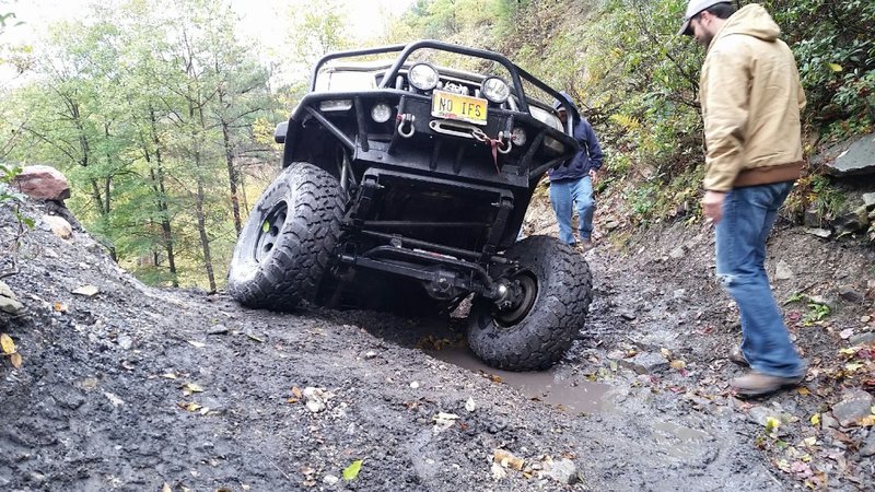

    Wheeled w/ some members at Rausch Creek on Saturday. Weather coulda been a bit better but we made the most of it. Got a lil bit of trail damage to start off the day, but least I got it out of the way early.. :rolleyes: .. @Wheelspinner @Rebelimo need a band aid too! http://www.amazon.com/dp/B00G4R5XBE/ref=asc_df_B00G4R5XBE3805952?smid=A28O7XSAH2IEOK
    I'm gonna try to pop the dent from the inside then touch up the paint. If it looks like shit I might end up doing bed liner on the rockers and the fender flares to match.
    Also got to check out @ToyRyd04 fresh SAS and the thing is no joke! One seriously high quality build and attention to detail! It was awesome wheeling with him.

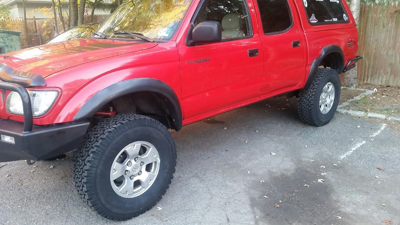

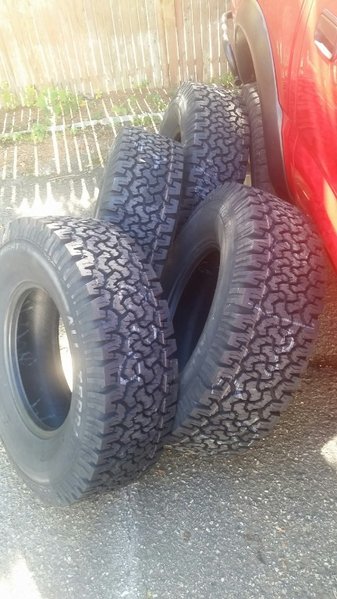

    Got my tires delivered this wknd. They look and feel really good. The full remold (B2B) seems to be very well done. I like the Treadwright Warden branding on the side. They have some seriously deep tread and thick Fn sidewalls. I went with load range D but shipping info said 54lbs each so they're pretty heavy. I'll maybe get them mounted nxt wknd/wk after I replace the PS outer TRE.

    Finally got my rubbers mounted. Balanced out pretty well. They measure out at about 31.5" mounted with weight on 'em. Put the best of the old Wardens on my spare. Got an alignment too. Rides smooth.
