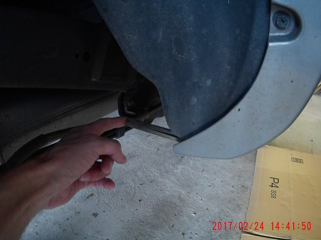

    If your rear inner fender liners rattle like crazy, try about a 4 or 5" piece of rubber hose sliced longways and slide it over the lower leading edge as pictured above, I did this on my 2nd Gen and it reduced that rattling dramatically and I plan on doing it on my 3rd Gen whenever I get it.
