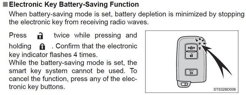

    I'll be honest here, I haven't read all 41 pages, but I have a question that I haven't been able to find an answer for. I have always left my car keys in my car when parked in the garage. Will leaving the fob inside the cab cause the battery to wear out faster than bringing it in the house?

    I may be wrong but I have a recollection that there is something in the manual in the FOB section that says it does drain the battery. It tells you how to turn off the FOB by pressing two buttons on the FOB until the LED flashes.

    Now that you mention that, I seem to recall it also. It said something about if you are washing/cleaning it to do that to prevent battery drain. I'll look for it in the manual. Thanks for the memory jog!

    The key can be disabled by holding the lock button and pushing unlock twice. This is great when you want to leave the FOB in the car and just take the door key, i.e. running, backpacking, kayaking etc.

    I found it last night.

    Okay so this is probably obvious but I did some research. It's the truck that sends out the transmission looking for the FOB. The FOB remains dormant (somewhat, its still using power waiting for the truck signal. That's why battery change every year or so) until it receives the signal from the truck. When the truck receives a return signal from the now active FOB it will activate what ever you have designated such as interior lights. The FOB and truck exchange signals as long as they are in range with each other. Or until the truck is started. Once the truck is started the FOB shuts down. Hence the reason you can start the truck and walk away and the truck continues to run. When you shut the truck off the truck starts transmitting again looking for the FOB. Toyota tech says that the fob uses a very insignificant amount of power when exchanging signals with the truck but it could eventually drain the FOB battery. Toyota recommends if you are not going to use your truck for 30 days or longer you disconnect the battery as power is used by the truck sending out the transmission and it overrides the 15 power shutoff. Also Toyota says if you put your truck in a garage do not store the FOB within 5 feet. Otherwise the FOB and truck will spend the time sweet talking each other and drain the FOB battery. (Thank you Tim Hubbard Toyota service manager):deadhorse:
