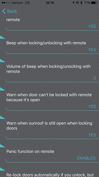

    is there any way to quiet my alarm bleep when locking or unlocking :/ .. im so over hearing that?

    i think it's in "Vehicle Settings". i actually raised my volume so i could hear it across a parking lot.

    Page 596 of owners manual says dealer can change. Carista app does it also if you have an OBD wifi or Bluetooth adapter image.jpg

    Which OBD wifi / Bluetooth adapter are you using with the Tacoma? Id like to get one to turn off the damn seat belt chime.

    I got the Carista one. It's $40 the app is free but you have to pay a one time $20 in-app purchase to make some changes. I know some folks on here. Maybe in the "what have you done today" thread have used a Wifi that runs $17.99 on Amazon. I have OCD so I get everything to match and got the Carista one. Worth it for me. Links up fast and you can change a lot of things. Turn signals, defrost auto, most bells and chimes. Seatbelts etc. and you don't have to mess with a cranky service tech. You can change stuff as often as you want.

    Yes you can definitely change it. It's in settings. I just turned mine up the other day. I like to be able to hear it from a distance or in the house.
