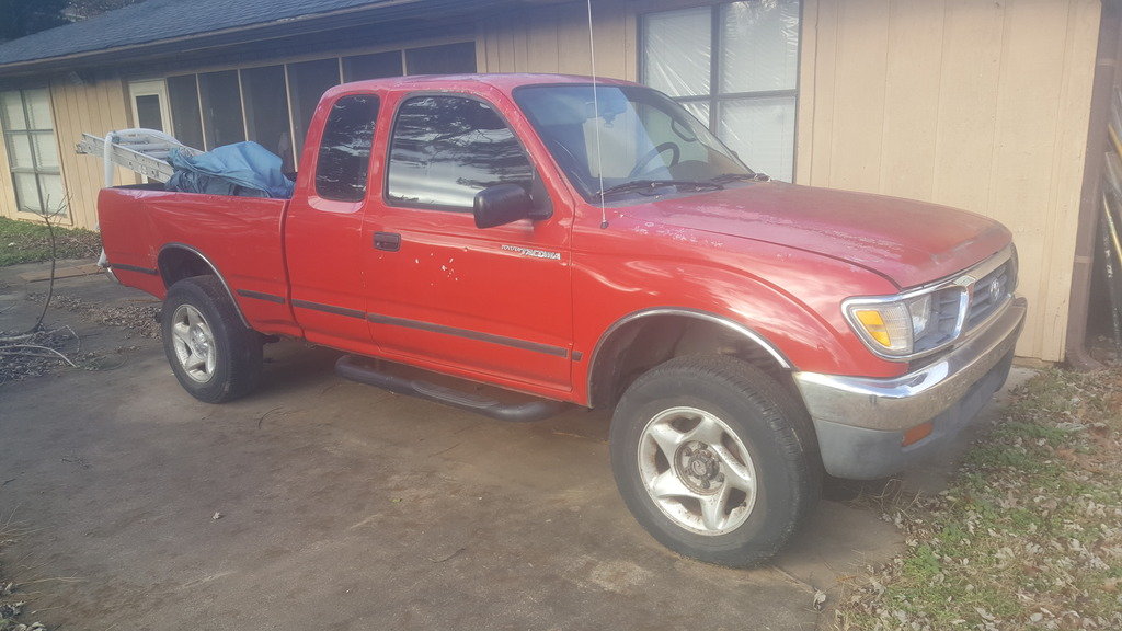

    Hello fellow members,
    I apologize ahead of time if this sounds like another newb thread, but I really need your guys help. I inherited my fathers 95 tacoma after he passed not long ago. I am about to sell one of my toys to bring my fathers truck back to life so it can be my new daily driver, with a more aggressive look. Upon completion I plan to sell my daily so that I don't have more than 2 cars.
    Interior and exterior wise I already have a route I am planning on taking. The seats, carpet, door panels, headliner, and dash will be cleaned and sprayed black , I am sourcing black carpet and having the seats re-wrapped in black fabric as well.
    Exterior wise I am having body work done and having it resprayed its factory color (red).
    As for the suspension and motor maintenance thats where I need you guys. Let me start with the suspension questions I have.
    I plan to do a 2 to 2.5 inch lift to accommodate bigger tires on aftermarket wheels. I know the rest of the suspension probably needs some maintenance so that it doesn't drive like poo after the lift. What all do you guys suggest that I replace? Balljoints front and rear? are there upper and lower balljoints? Inner and outter tie rods? Any bushings? And obviously front and rear shocks/struts.
    Motor wise I know my pops had a recent timing belt and water pump replaced along with the regular maintenance items (spark plugs and wires). The problem here that I am trying to figure out is why the mph needle doesn't go up and down normally. It is bouncy. On the highway the truck is slow to reach high speeds 60 + mph. I recently found that the intake pipe is broken so I am sure that has to be part of the problem. Transmission feels strong but I remember the clutch being replaced about 6-8 years ago, should I have that replaced as well?
    Any help and advice will be gladly appreciated.The truck is rough but I know that with some time, work, and money I can have it looking and running great.
    P.s I plan to do most of the work myself.
    http://s1294.photobucket.com/user/vmendo00/media/20181203_093345_zpsxoxvdogs.jpg.html]20181203_093345_zpsxoxvdogs_2c3e63962979192f6169d9a369ce51d995eb8133.jpg[/URL]

    I wonder do you have a Tacoma or a Pick Up ??

    I’m also curious. People mistake the Tacoma and Pickup all the time.

    I hate having a lot of stuff and stuff taking up space. I rather save money on taxes and insurance. The truck has been in Arkansas most of its life. Very little to no rust. Check engine light is on, just havent looked into the code its throwing out.
    Its a Tacoma, not the little tacoma pick ups. And thanks for the tip, I was looking into a Rough country 2 in lift with their front and rear shocks, are those any good? The price seems nice.

    What on earth is that supposed to mean? :rofl:

    Lol like I said pardon my lack of knowledge. Just posted a pic of it in my original post.

    No worries, it's a nice truck! That's the Tacoma... Earlier in '95 they made a truck just called the Toyota Pickup and the Tacoma replaced it.
    Just thought I'd add in, my speedometer needle does the same thing as yours... Not sure if that's just a mechanical speedometer thing, which would be on yours and mine, (the newer first gen are digitally controlled), or if there's something wrong with it. My tachometer needle operates smoothly, so I've been trying to figure that out for myself too.
