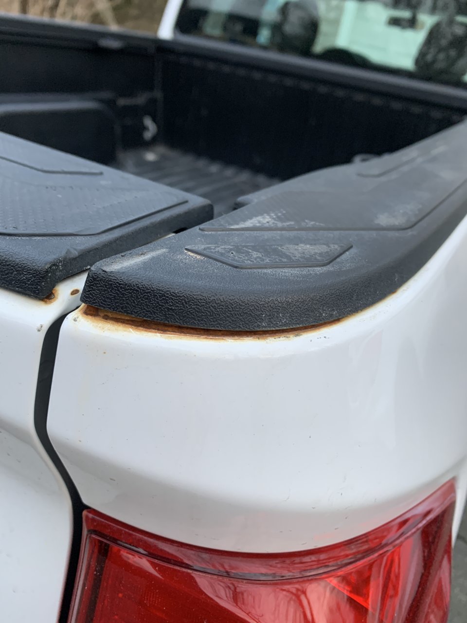

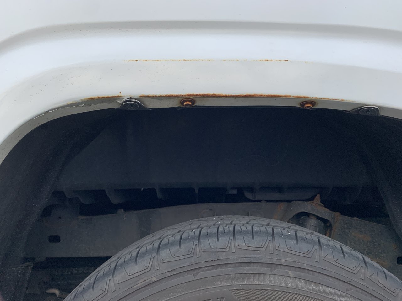

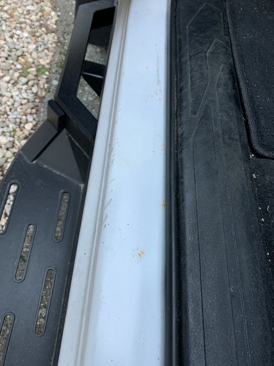

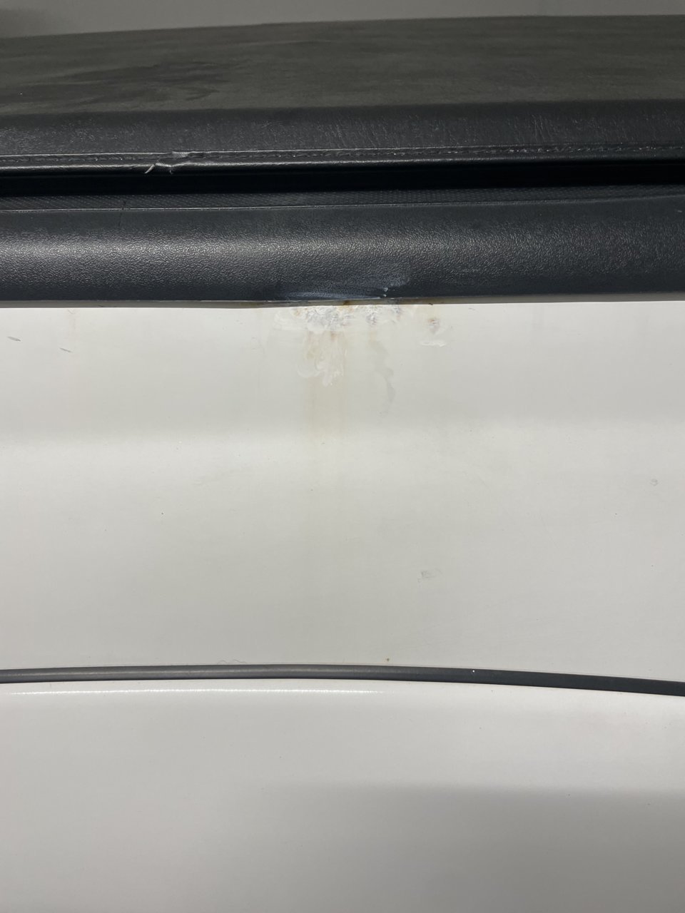

    Hi all,
    Like many 2nd gen tacos, I'm starting to see some surface rust. Would love to get advice from people here on how to clean it off, and best prevent it from building up. Pics are below, keep in mind the previous owner tried to use white-out or something to cover up spots. Any tips for removing it? I also purchased this OEM pearl white paint stick from Toyota. Any advice on using it?

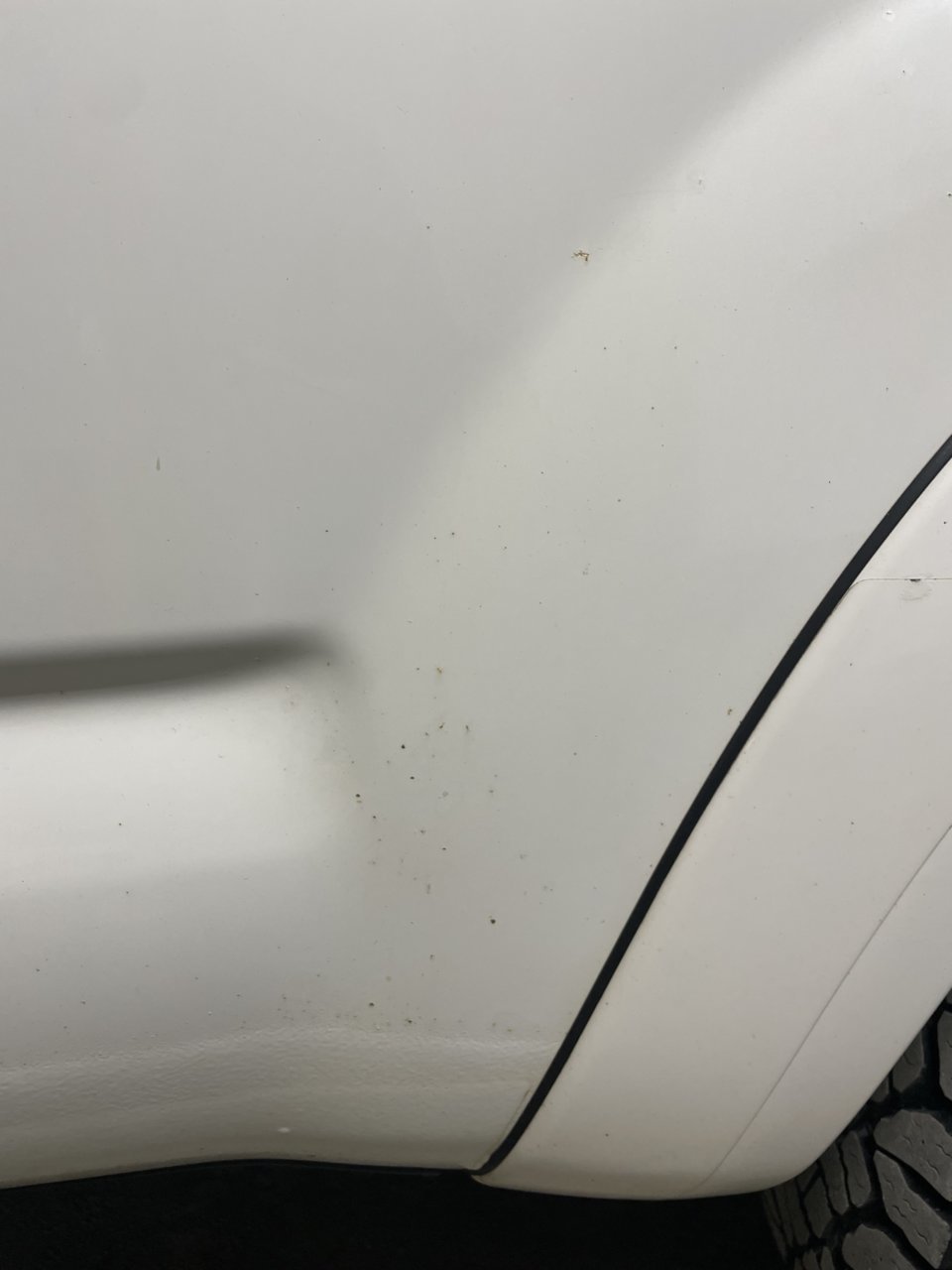

    Also would love advice for general paint maintenance. I notice a lot of darker spots from oily fingerprints. Any advice for buffing/clay-bar and preventative coating?

    Start with an iron decontamination spray. A lot of that may actually be sitting on top of your paint. Mcguires, detail geek, chemical guys and others make them. Spray it on, let it do its thing then rinse and wash.

    You might want to take that plastic bed rail cap off and see what is causing the rust in the first place. If its rusting under the cap, that needs to be fixed before it starts spreading under the paint

    As has already been said, dissolve the surface iron contamination first, then you'll have a clearer picture of what kind of shape your paint is actually in. My guess (based on over 25 years of detailing) is that you'll still have some imbedded surface contaminates which can best be removed with clay. Then you'll have to machine polish (with proper pad, pressure, products and technique) to bring the shine back to the paint. This would then be followed with your choice of wax, polymer sealant or ceramic coating. Of course, all of this is gloriously over-simplified.
    BTW, you do have some rust starting and that's a whole different story. Nothing short of sanding, priming and painting is going to help with that.

    The Detailing section here can be of some help. AutoGeek.com is even better. And you can find videos on YouTube. The thing I would caution you on is wading right in with nobody to show you how to do it in person. (And some of the videos on YT make me cringe.) Remember, wisdom comes from experience. Experience comes from messing up.
    As for starter stuff, I'd recommend a Porter-Cable 7424XP because it's reasonably powerful, but generally won't allow you to get too stupid. (Griot's Garage also makes a similar machine.) AG generally offers there in starter kits with an assortment of pads and polishes that won't get you into a lot of trouble. (Rubbing Compound will get you into a LOT of trouble.)

    Did you remove your mud flaps? Locks like you have been peppering that rear panel with stones from your front wheels....

    I am thinking maybe this is more than iron embedded in the paint. I know some of it is, like where the bed rests on the rear quarter panels the paint is worn away. But also the right rear fender looks suspicious and I wonder if there was a fender bender and a repair. There is a little inside the drivers door and I see some blistering.

    It's not beyond repair. It's beyond detailing as a fix. You'll need to sand, prime and repaint that good old fashioned rust.
