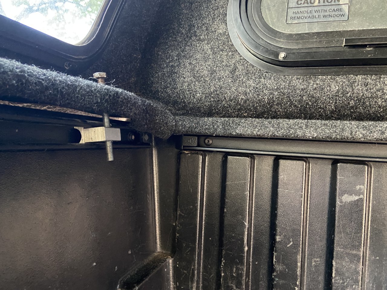

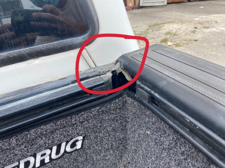

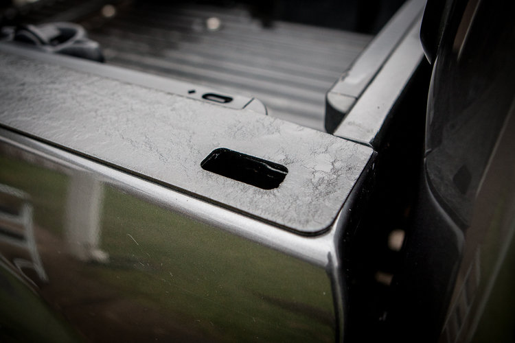

    My new to me 2013 Tacoma came with KB Voodoo Fab bedside covers (metal that covers the bedrail lengthwise). As cool as they are, they're causing me issues when trying to install a leer camper shell.
    I'll attach some pics, but pretty much the KB Voodoo covers are much lower profile / less tall than the OEM ones. When I place the camper shell on the bed, the front section of the shell (that sits parallel to the back of the cab) sits nicely, but part of the bed rail running 'lengthwise' of the truck doesn't come into contact with the shell and its seal since the KB Voodoo covers are not tall enough to fill the distance.
    If anyone's dealt with this, what are my best options? Buy the OEM bedside/rail covers ($180+...)? Or another solution... like mounting thin wooden strips to the KB Voodoo covers with double sided tape in order to match their height with OEM covers?
    In the pics below you can see how the stock bed rail caps are much taller, while the KB voodoo ones are thin and sit flush with the front of the bed. Will be doing some longer-term trips out of the shell, so would like it to be a good solution even if that means dishing out $180 for the plastic oem caps.
    Let me know if y'all want more pics of the shell/bed rails, thanks

    it’s not gonna touch on the sides of the front bed rails because it’s designed at two levels. The front behind the cab(which is normally lower) and the sides(which are normally higher). But with the voodoo sides it’s gonna sit in the front spot and then have a gap all the way back to the end of the bed where it will contact again. @truckMTB short of putting something hard over the bedsides I would worry about the canopy cracking due to stress of having it pulled down in just the front and the very back corners and the rest basically floating. Hope that helps.

    @tacotunner06 explained the issue well. The leer shell is designed to fit the contour of the oem bed rail caps, but the aftermarket ones are to short for the cap to sit flush with them. So there are gaps... here are some pics.
    See the light where the screw is, decent gap. The shell rests on front under cab window and the tailgate area, but is not resting on the bedside lengthwise.
    I think I will just get the oem rails, probably will fit better than trying to layer tape / a rubber seal. @deanosaurus I will use your thread to fix gaps when I get oem caps.
