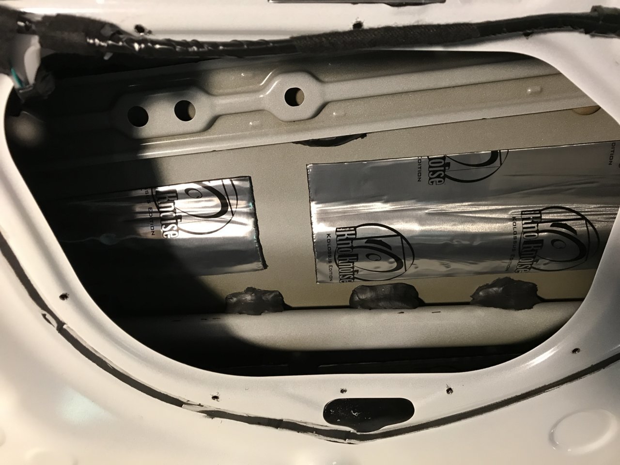

    Surface prep is key, I used acetone to cut through the wax like material they spray in the doors. Went with Kno knoise kolossus, 100mil thick, for the most mass pe sq ft. It takes much less to do the job, since it's heavier. 39 sqft was enough for the entire truck, even overhead. Second skin butyl rubber rope works GREAT in the doors to tame the rattles from the added structure support (see picture). Take your time and only apply sound deadening where needed. Tap the panel first and feel. You are looking to deaden anything that rattles or makes a higher frequency sound. Have fun and wear cutting resistance gloves.
    I agree with Fattypack, Tessa tape is a must around lose wires!
    I went a bit overboard and installed 100sqft (entire truck) of MLV (1lb / sqft) and glued closed cell foam on the back side. Makes a huge difference but lots of work.
