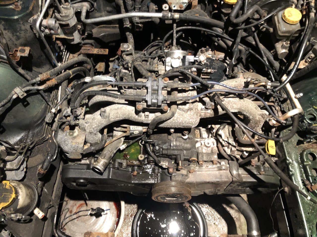

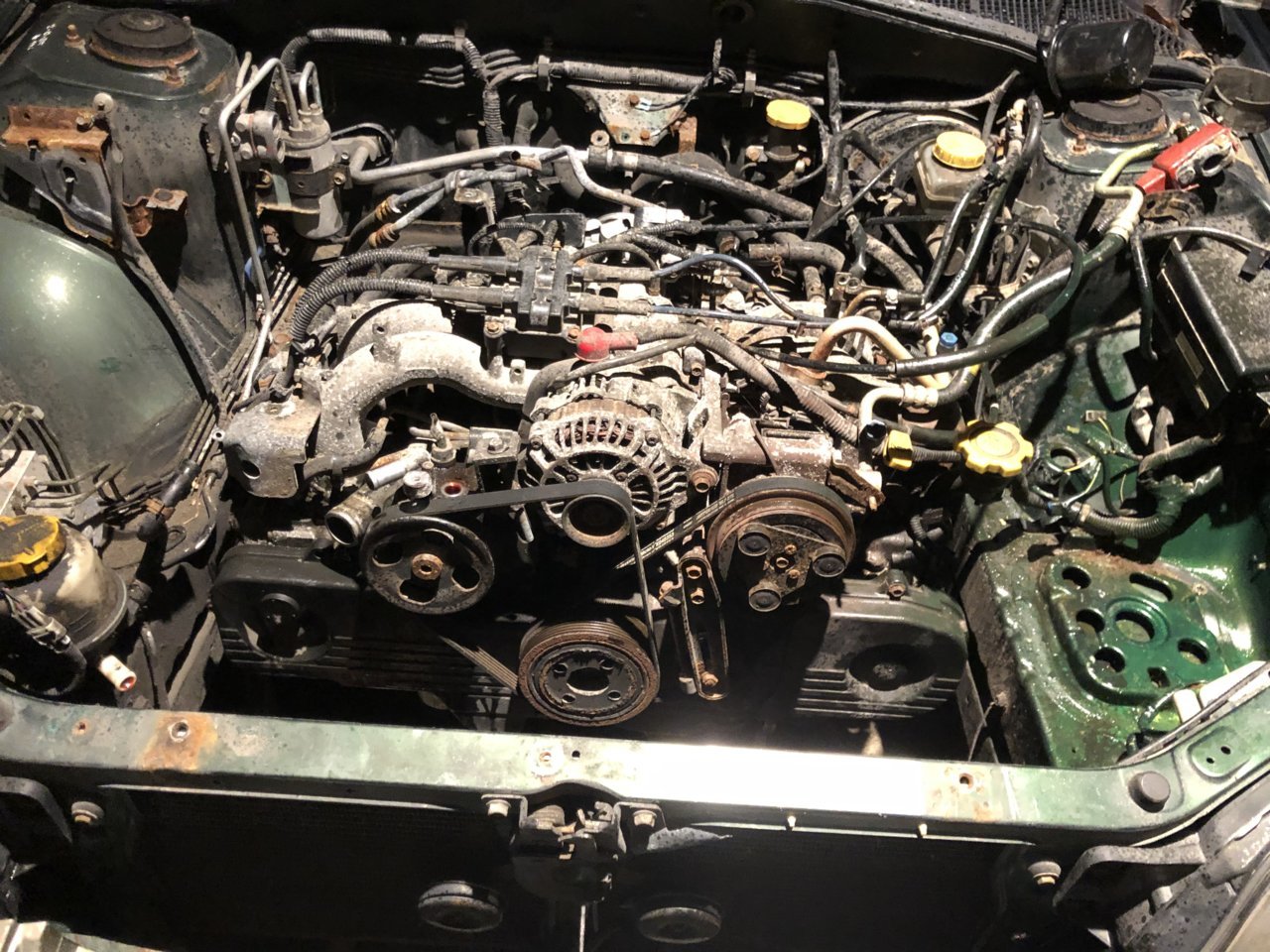

    Never done a taco, but I have done some heart surgery on a Subaru Outback. TAKE LOTS OF PICTURES as you go. Really helps for figuring out all the annoying bits when putting the whole thing back together.
