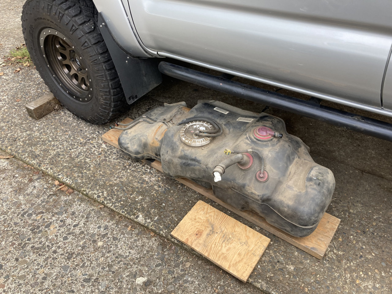

    Shouldn't need to drop the tank all the way, just a few inches to gain enough room the maneuver the line through the frame. Support the tank with a hydraulic jack, which will give you precise height control.
  10. Oct 7, 2021 at 8:23 PM
    Bishop84
    Bishop84 Well-Known Member
    Dec 17, 2015
    #172494
    11,673
    I can tell you its miserable even with a bare frame. They ship the lines pre-bent, then they bend it again. Takes a lot of patience to get them looking oem factory.
    Good job getting this done. For others, definitely drop the tank a bit. You can support it with ratchet straps.

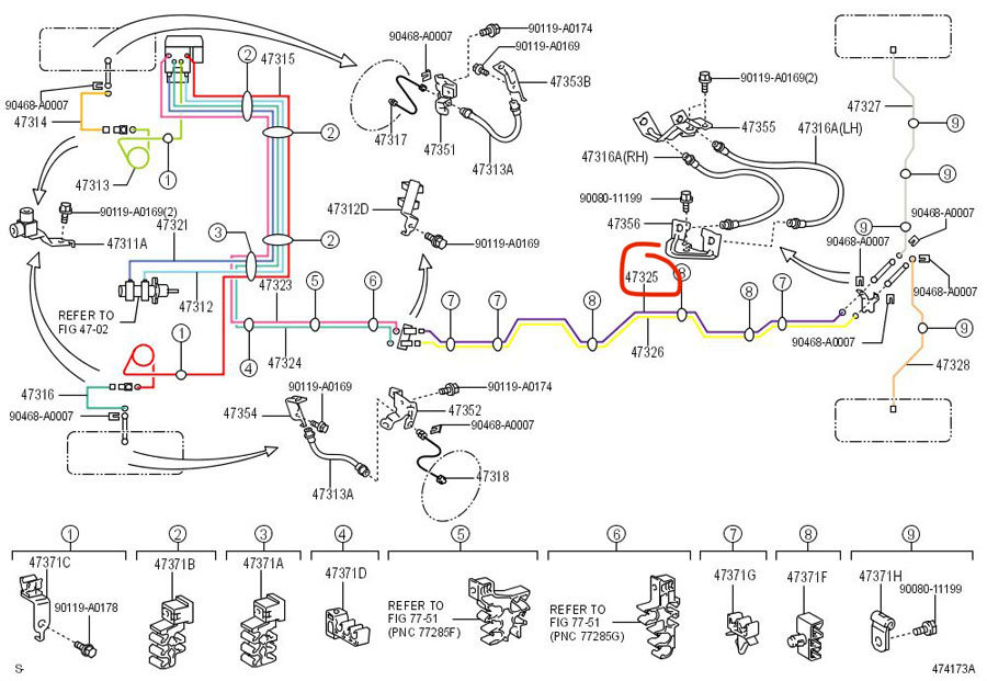

    Maneuvering those pre bent lines is a nightmare. I’m replacing 47325. Definitely gonna have to do some clean up bending once it’s in place!

    oh yeah I know it’s totally bendable and not worried about it. It’s more that I already got the pre-bent line from toyota and it is an interesting exercise snaking it down the frame rail.

    Dropped the tank today and got the new brake lines in. Even with the tank out it was a massive pain in the ass to snake the pre-bent hard line though the frame. If I were to do it again I’d just get bulk straight line and a flaring tool. It would’ve been way easier to route through the frame and then bend since I had to re-bend everything once it was routed anyway.
    I don’t see how this would have been remotely possible without dropping the tank.
    Dropping the tank wasn’t nearly as bad as people make it sound but it wasn’t very fun. The hose and wire harness on top are a pain to get off. It took about 1.5 hrs to get it out but only 15 mins to get it back in.
