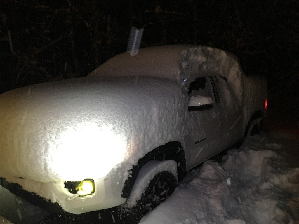

    Welcome to Ohio. I live in the snow belt of NE Ohio. You will want to get some weight in the bed of the truck. Home Depot sells the cheap 60 lb. bags of sand (Quikrete Tube Sand). I run two bags, but three may be even better. Driving in snow isn't too bad. Take it easy, brake early, easy on the throttle, and drive by feel. Avoid the soft shoulders of the road. The slush that builds up on the shoulder as the road thaws from the salt can pull you in if your not careful. Keep your windshield washer fluid topped off - the salt spray kicked up on the highway tends to smear and stick to the windshield. If you start to lose control of your vehicle or feel a slide - don't panic and over correct. I recommend going to a parking lot after some fresh snow and try messing around and seeing how the extreme steering inputs affect the truck.
    Fluid Film is a must to combat rust from all the salt we have here. I ordered a kit from Amazon that comes with the bottom feed sprayer, gallon of Film, applicator/brush can, and an aerosol can of Film.
    Decent all season tires are good, but dedicated snows are better. When I wear out my factor Wranglers I am going to go to a AT tire with a winter rating.
    Ask questions, there are plenty of things that I probably have left out and take for granted. Here is a motivational photo of what you are coming to (photo taken today):

    :eek:. Holy crap!!! I'm am really excited but at the same time like wtf am I doing. Lol. Thanks for the advice.... Dear God that's alot of snow
