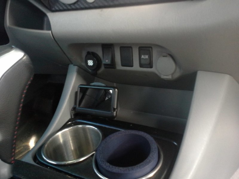

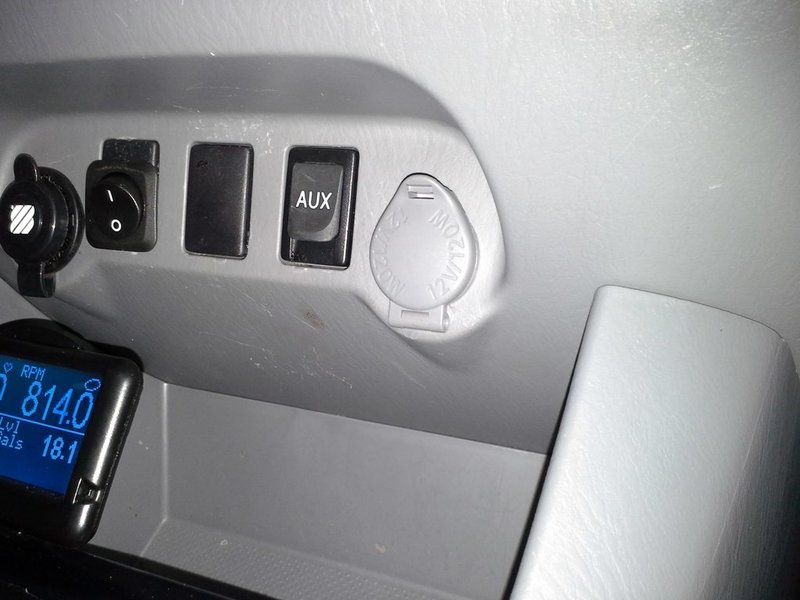

    A few
    Wish I seen that ebay one. Looks good . I added one I picked up from west marine. Dual usb hooked up with add a fuse to always hot fuse. Only reason for switch is because charger has a led lite that would always be on. Put in place of lighter with slight trimming. Replaced switch with better fitting one after this pic.
