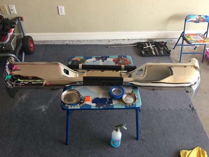

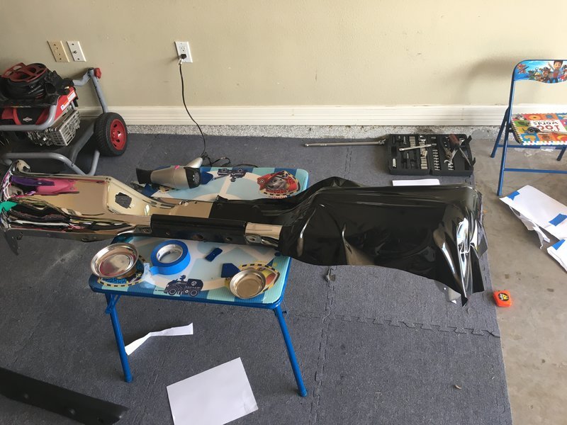

    This took about 30 min since I was working by myself.

    3) Next was getting ready for the installation. I had windex, blue masking tape, a fresh razor blade, a heat gun(in my case it was my wife's blow dryer and something that acts as a squeegee. *Tip have a felt tip squeegee ready for you to use. I used a silicon squeegee and it left some minor scratches when using. *Tip have multiple razor blades and be ready to switch often, you always want a sharp edge to cut.
    4) Next its time to start putting vinyl to chrome. I did mine in 2 pieces with the joint being hidden behind the license plate. *Tip cut excess in length and width to allow you to wrap around the edges. *Tip use the heat gun in the curves. Heat vinyl evenly over a large surface area and allow the heat to dictate the direction of the vinyl.
    5) Next work from the inside outward making sure to get all the air bubbles you can out. *Tip always squeegee towards an edge to allow for air release. *Tip take your time, know that the results will be worth the time an effort.

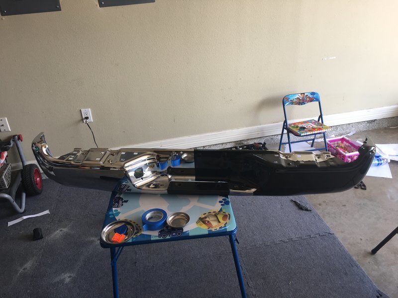

    (Picture below shows 1 side down)
    6) Next you get to repeat the same procedure all over again! How fun I know lol *Tip this may be the time you tell yourself "its not that bad I can do my whole truck!" DO NOT get careless. You are working with limited material and you cant afford a mistake. *Tip if you have not switched blades, do so now.

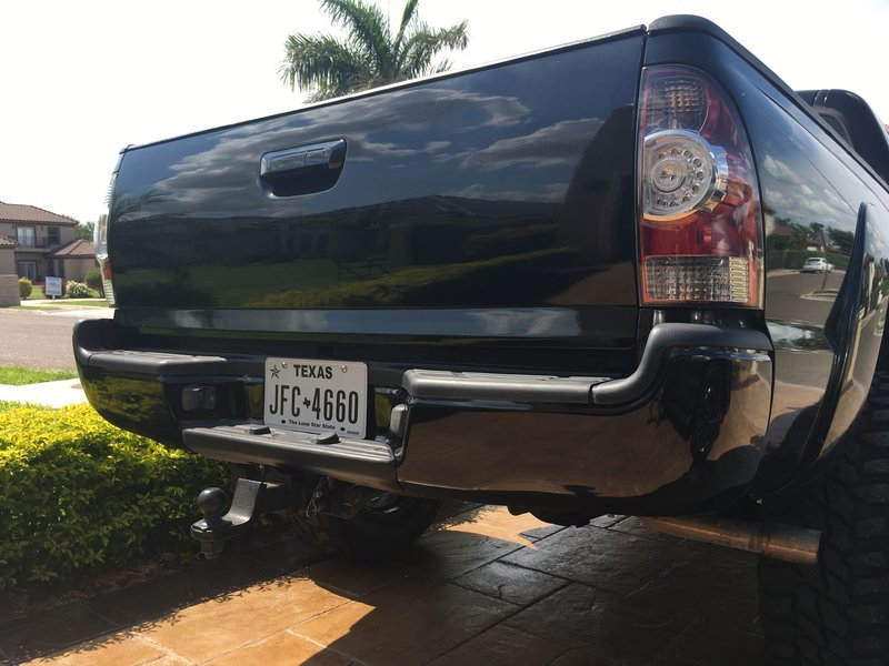

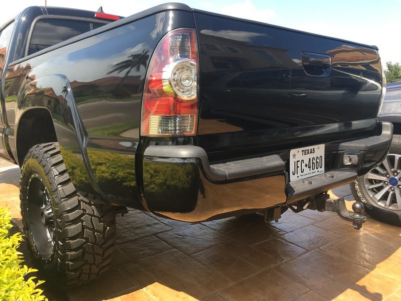

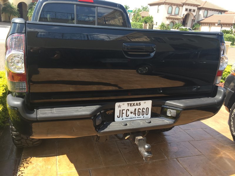

    Pictures of the final product. No more chrome!

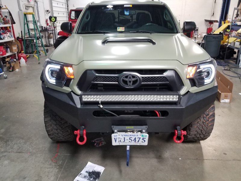

    My whole truck is wrapped, but here is the grill. We didn't need to do any inlays, but I recommend pre-streching the film and then heating it back up to relax it prior to sticking it down on the sharp bends. Make sure to heat the area afterwards prior to trimming the edges - film tends to shrink a bit the first few days in the sun. Heating after installation will help prevent this

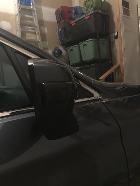

    Not really! I've done a couple smaller things, but nothing this large. Worst thing I've done was a tint overlay on my mirror blinkers. That was a PITA.
