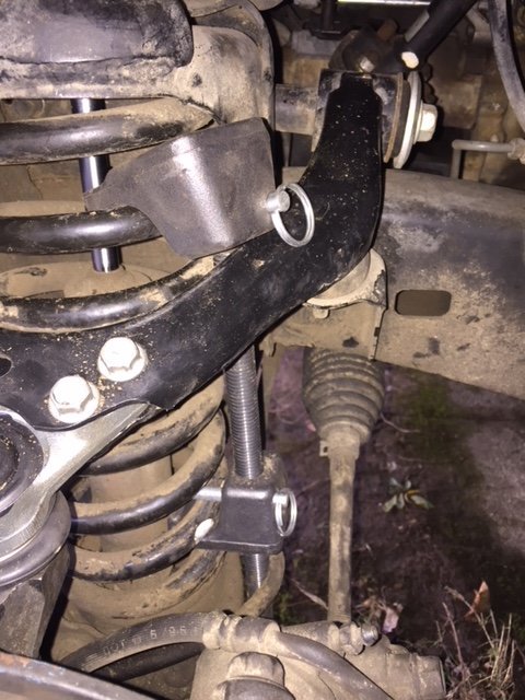

    • Spring compressor doesn't fit: Though the Haynes manual doesn't call for it, I thought compressing the springs would allow me to work safely and take stress off the control arms. Unfortunately, the spring compressor I rented wouldn't fit around the coils no matter where I tried to position it. The control arms were always in the way. I ended up using the floor jack to keep the lower control arm in place per Haynes recommendation, but didn't like that there was no failsafe working so closely to the spring. In the future, how would I get a compressor around a tight coil like this (photo attached)? What would I do if I ever needed to replace the coil?

    I don't think compressing your spring takes any strain off anything in this case (only need to do that to change your shocks which would be when they are removed from your truck). When you broke the lower ball joint free what is pushing your lower control arm down is the shock absorber.
    And of course I was replacing my shocks so they were off the truck. But I figured out on the second one it was much easier to remove the "heads" from the threaded rod so I could tilt them and get them inserted into the coil (one high and one low) then line them up and run the threaded rod through.
    I took the shock and coil out, then replaced the lower ball joint, then swapped in the new shocks (using spring compressor) then put the assembled shock/spring back in using the vehicle jack upside down on top of the uca to the "ceiling" of the wheel well to push the uca/lca down to easily insert the bottom bolt on the shock.
