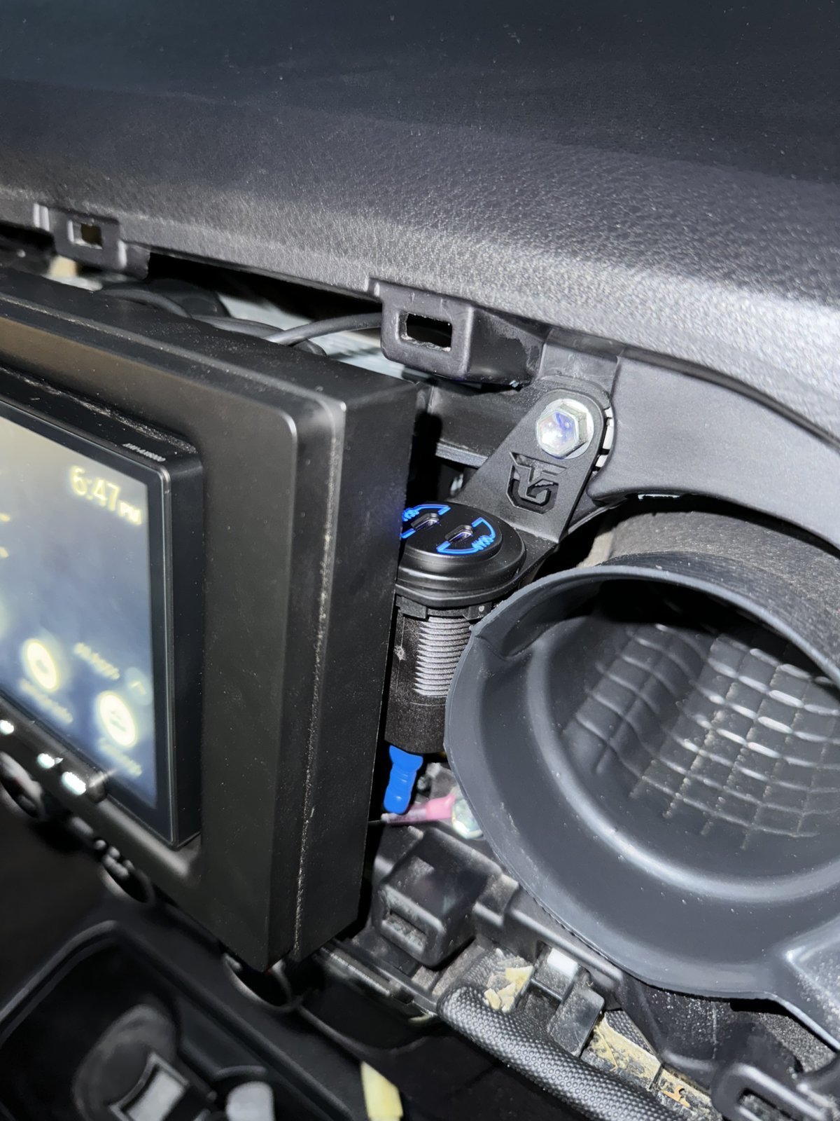

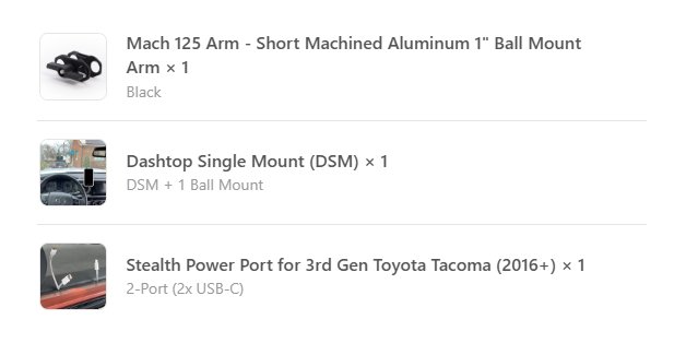

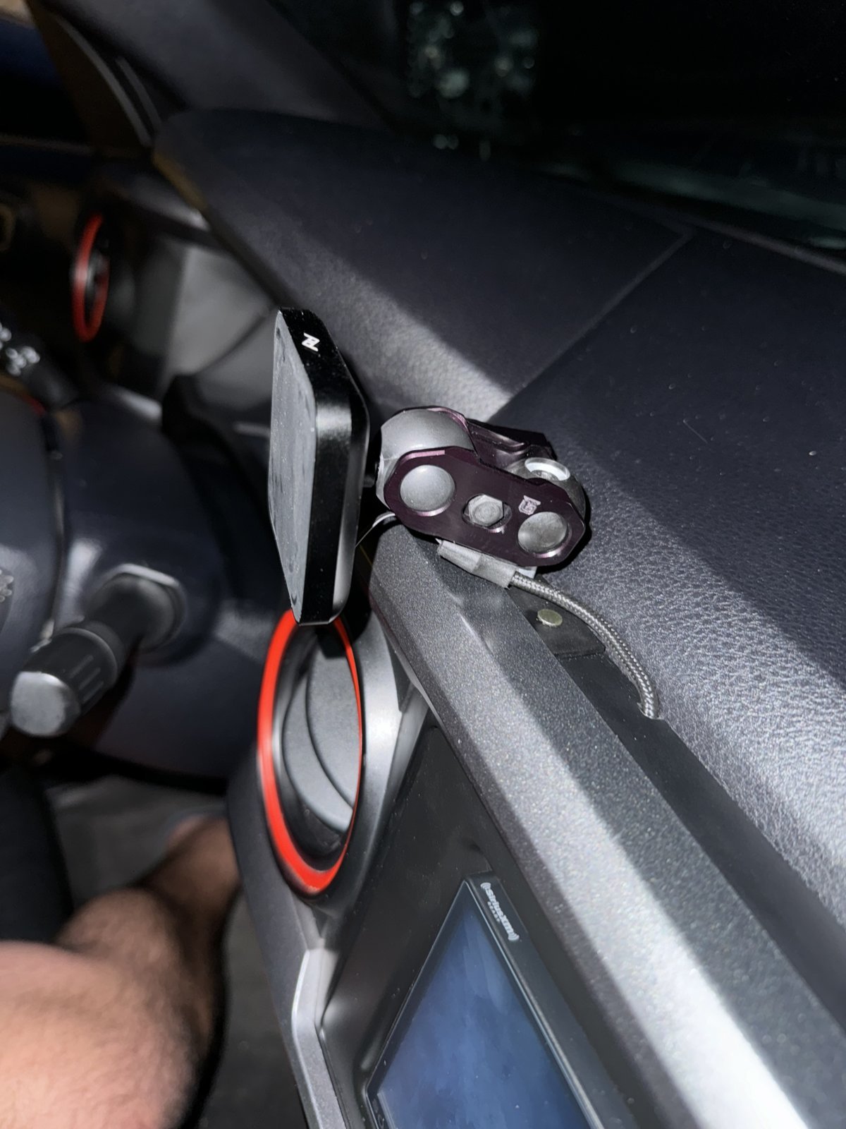

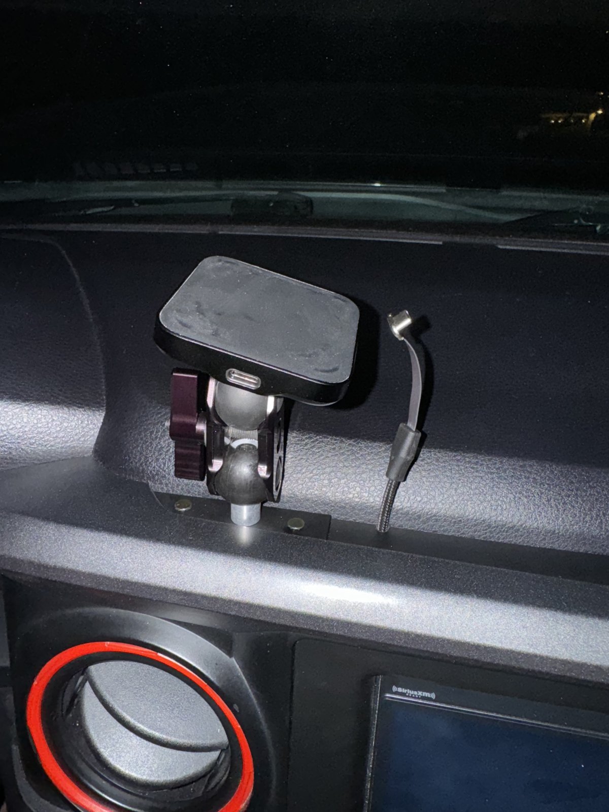

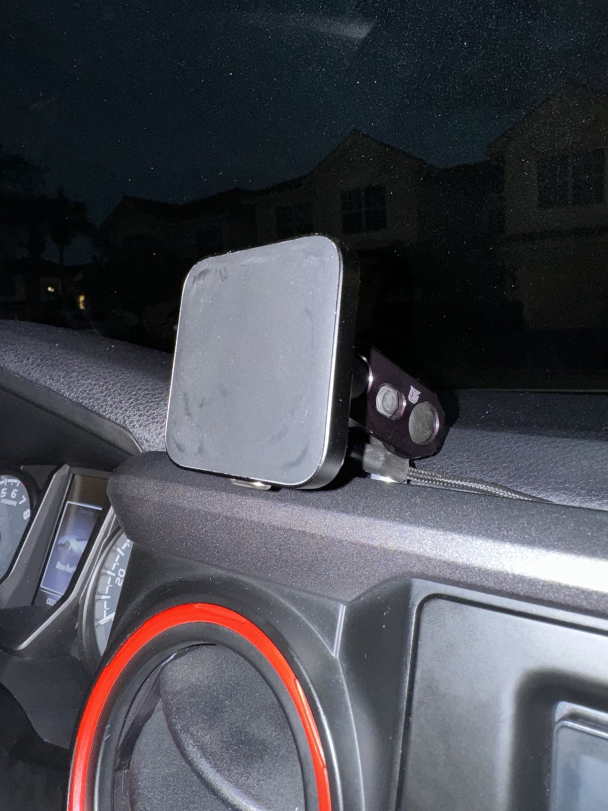

    1. Taco Garage's Dash Mount Hidden Plate (Single or Multi-mount)
    2. TG's 1" Ball
    3. TG's Aluminum Mounting Arm
    4. TG's Stealth Charger for USB-C (includes mount)
    5. Peak Design's Magsafe Charger/Mount Combo (1" ball included)
    6. Generic Amazon Flat + 90 degree USB-C Cable
    All in cost: $200
    ($85 of this is the Peak Design charger, which is definitely one of the pricier options out there compared to alternatives, but you can tell right away it is a high quality product)
    I wanted the same things it sounds like you may be after: wireless Magsafe charging, minimal visible cables, minimal driving obstruction, minimal "arms" holding the phone, and most of all, easy and quicker than anything else to mount to when getting in/out of the truck.
    I landed on the following and to me, is the cleanest all-in-one solution I could possibly put together and could not be happier. It holds my iPhone 15 Pro perfectly fine even on forest trails and rough terrain with very little visible vibration. Yes, I am using a Magsafe phone case too, and it works identically in terms of holding strength with or without the case as far as I can tell.
    Also worth mentioning, it is very easy to position your phone in a spot here that does NOT block your AC vent NOR does it block any of your road view whatsoever.
