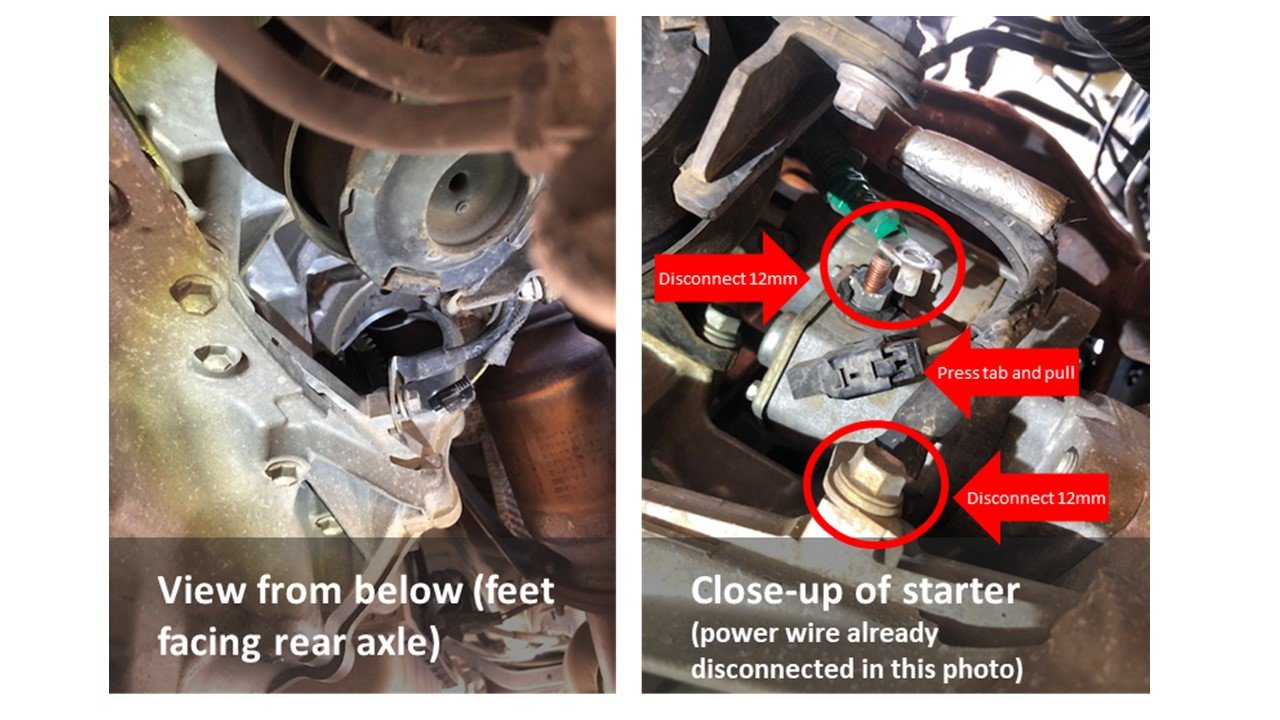

    After disconnecting the battery, I disconnected the electrical wire to the starter and the ground wire below it using a 12mm socket. Other tutorials listed the bolt on the starter as a 13mm, but mine was 12mm. Disconnect the other electrical wire by pressing down the tab and pulling it out.

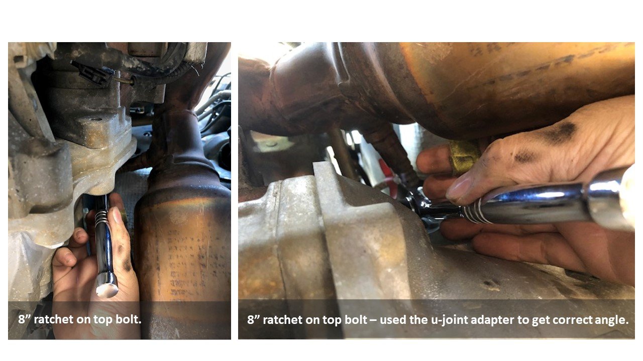

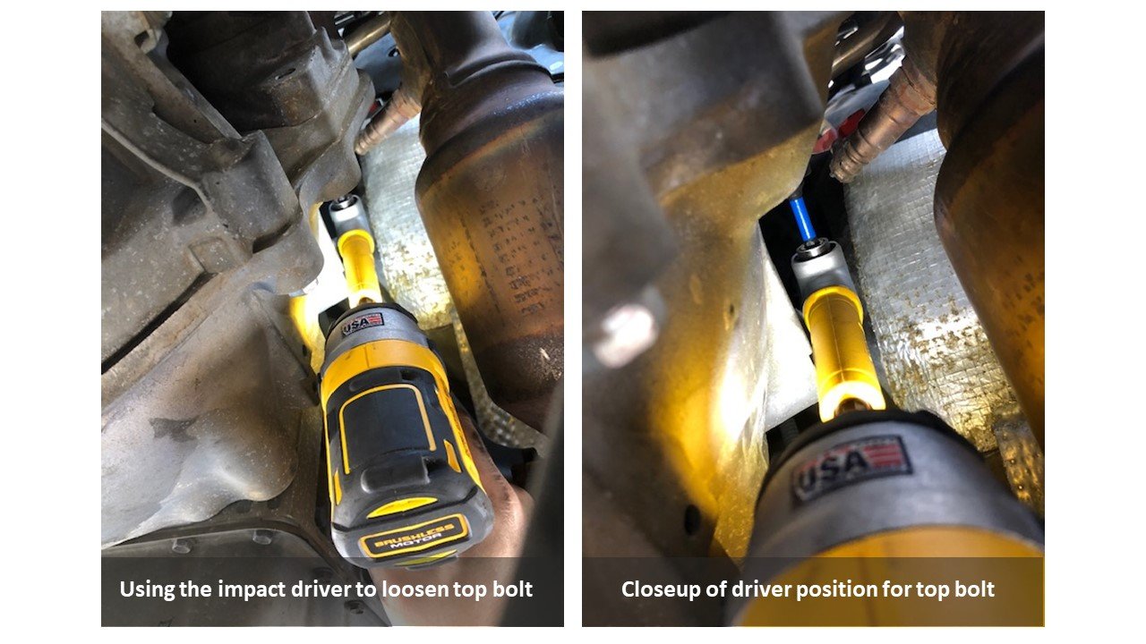

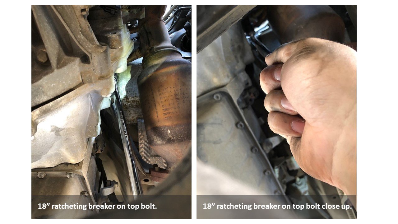

    There are 2 14mm bolts holding the starter in place. I was fortunate to have no rust on either bolt, which made removal easier. Removing the bottom bolt was straightforward enough - I used my impact driver to loosen it, then finished up with the 18" breaker.
    I repeated the steps for the top bolt, which is out of view. When feeling for the bolt, I ran my finger along the slope of the starter housing to help locate the bolt. There are 2 bolts in that general area around the top bolt - the bottom one of the two is the one you want to remove.
    Here's a view of how the impact driver fits accessing the top bolt.
    And here's how the 18" breaker fits - using a ratcheting breaker was great, as I was really only able to ratchet a few clicks at a time (got mine from Harbor Freight).
    Then, I was able to finish up with a regular-sized ratchet with a U-adapter attached.

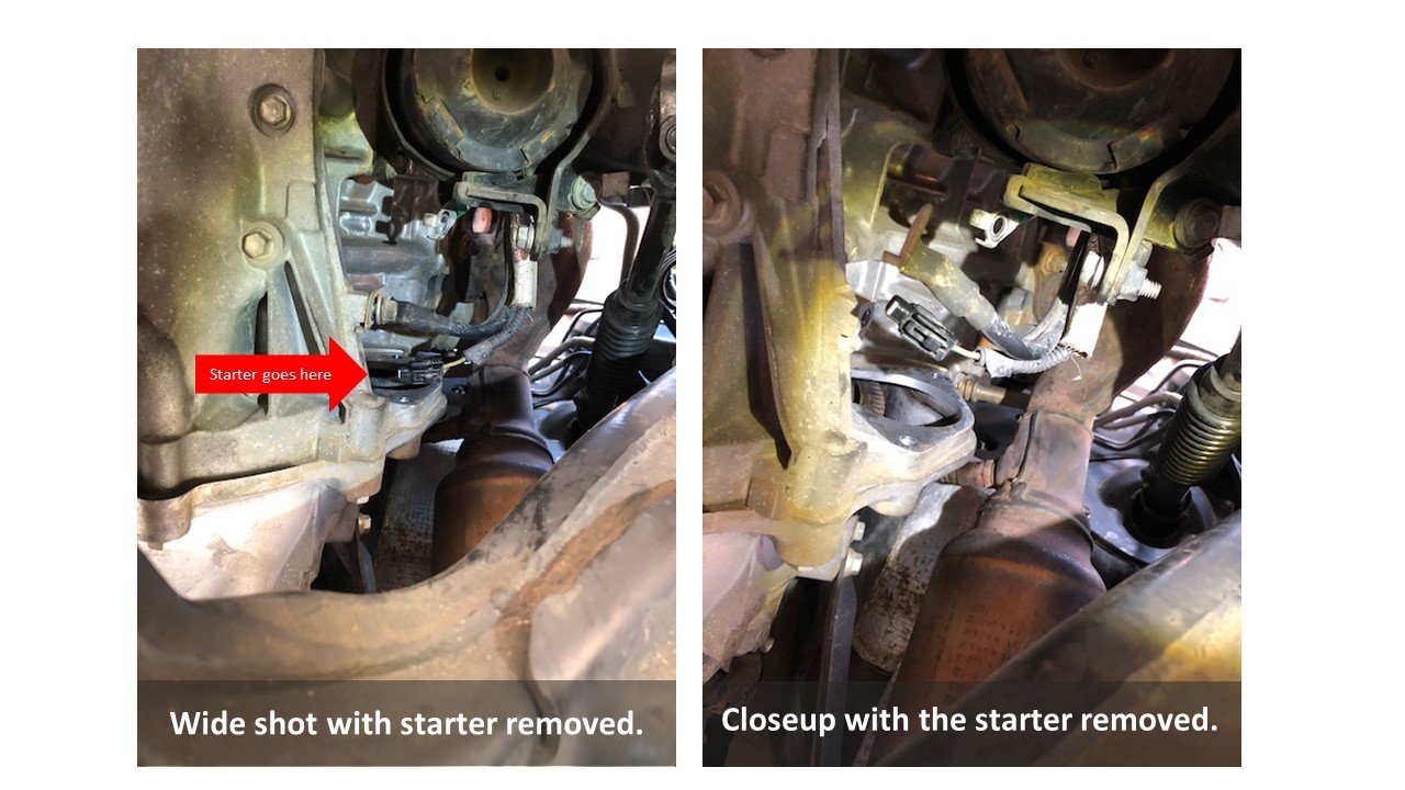

    And just for reference, here's what the area looks like with starter removed:
    It was tricky getting the starter back in place - I found that utilizing the empty space above the starter helped the most. I was able to push it up back end first as far as it would go, then drop it down into position.
