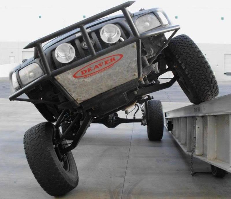

    OH THE HUMANITY!!!! A BODY LIFT!!!
    Sorry but the anti body lift thing always makes me laugh. How many of you got in wrecks and had your cabs fly off the frame rail cause of your body lift? How many of you had your body lifts punch thru the floor? Not your friends cousins uncle and that one picture online that everyone has seen yet nobody knows the back story of... I'm talking you?
    Just curious... Cause if I had a nice new expensive ride, I'd be doing a body lift WAY before I did a fabtech, rancho, pro comp type lift!!! 100% hands down without a doubt I'd do a body lift over one of those! Now a bolt in coilover or spacer... ehhh, I'd probably lean that way over a body lift but no way in hell would I put a drop bracket kit on a truck before a body lift. If you really really really think the guys at rancho, fabtech or those types are remotely engineering their suspension lifts to the extent OE does, you're high. A body lift keeps all that nice extensively engineered working suspension and leaves it alone. Now the spacer lifts, ehhh, I won't say those are trash but I certainly wouldn't be bragging about my awesome coil spacer lift either. A bolt in coilover is simply valved more agressive, isn't messing with the suspension system either, it's just valved most specific to what you're wanting to do rather then mom going to church, all you're doing is enhancing the suspension tuning to more of what you want out of it and the little bit of lift is just pushing the limits of what the suspension was designed to do, it's not changing a whole lot.
    My point of view comes from a resume that includes R&D titles at many of the main stream drop bracket suspension companies and probably the #1 body lift company in the nation. I'm out of that industry altogether now so I've got no problem letting you know my opinion as it can't come back to bite me anymore. LOL
    That truck pictured above... 3" body lift, you can see the core support puck just to the right of the skid plate. Along with that 3" body lift I'm pulling 17" of travel up front and 24" in the rear... But OMG!!! There's a body lift on it!!!!!! We're all gonna die!!!!
    BTW, the body lift company I used to work for, NEVER ONCE got feed back of a cab separating from a frame!!! They've been in existance for A LONG time and trust me, if it had happened there'd be a lawsuit. On the other hand, I personally went and inspected quite a few trucks that had been in wrecks with our body lifts and we were named in the lawsuit along with every other product or person to have touched the truck. I never ever once saw a failed body lift, that includes head ons!!! I would view the truck, point out what products were ours to the law teams/officials and then we'd be dismissed from the lawsuit cause it would be obvious that our product did not fail during the wreck and wasn't the cause the accident/injury.
    So go on with your body lifts suck rants but if you really think a fabtech type lift on your nice expensive new truck is a better choice... You're high!!! LOL If you knew what straight edge and plumb bob type engineering went into those you'd be pissed you threw away your factory suspension.
