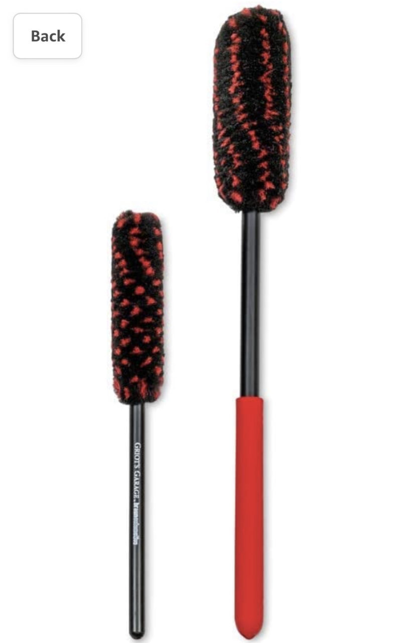

    Wheel Woolies are a good choice when cleaning the wheels barrels, and spoke brushes where in tighter areas.
    Your hand can contour into any part of the wheels that a brush may not get into.

    I’m late to this thread but I have the 2020 PRO wheels. I use Griot’s 3-finger detail mitts for 80% of the wheel. They’re great for these wheels. I also like Griot’s (or similar) wheel woolies when helpful and I finish off with a general pass over with my wash mitt. I wash often enough that car wash soap is all I need. I clean the inside barrels when I rotate once a year.
