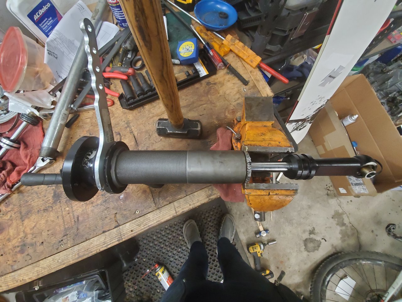

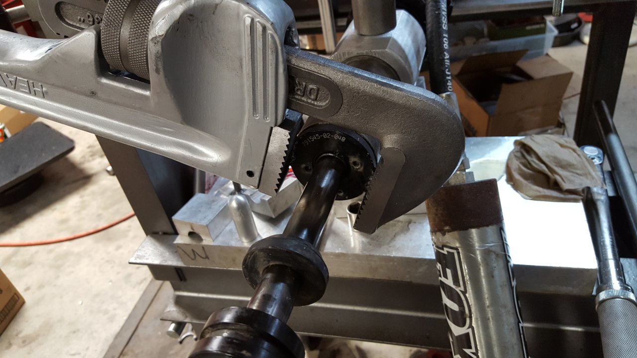

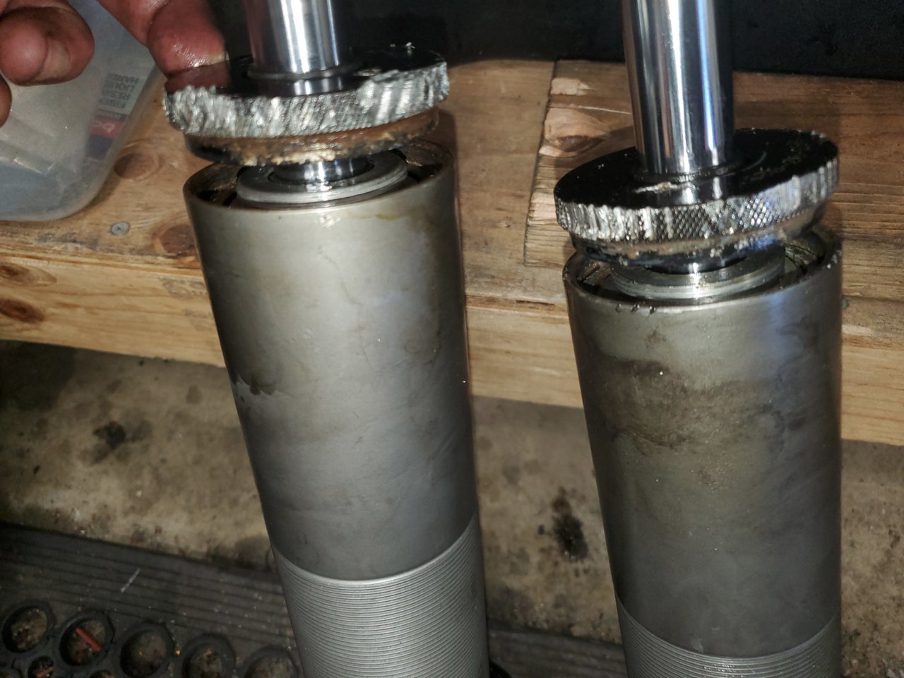

    Working on my friends 2.5 Fox Coilovers and the bearing wiper cap will not come off on both front coilovers. I've removed the threaded allen set screw from both caps. Steps I've taken so far are below with the shock mounted in a bench vise.
    1. Made a large spanner wrench with 3/16 pins, tried to tap with a deadblow to shock it and get it moving.
    2. Used a monkey wrench on the knurled outer surface of the cap. No dice, it won't move.
    3. Sprayed PB, and tried to get it down into the threads for the cap, left it over night
    4. Used some heat to try and expand the body a bit, don't want to go crazy
    5. All of the above
    Still nothing, any tips/trick that folks have had luck with? When I serviced my Icons those caps came off with a light hit of a deadblow on a small 3/16 spanner made for bicycles. At this point the cap is ruined from the monkey wrench, which are easy enough to replace, but still can't get the damn thing off.

    Get or make some 2.5 body clamps to hold the cylinder and keep at it with the pipe wrench. Try to not damage the body and or it's coatings with the pipe wrench.
    The galvanic corrosion between the steel body and aluminum bearing cap/seal head is usually the cause.

    Thanks, I ended up getting them. I didn't have any shock body clamps, next purchase, but I clamped the wiper cap in the vise and used the preload ring locked down with the spanner to spin the shock body after shock loading it with a sledge. I can't believe how much force it took to free the cap.
    BTW, will the same size shock body clamps work for Icons and Fox? I see that King makes some that are 2.0 inches id will these work for both Fox 2.0s and Icon 2.0s? Then they make two versions for 2.5 shocks 2.49 inches id, and 2.562 inches id, will one of these work for Fox 2.5s and Icon 2.5s? Just don't want to purchase the wrong size.

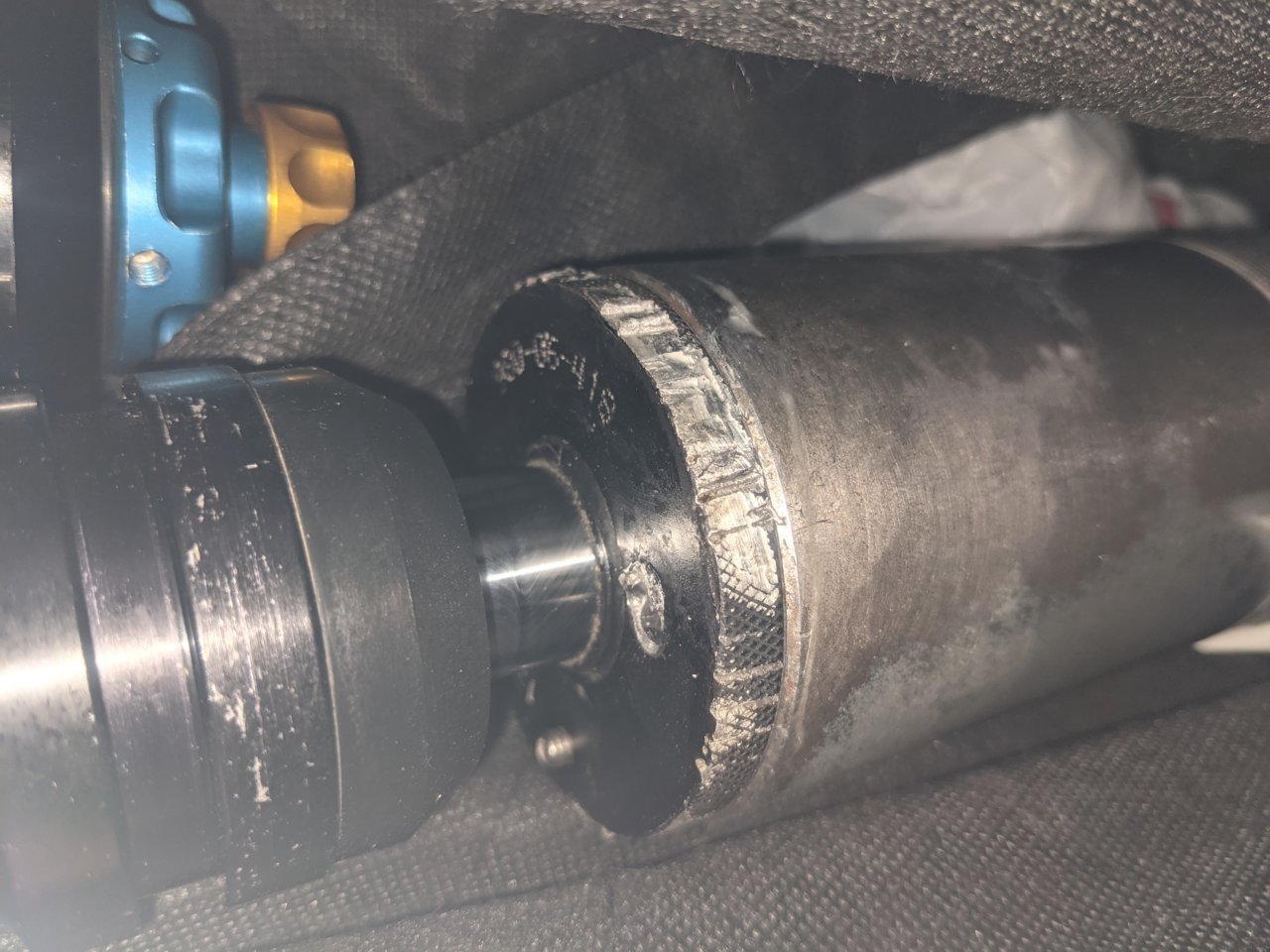

    Wiper cap stuck. Broke my spanner wrench when I was trying to break the threads free.. it buggered the pin holes on the cap at the same time... I tried heating it up with some map gas and using a pipe wrench to get them free.. still no dice. Currently just soaking them in penetrating fluid. I realized that while heating the assembly, that the aluminum was probably swelling more than the steel body. That's why I was thinking I could got at it with some dry ice in hopes the aluminum cap will shrink more than the steel body

    Here's a peek at my shit show

    Welcome to the suck! The cap getting stuck from heating it isn't a problem. The corrosion between the threads and body to wiper cap is what's keeping it from unthreading.
