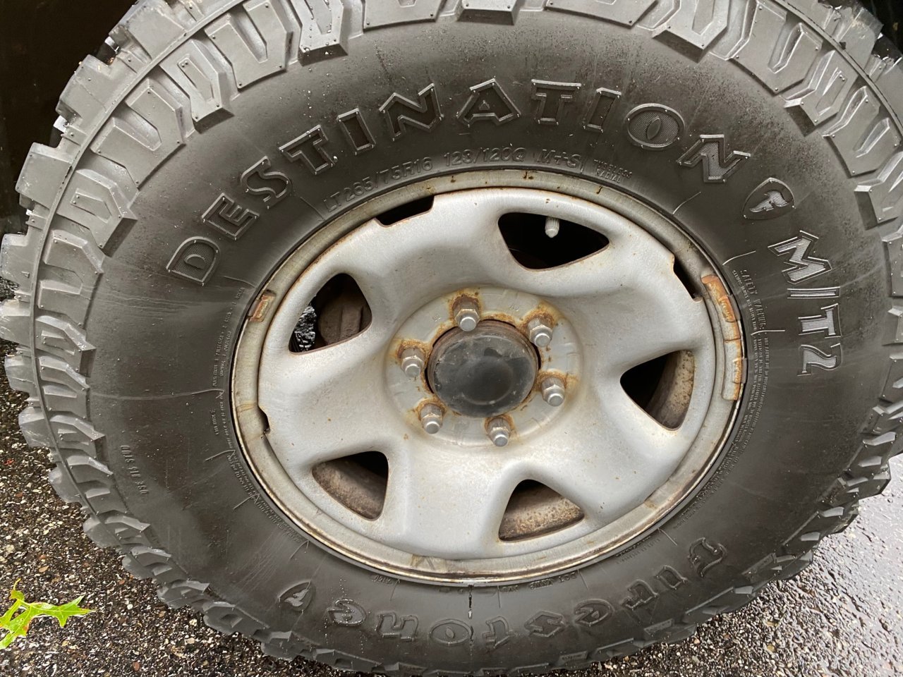

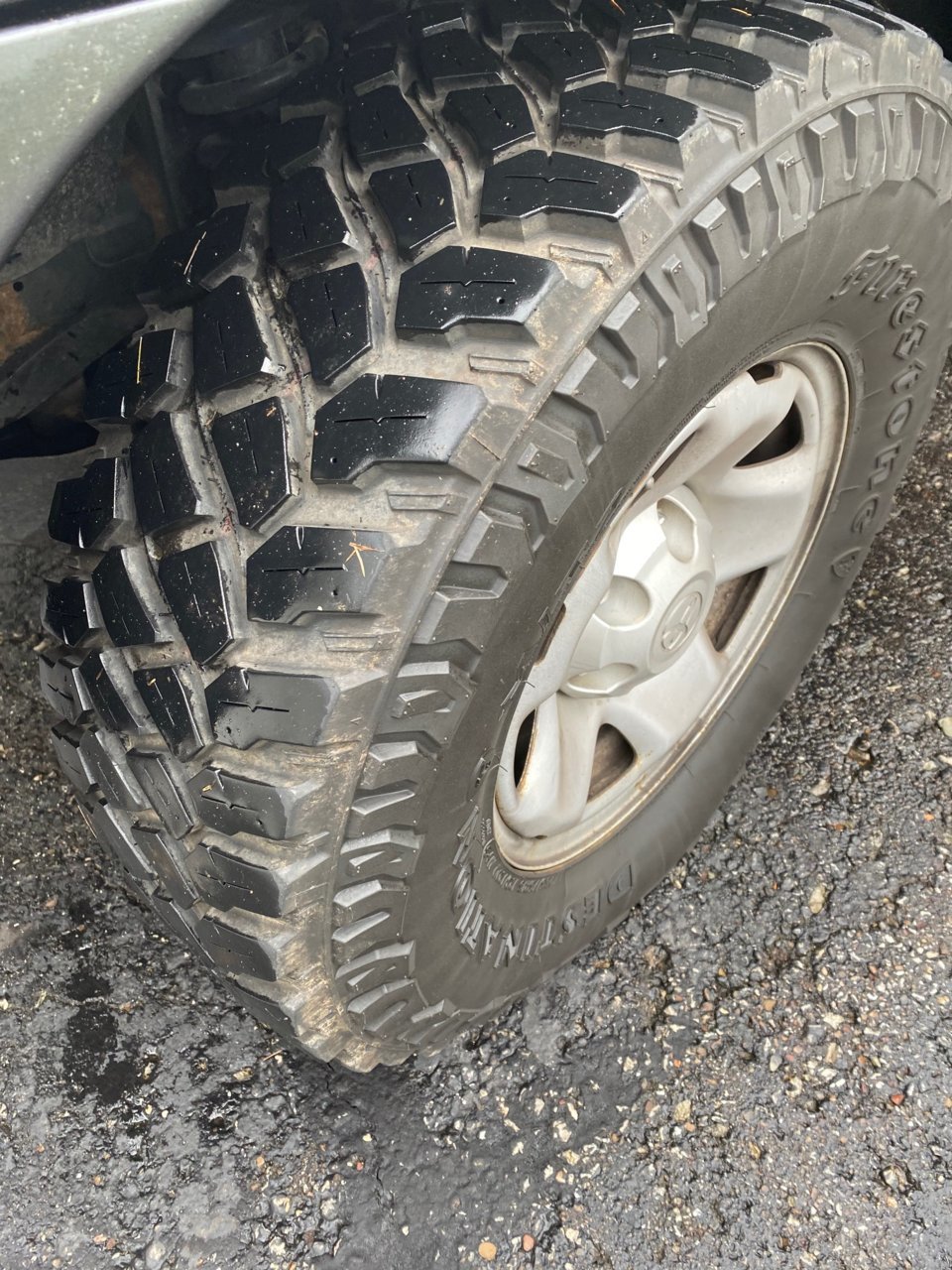

    Friends, looking for some advice on my tires. Some quick background. Two weeks ago I purchased my 2015 TT AC, 4WD V6. The truck has 265/75/16 tires on it. Although the more standard OEM tire is 265/70/16 I did some research and these tires can be used on the truck. The tires are pictured here and are Destination M/T2 off road tires. Here is my challenge. I was excited about these big knobby tires because I live in NE Ohio where we get a ton of snow. However, we've had a bit of rain lately and the ground has been mildly wet. I've noticed when I make some turns (and mind you not wild ones), the back end has fishtailed a bit. This concerns me because now I am thinking these might NOT be great in the snow. Are any of you familiar with this tire or off road tires enough to know if these are going to be bad in the snow? Should I swap these out for All Season tires?

    You want sipes in wet/snowy conditions.

    You would be interested in anything with the snowflake symbol... which is going to be a tire with siping on the tread blocks. If you want an aggressive tire that has the winter rating look no farther than the Duratracs. There are some haters on them, and they do have a flimsy sidewall compared to others (a benefit for me as I don’t wheel anywhere rocky and the thinner sidewalls ride nicer and are lighter) Others have complained about the wet performance of them... but I haven’t had that experience. Ran my first set for 100k and sold them when they came off! Foolishly replaced them with BFG all terrain K03’s and hated them... pulled them off at 60k and put another set of Dura’s on. Best all around tire I’ve run, great grip @ 33psi

    That is not a 2015 factory wheel. It doesn't matter and more than likely the previous owner kept his wheels and tires and stuck those on there to trade it in. I'm sure you will upgrade them anyway after you pay off them tires. Its what we do... :)

    Another option is dedicated winter tires with studs for the winter and save those for summer .
    If you are allowed to use studs in Ohio , I beleive it gives you another 3 years of use out of a winter tire than simply running without studs

    I know in AK they recommend tires that have the 'mountain peak' symbol on them which is rated for cold weather as well as snowy conditions. Not sure how well they work during the summer but I can't image them being bad. Certain all season tires aren't rated for colder temperatures and the rubber will actual harden up. Comparable to leaving a cheap extention cord outside during cold weather.
    Just a bit more info for you hope it helps. I am a believer in having good and proper tires for the type of driving you might encounter. Might help you out of a jam at some point

    That is a mud tire. They don't usually perform well on wet pavement or icy conditions. They do pretty well in deep soft snow, but once it ices over they are not the best option.

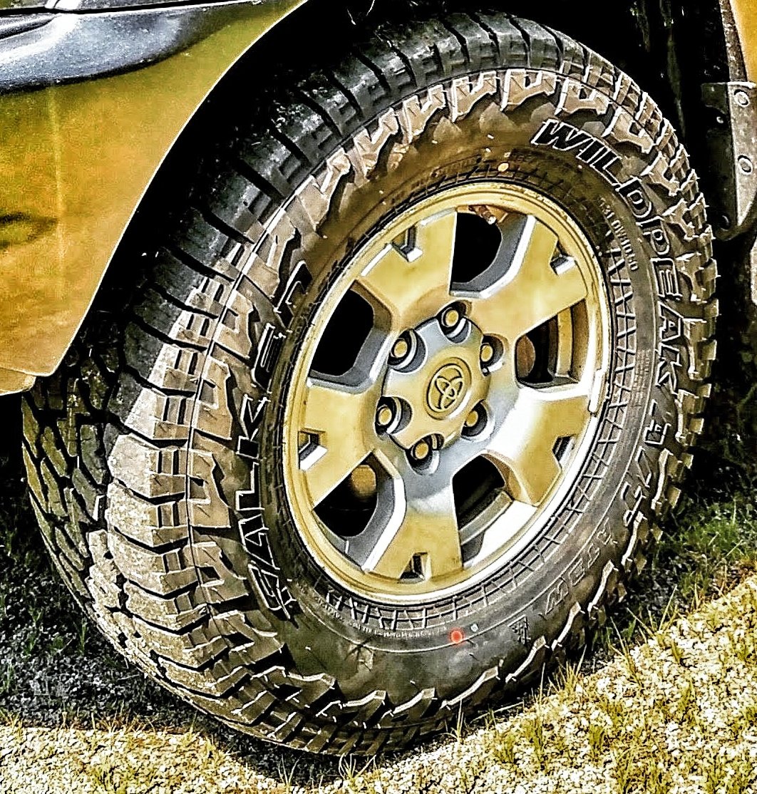

    I have Falken Wildpeaks AT3W on my 13 TRD OR DC and live in Northeast VT 15 miles from Canadian border. Love the tires and yes they have the 3 peak mountain symbol for severe snow. I tow a lot in Winter to snowmobile in Northern NH & Maine with no problems. Before I retired, I drove a lot more and would run dedicated Winter Tires for commuting. The Falkens have been great all year round.
