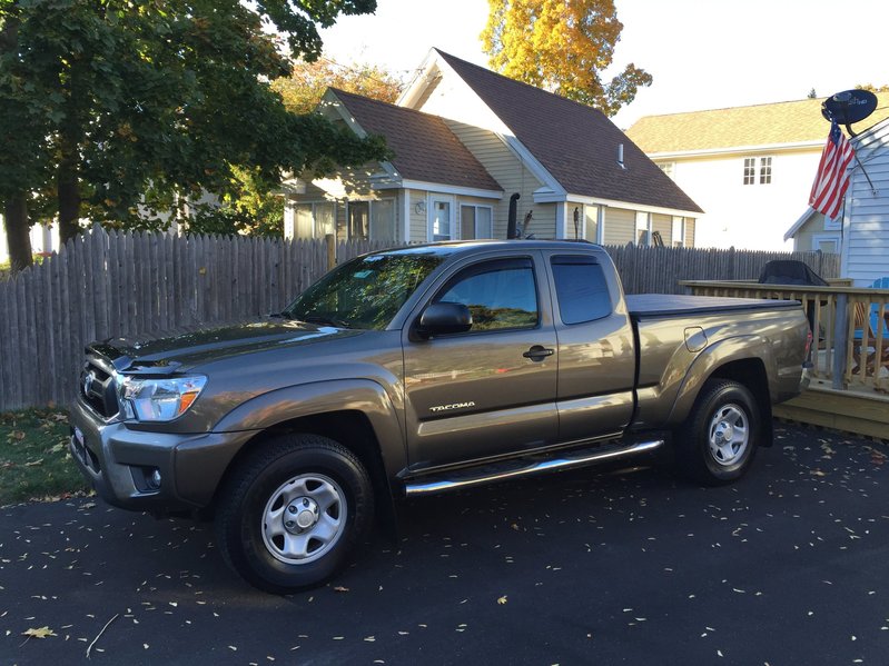

    Is that stock suspension?

    Bextreme

    Yes, all stock except for the wheels and tires. I am not going to lift it until after warranty is up.

    What was your reason for going 70 instead of 75's? Just curious.

    That was the size of the stock tires test came on it, so I went with that
