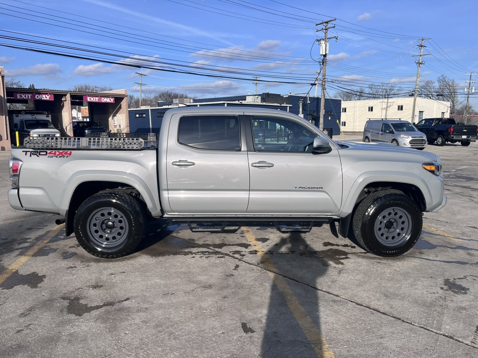

    17” Nomad Convoy Utility Grey. BF Goodrich Trail Terrains 265/70/17.
    No rub, stock suspension. But I don’t take her off road with the exception of some fire roads. I’ve had this set up for about six months. Lost a couple of MPG’s, but Love the set up and the tires ride nice.

    17 x 8.5, 0 offset. But I have seen on here where people have had issues with rubbing And they removed the factory mud flaps. ( not with my exact setup) .
    Maybe I don’t have rubbbing because ( and this is just a guess ). The Trail Terrain treads are “tapered” a bit as compared to other all terrain tires that seem more squared off.
