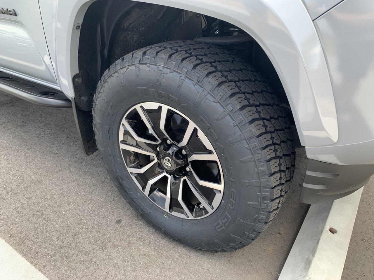

    I went up to 265/70 17 Nitto Terra Grapplers. The stock tires were 265/65 17. No rub at full lock or any bumps so far. I still have my oem mud guards and air dam as well.

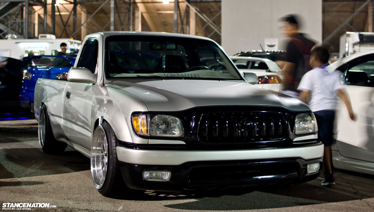

    Something like this?

    Negative
