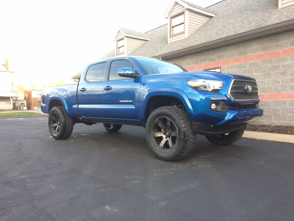

  15. Dec 19, 2015 at 2:49 PM
    #35
    AUEast
    AUEast Well-Known Member
    Dec 1, 2015
    #171155
    86
    Nic
    2016 Silver Tacoma TRD Sport
    Wrangler duratrac 265/70 17

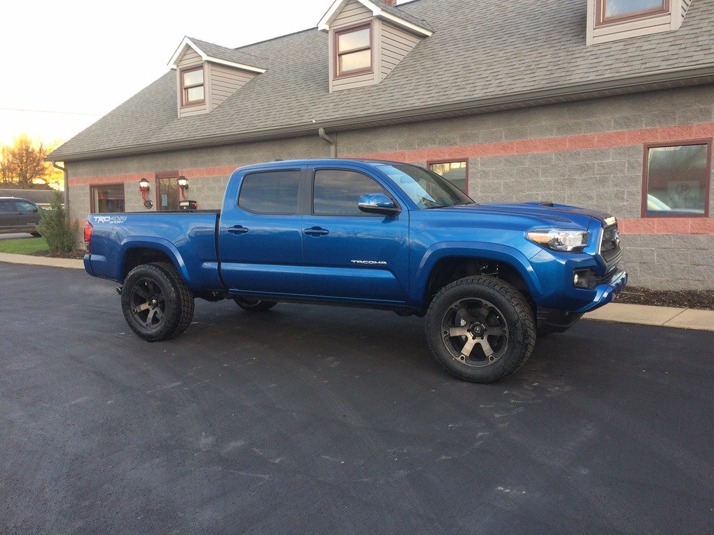

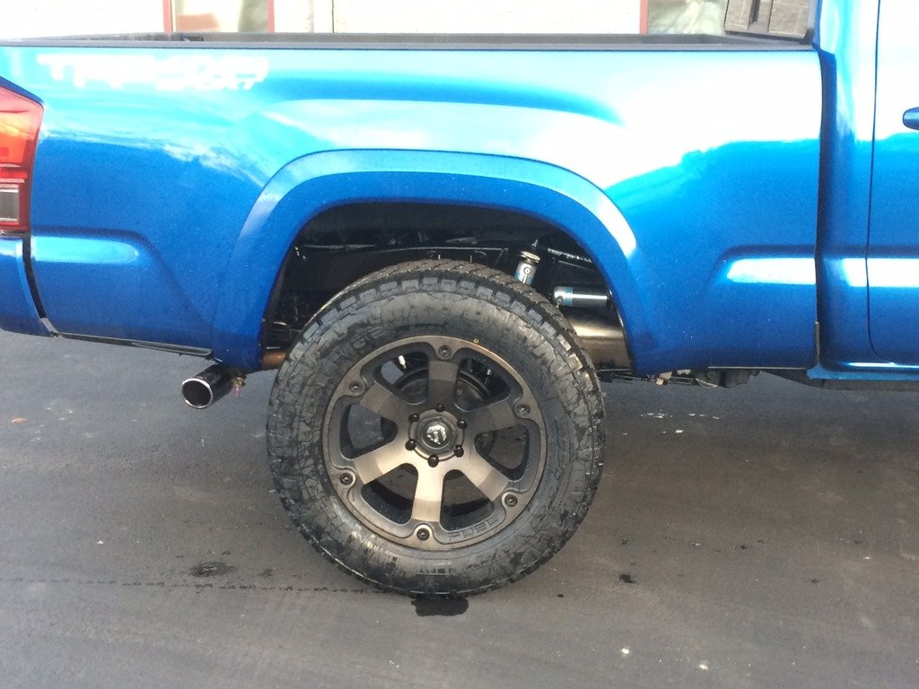

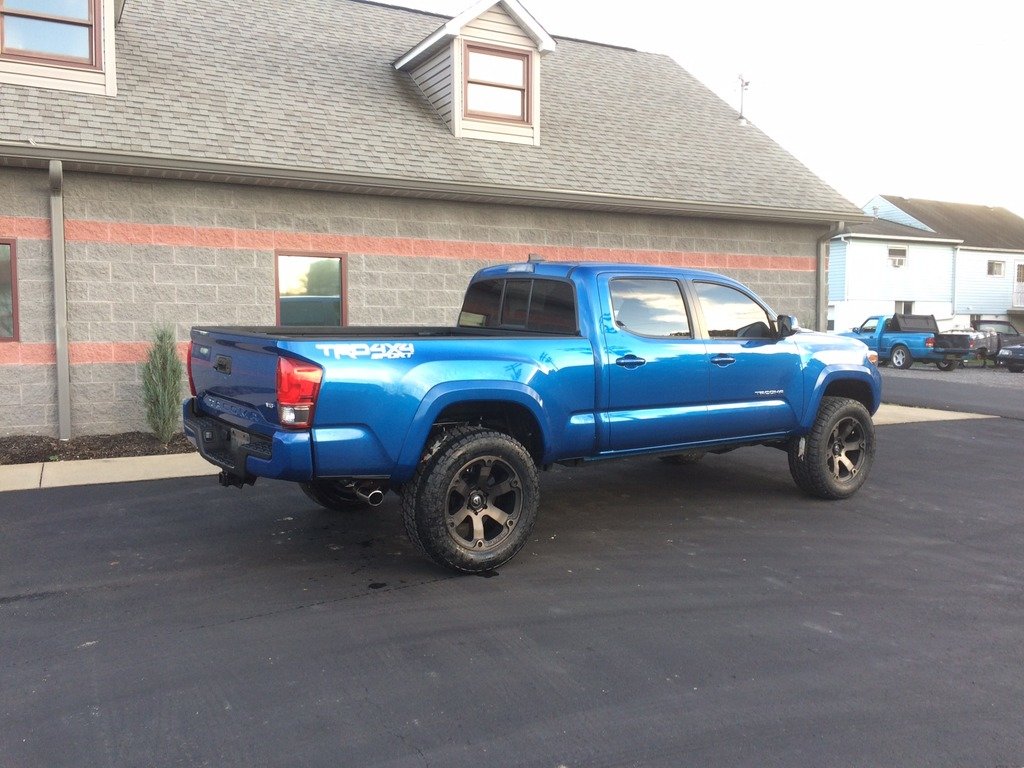

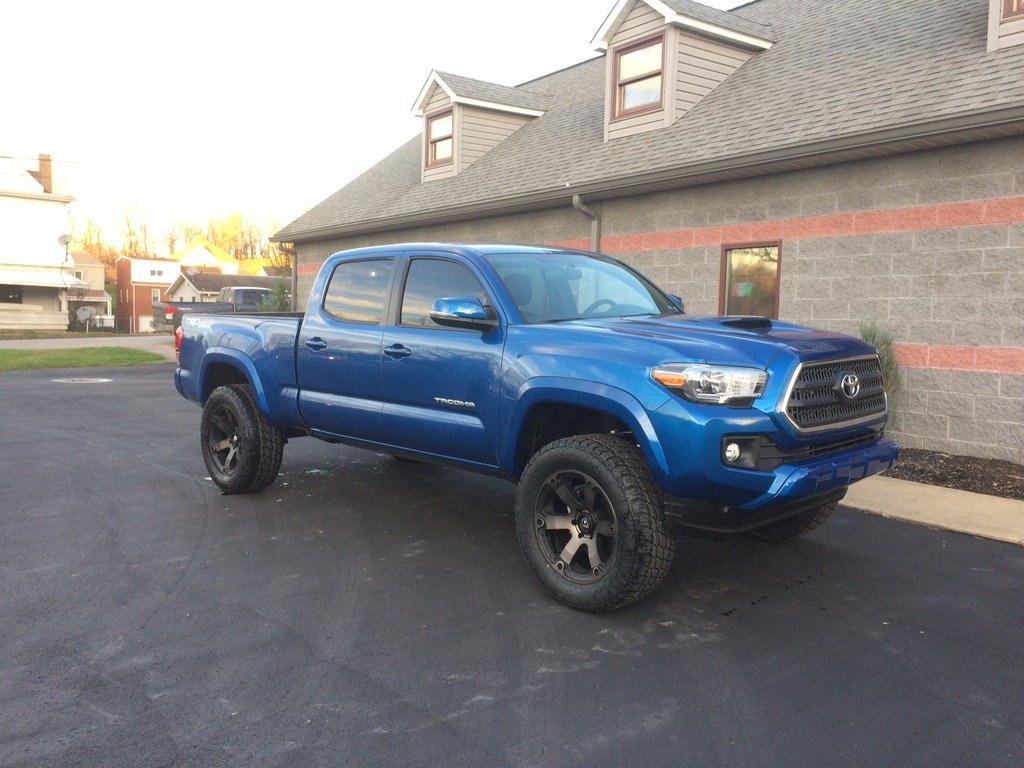

    2016 Tacoma Sport
    3 Inch lift, Fuel Maverick 20x10, 33x12.5 Federal tires, Borla exhaust
    TRD Sport 2x4
    Fuel Maverick
    20x10 -24
    Federal Couragia 33x12.5
    ProComp 3/1 lift kit
    Slight trimming on front Spoiler and inner liner
    SilverII and Airborne daddy like this.
