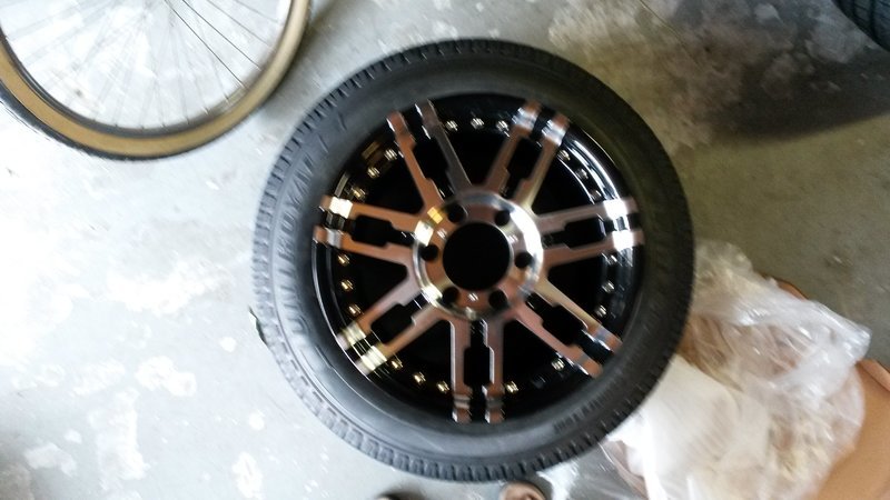

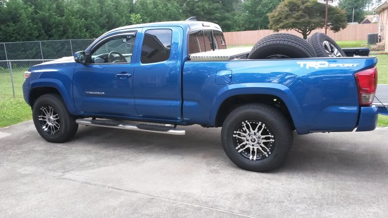

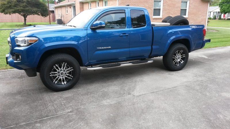

    Got my shoes and socks ready to mount. TRD Sport RWD. New are 265/70-17 ($117 each) on 17 x 8 +10 ($119 each)20160601_165600.jpg and, if my trigonometry is correct, I should get lock to lock with 1/2" clearance on stock suspension at tightest spot. Ready to add a level kit spacer or 5100"s if I need to. 20160601_163739.jpg

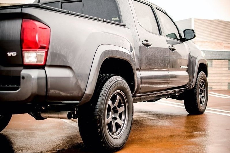

    FN Six shooters first 2016 with them. Great company to deal with. Dustin is awesome. Stock tires until the lift. image.jpg

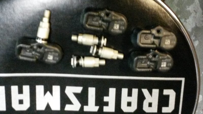

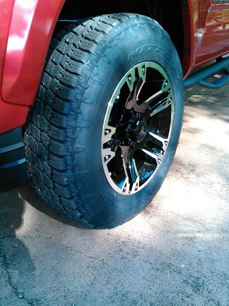

    Finally wearing my new shoes. 3 out of 4 factory tpms in my factory sport wheels were broken off from stems and just bouncing around in the tires. Never seen that before. Documented when mounted tires by service manager. Another 5k issue.

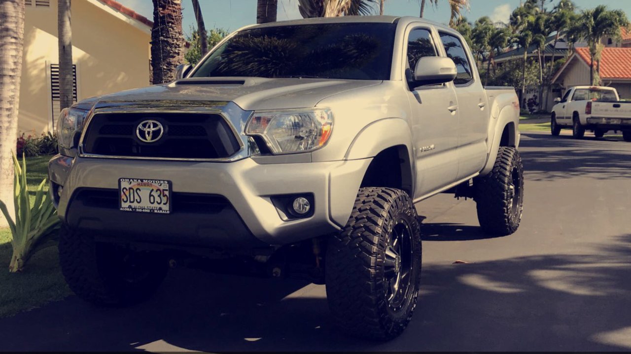

    4d 2014 Tacoma trd sport
    6inch suspension lift 33/11.50/18r mudterrains

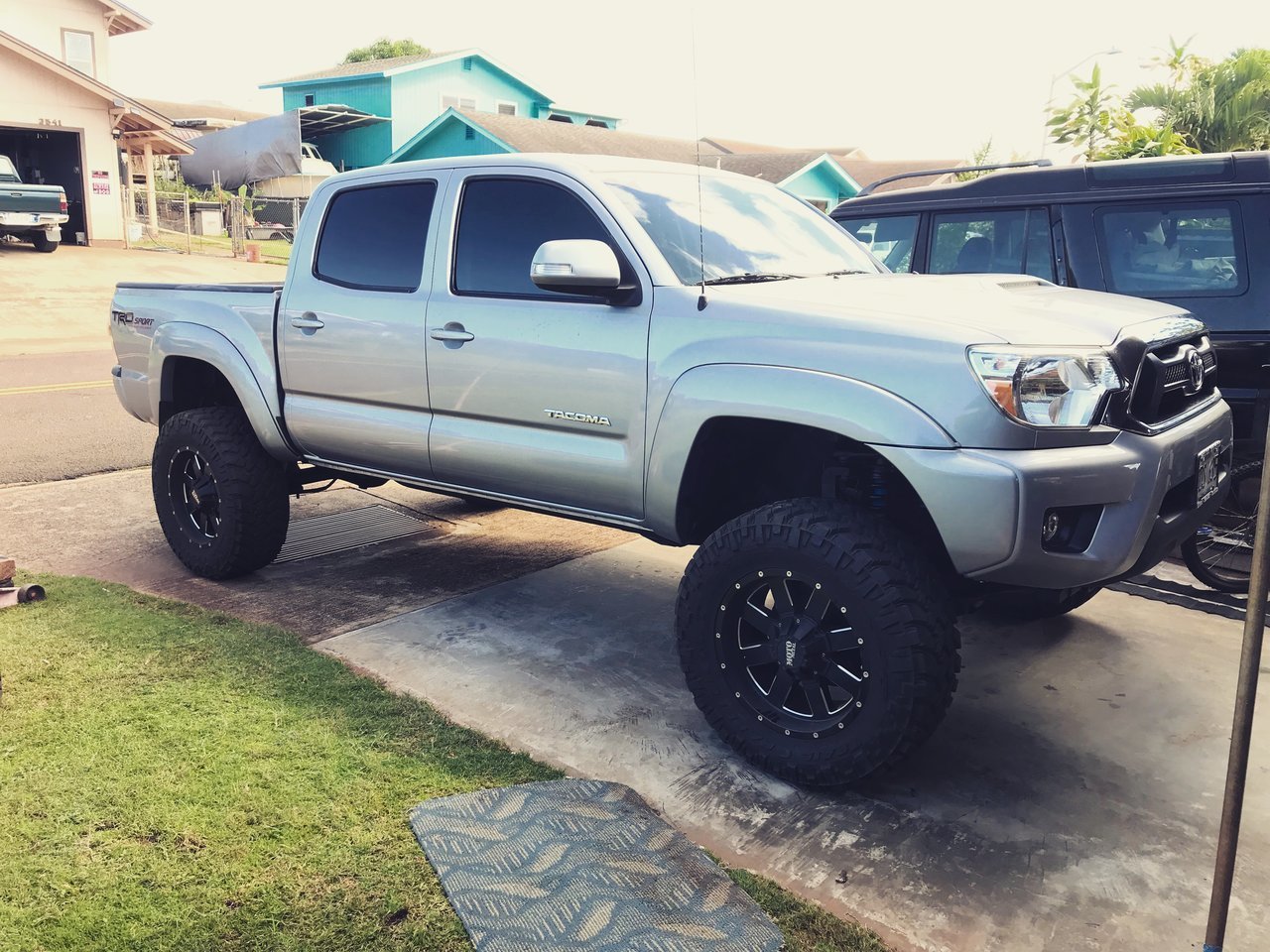

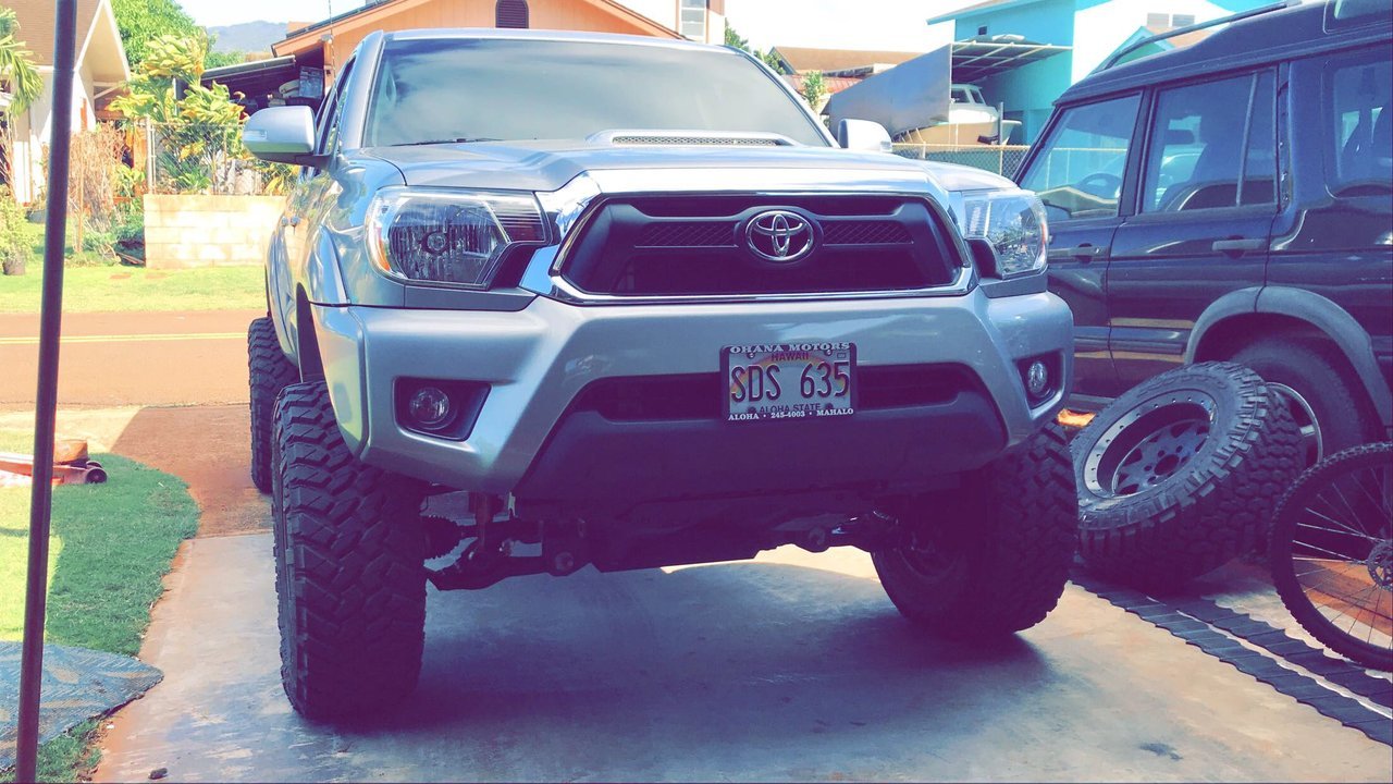

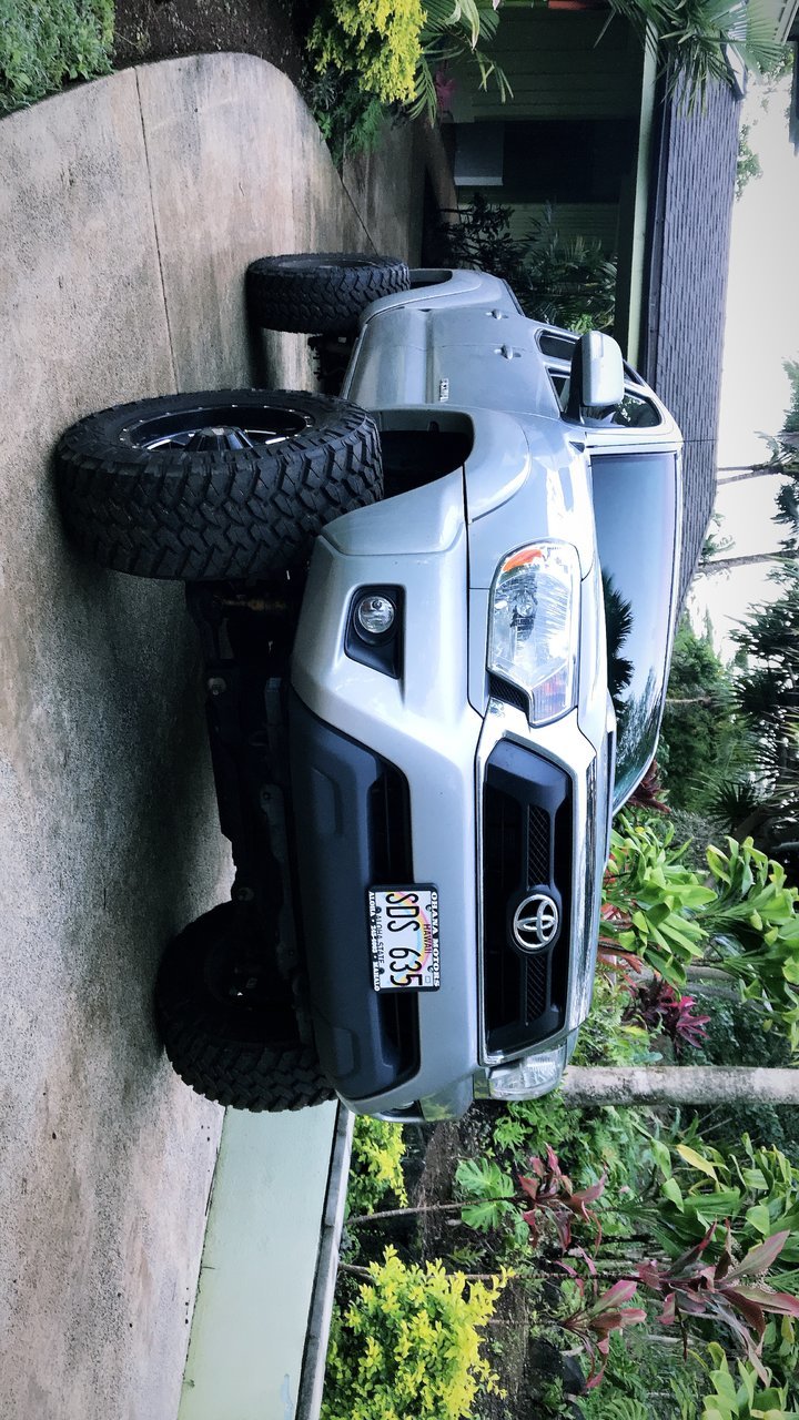

    Here’s my 4door 4wd 2014 Tacoma TRD Sport
    -6inch supension lift
    -33/11.50/18r nitto trail grappler mt
    -18 inch moto metal black gloss wheels 0 offset
    -2inch wheel spacers
    -no rubbing
    -even without spacers no rubbing
    C434042B-16F9-4803-BABB-5CEAA6667E0A.jpg F2B2F183-E522-49BB-8DA1-42ECD63D7D82.jpg 3CF73910-0647-4B24-9234-BE83AC52D0CD.jpg 9A6BDB2B-8FD4-44BE-9ED4-1F0E02206E32.jpg

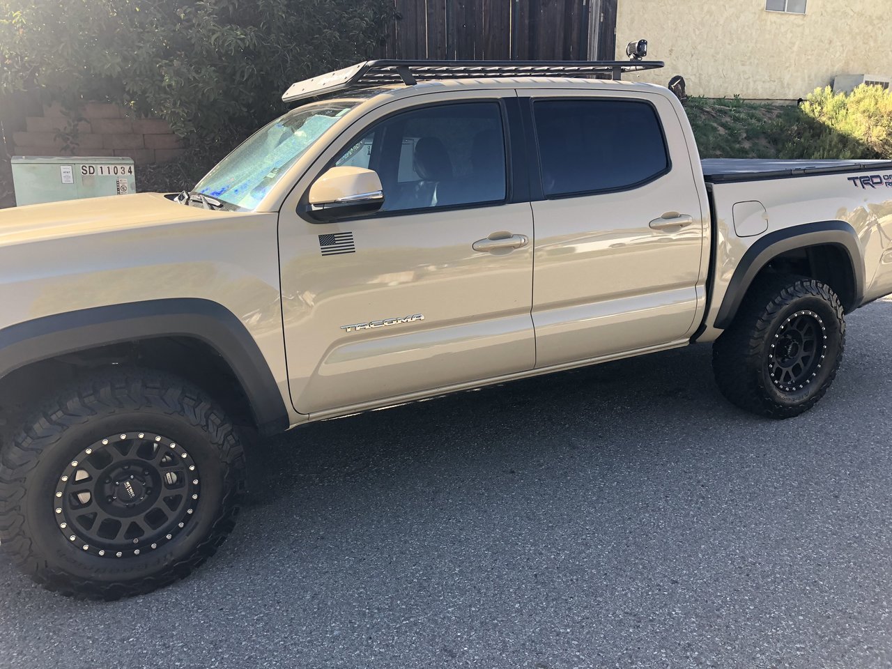

    2018 TRD OR

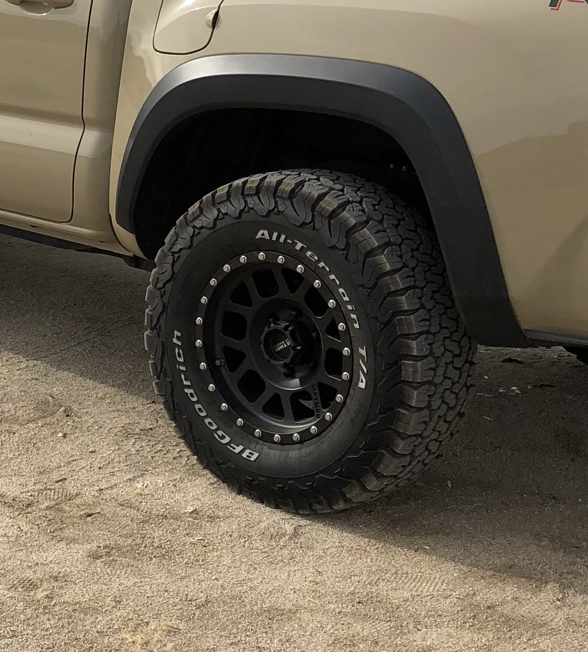

    BFG KO2 275/70/16
    Method mesh: 16x8,0mm offset, 4.5 backspacing
    I haven’t experienced any rubbing at all. I even ran these tires on stock OR wheels and didn’t have any rubbing.

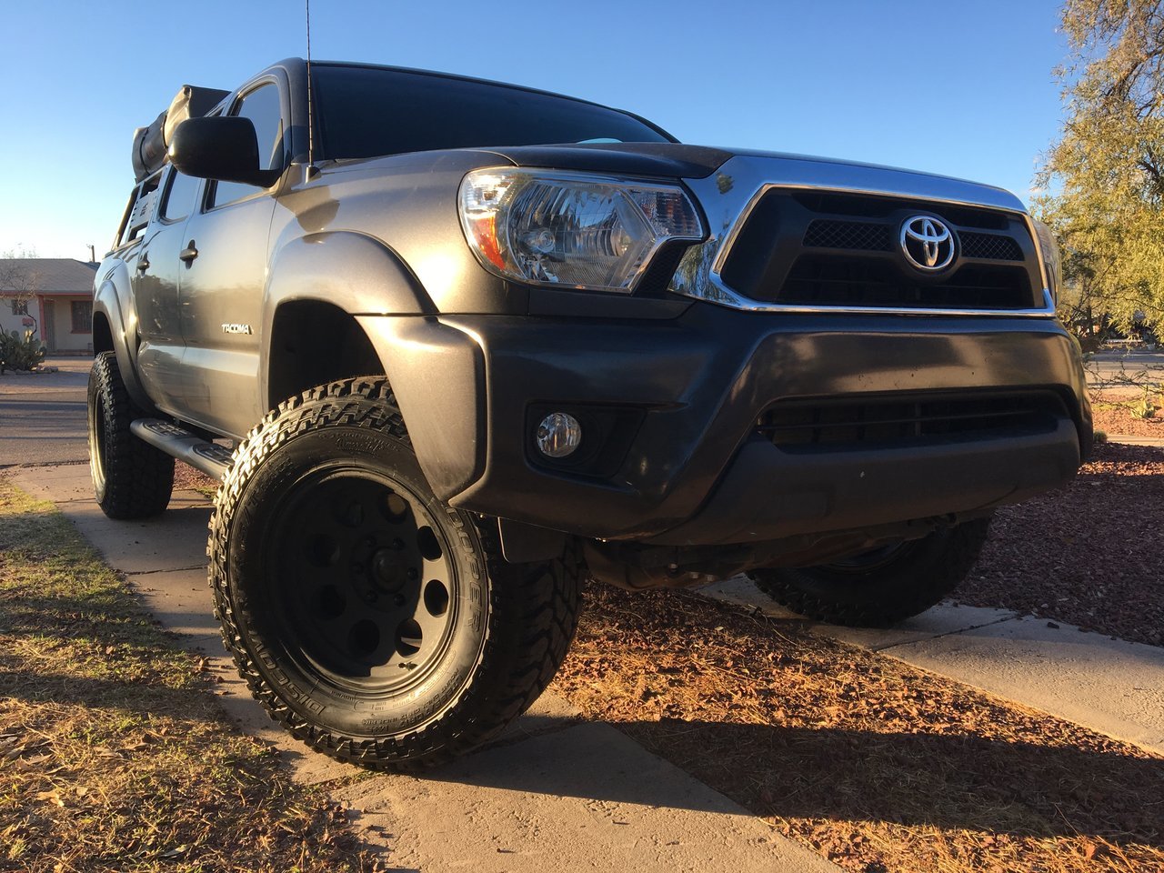

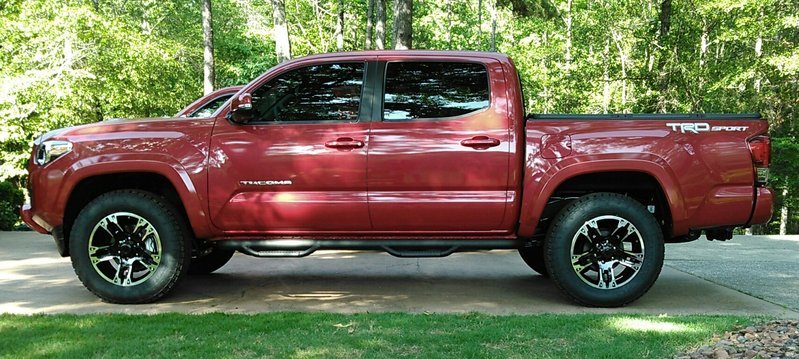

    ADS front coilovers, ICON rears, Deaver Expedition Pack, CBI Bumpers, RCI skids, Avid sliders, Warn EVO 10S, on 33" Falken Wildpeak MTs, Vagabond Drifter camper & Goose Gear interior.
    Cooper ST Maxx
    285/70/17
    Pro Comp 7069, 17x9
    Icon Stage III at 2.75" Front
    (rear Dakar leaf packs ~2.5" lift)
    Good bit of plastic trimming on fender and liner, no pinch weld interference, slight rubbing on cab mount at full lock.
