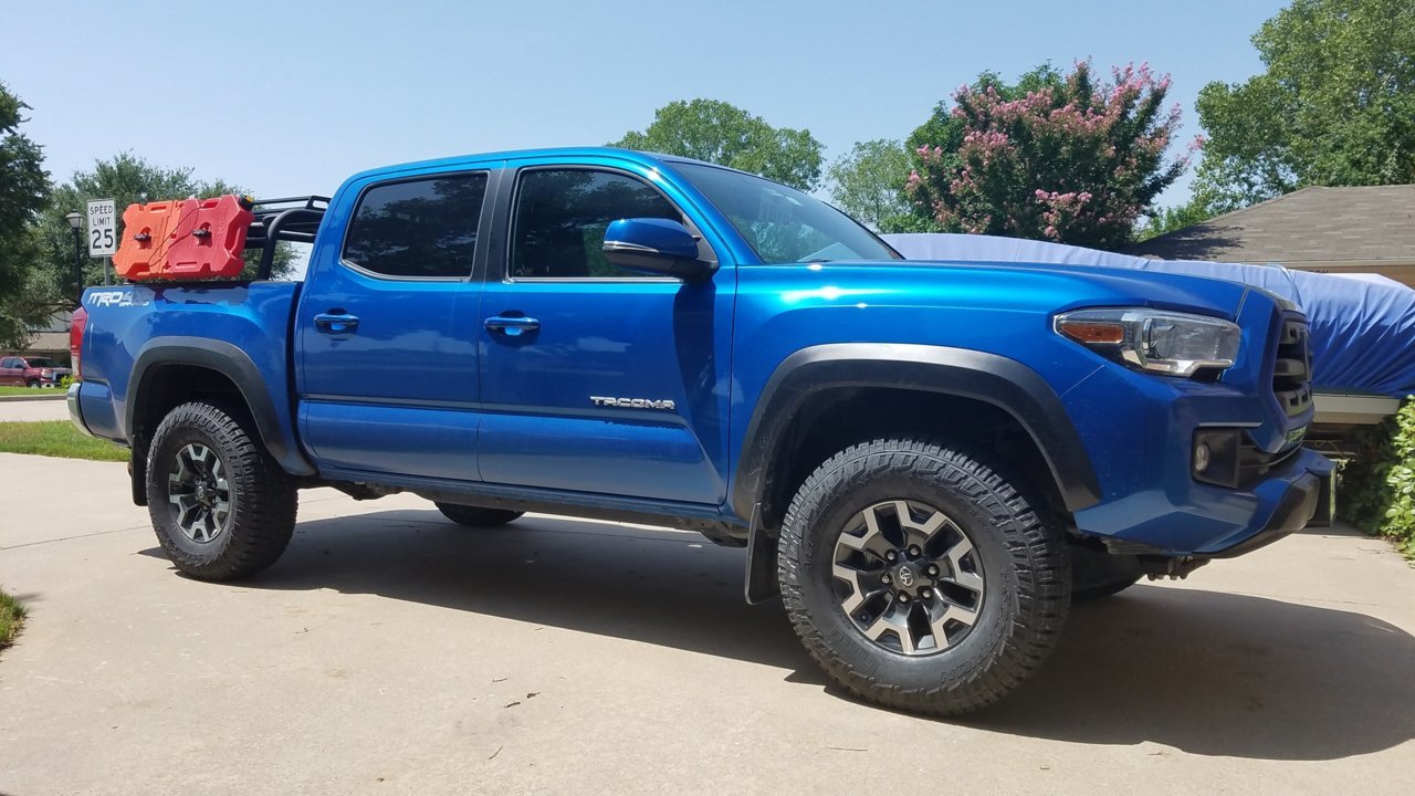

    2. Pirelli Scorpion AT Plus
    3. LT265/75/16 LRE
    4. Factory wheels
    5. Factory suspension
    6. Zero rub.

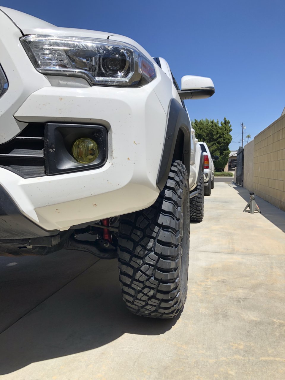

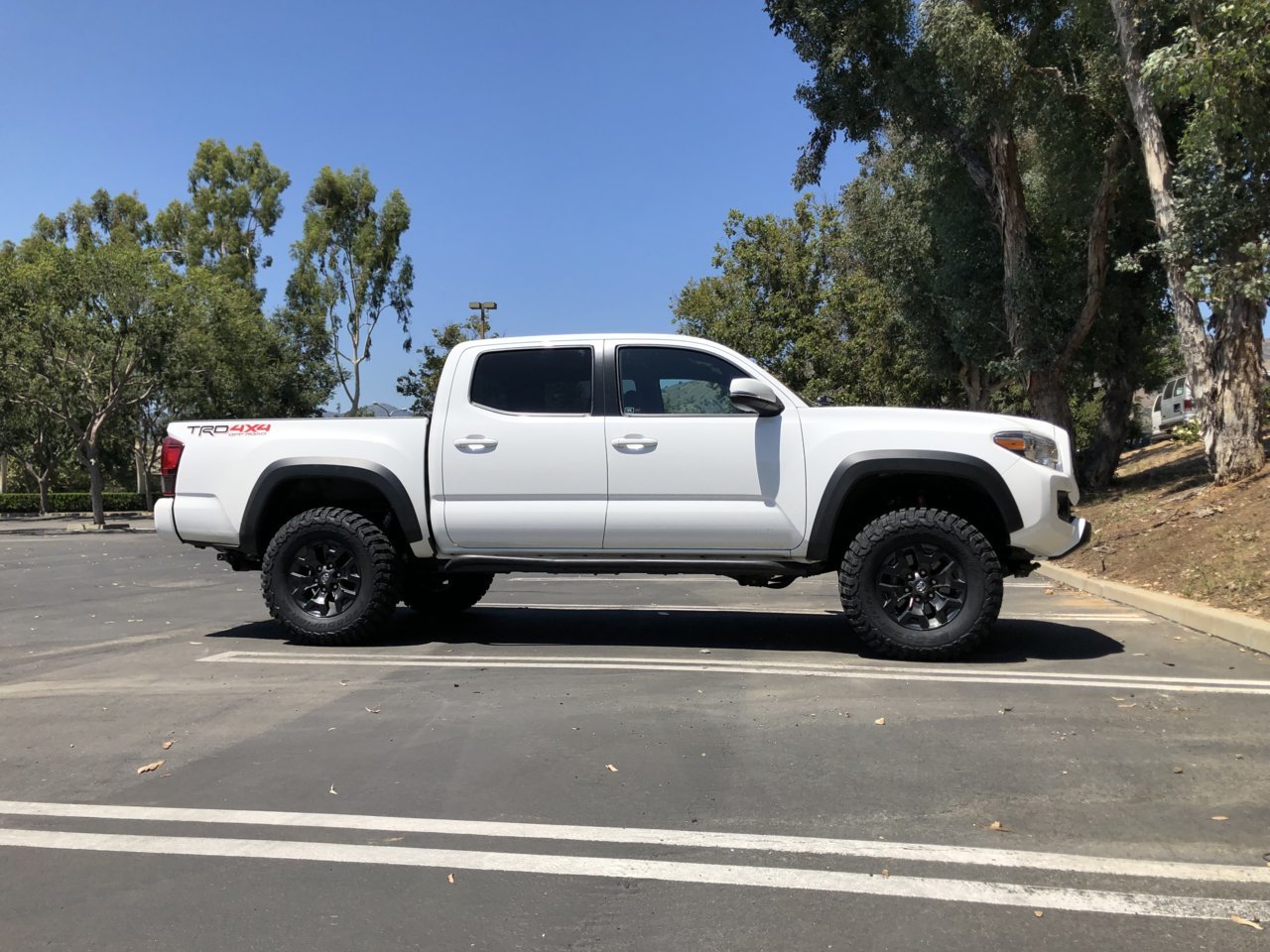

    Front 2.5 coilovers rear Deaver u402. 2”? Front lift, 1-1.5” rear.
    Stock TRD OR wheels with 1” spacers
    265/75 BFG KM3

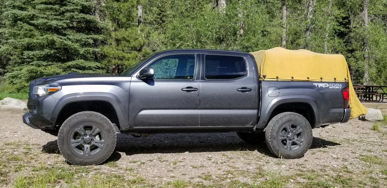

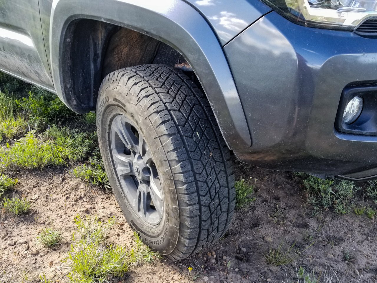

    Eibach pro truck kit + Icon 1.5" progressive AAL 255/75/17 Continental Terrain Contact AT LED interior light kit. Derp: wheels, grill
    Eibach lift kit
    Icon 1.5 AAL (modified OL leaf left in) ~150lbs static in back (not holding up well, curve wise)
    Continental Terrain Contact A/T 255/75/r17
    Stock (derped) TRD Sport wheel
    Lift: ~2in (almost factory rake so... FH 1.8" RH 2.2", total guess tho)
    No rub before or after lift
    Like the setup/height, tires keep proving themselves (kinda scared myself this weekend in the desert, tires didn't even slip).

    which setting did you set your eibach at?

    Lowest setting.
