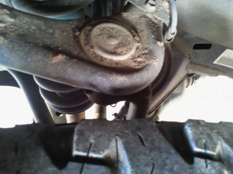

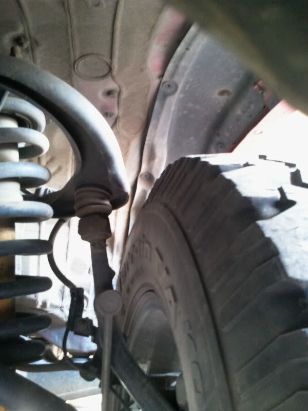

    Yep way too much pressure. And OP are you sure they weren't rubbing on the upper control arms? Those wheels aren't spec'd right for 285s

  20. May 29, 2012 at 6:42 PM
    #20

    Yes the offset is high, but with the 9" wide wheel its pulling the tire far enough out for it to barely clear. I would imagine with mud tires (especially nittos, among the most aggressive sidewall around), you will rub.
