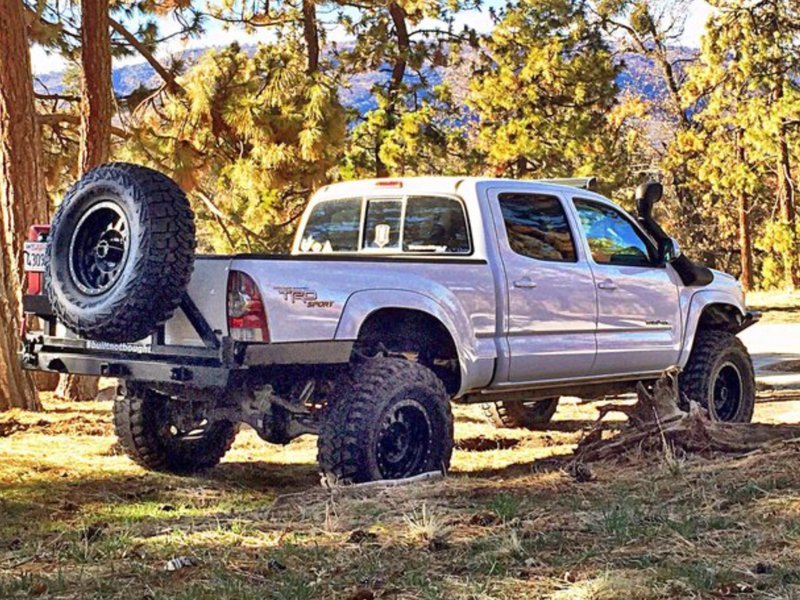

    This is what I run and can remove in 5 min which is what I did today to move a treadmill.
    Cut off side brackets closest to axel BUT tire will be used as an axel bump when flexing offroad LOL

    33" is the biggest that will fit with a stock bumper and not interfere with the travel of the rear axel.

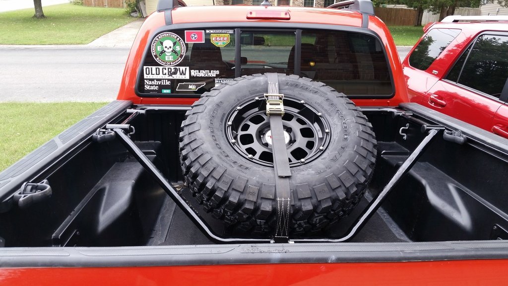

    I only carry a 2nd full spare when I'm out hunting, fishing, exploring, etc., so I don't need a permanent mounting solution. I simply place the spare vertically up against the front of the bed and secure using a ratchet strap & the OEM tie town cleats. Then I place my tool & recovery gear tote up against that. With my rubber bed mat, nothing moves.

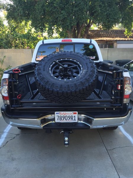

    image.jpg image.jpgI don't use the strap anymore. I had a large screw type jack welded in the center and a cone adapter made for the center of the wheel. I don't have any good pictures yet.

    •Total Chaos Uniball UCA's •2.5" King Coilovers •Deaver custom U402 leaf springs •2.5" Rear King Smoothbodies •16x8 Method Standard's •LT285/75-16 Goodyear Duratrac's •Wilco Offroad PreRunner Tiregate •Stewart's Race Works floorjack mount - mounted in bed •3 ton HF floor jack - mounted in bed •Cab Mount Chop - Relentless Fab Plate •Flattened pinch weld •BAMF Sliders (bolt on + no kickout) •Spintech 6000 muffler •Relentless Fab Bed Bars •CVT Mt. Shasta
    I walked into their shop.. I would call and get a quote from them. They are good people!
