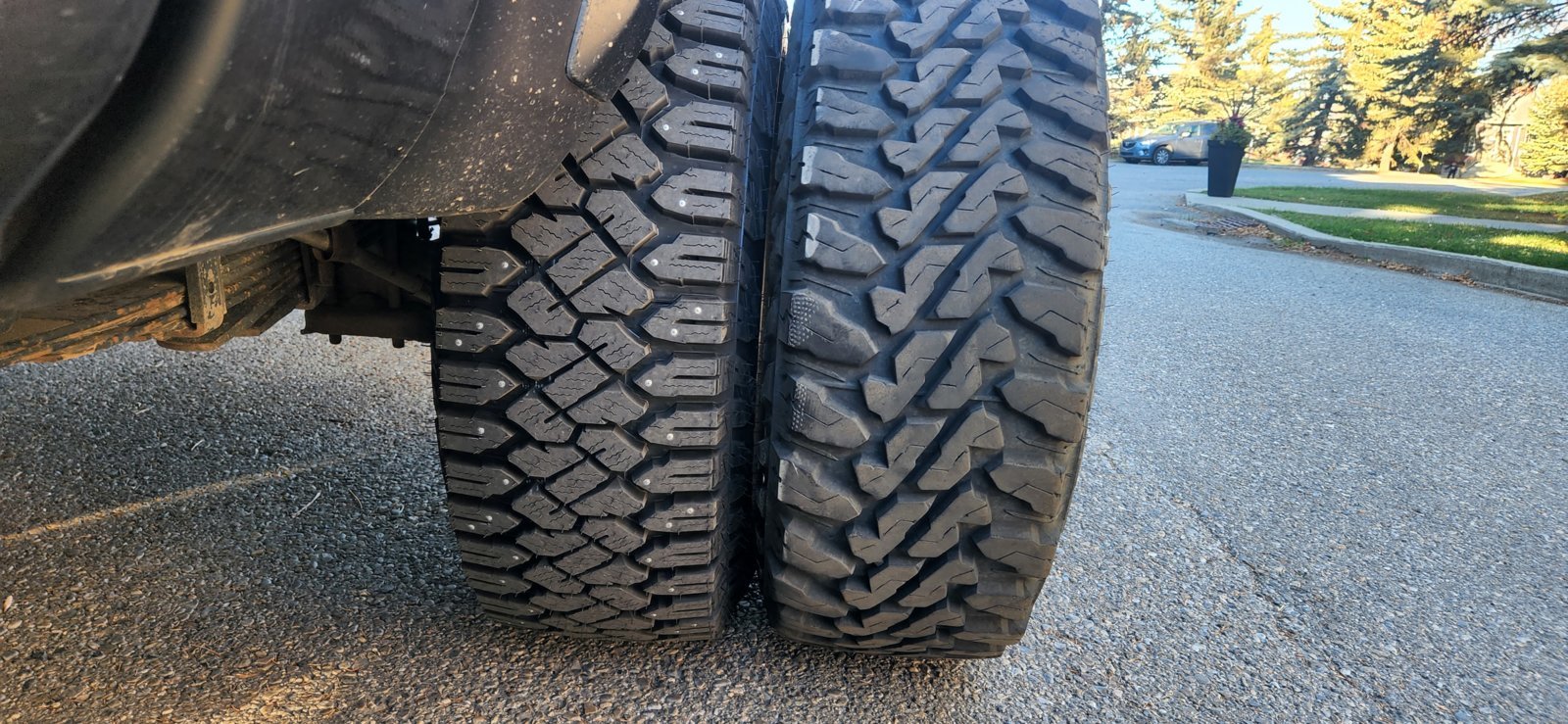

    Studded tires are snow tires with studs to assist on ice. When snow tires were not that great (pre 2000) a lot of people in snow country would add studs to their tires for icy conditions. Studs do not assist in heavy snow. You just left your studded tires on all winter. Not needed now as snow tires are pretty good now. By the way snow tires or snow tires with studs should be the same configuration on all 4 wheels. Doesn't matter 4x4 4x2 or fwd. I have lived in snow country Canada 70+ years and never needed anything but good snow tires, no chains. Was a ski patroller. At mountain pass check stops here you need good snow tires or have chains available.
