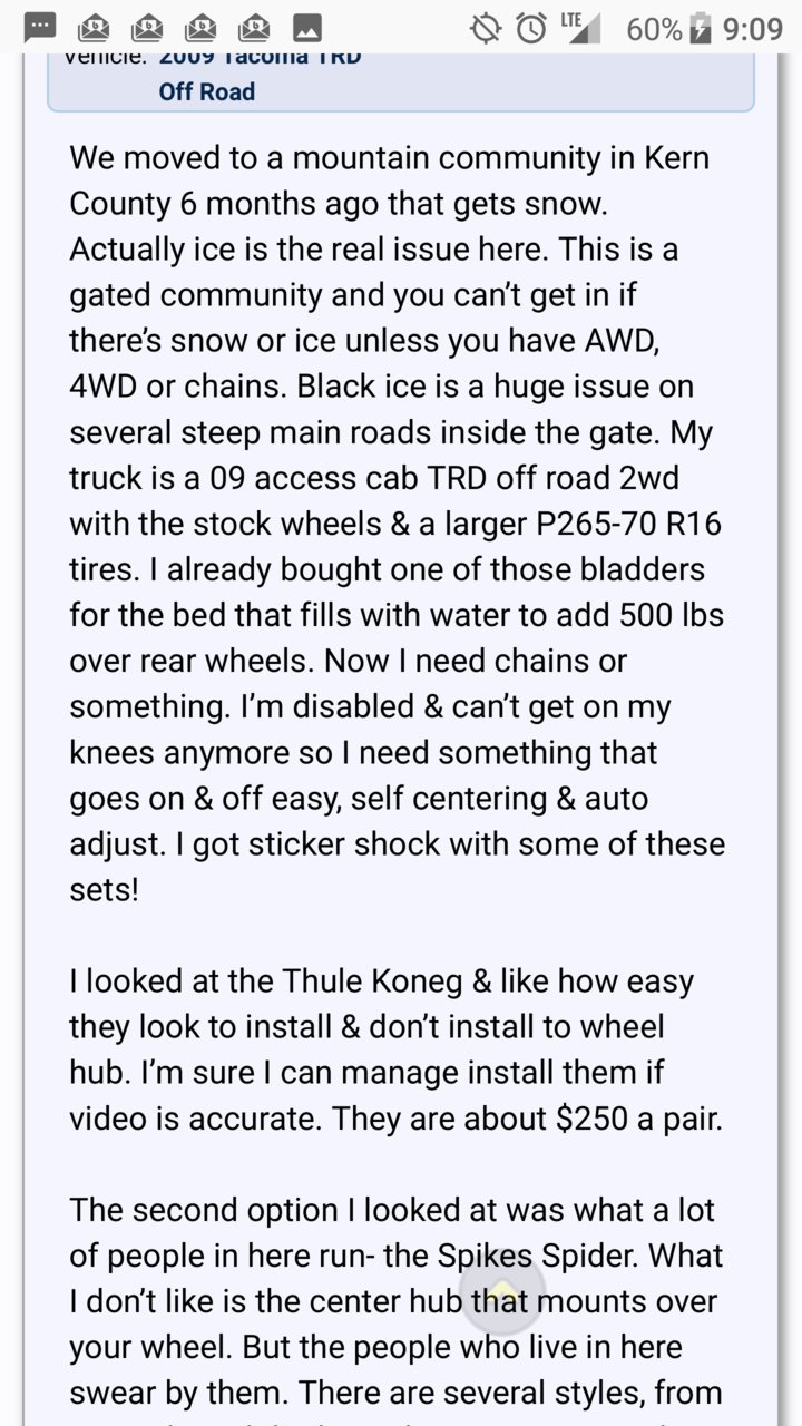

    Ok- to answer some questions-
    Moved here 6 months ago. We caught the end of a storm when doing walk through back in March. Sign at gate said 4wd or chains required at upper elevations. We are in valley floor(on purpose) with a short level driveway to ease clearing drive to get out.
    Snow is less & less every year (drought). Used to get big storms here that could drop 3-4 ft. Now a 12-18” storm is a big snow year.
    Studded tires are not legal here.
    We are at 4400 ft, some homes are over 8,000 ft elevation. It all gets snow.
    We are retired so we can wait out the storms here that typically last only a few days. We are stocked up on food.
    They plow the roads as soon as the snow stops except main road loop that they try & keep clear. Plows don’t deal with ice.
    They do use something on roads for grip. It’s a brownish/red color. Getting it down at the right time is iffy.
    When I bought my truck a year ago, we had no plans to move to mountains. so 2wd was ok. I don’t off road.
    Truck is paid for so getting a 4wd is a last option. We told ourselves we would try a winter before buying anything.
    We are on fixed income & while we have no payments inc house, a truck payment isn’t an option. It would have to be used & equal value.
    The bladder is made by Suretrax & holds up to 300 lbs- my mistake. You can add less water & drain it when not needed. Lifting bags in & out of bed is something I’d like to avoid. It will handle water freezing & is baffled to minimize sloshing. [​IMG]

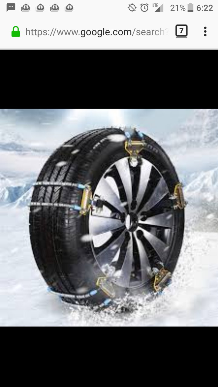

    I've never used these, does anyone know if the emergency chains that go through your wheel and around the tire are any good? May be an option for OP?

    Just a quick thought on those chains..... ice build up on the latches would throw out your wheel balance. I know they aren't intended for long term high speed travel. Just my quick observation. They look like they would be easy to install and perform well
