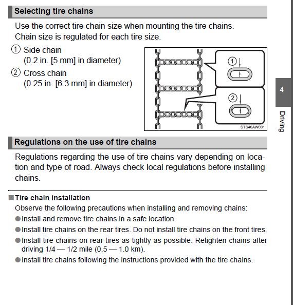

    2017 owners manual (PDF available via google) states: "Install tire chains on the rear tires. Do not install tire chains on the front tires."
    They don't explain the reason.
