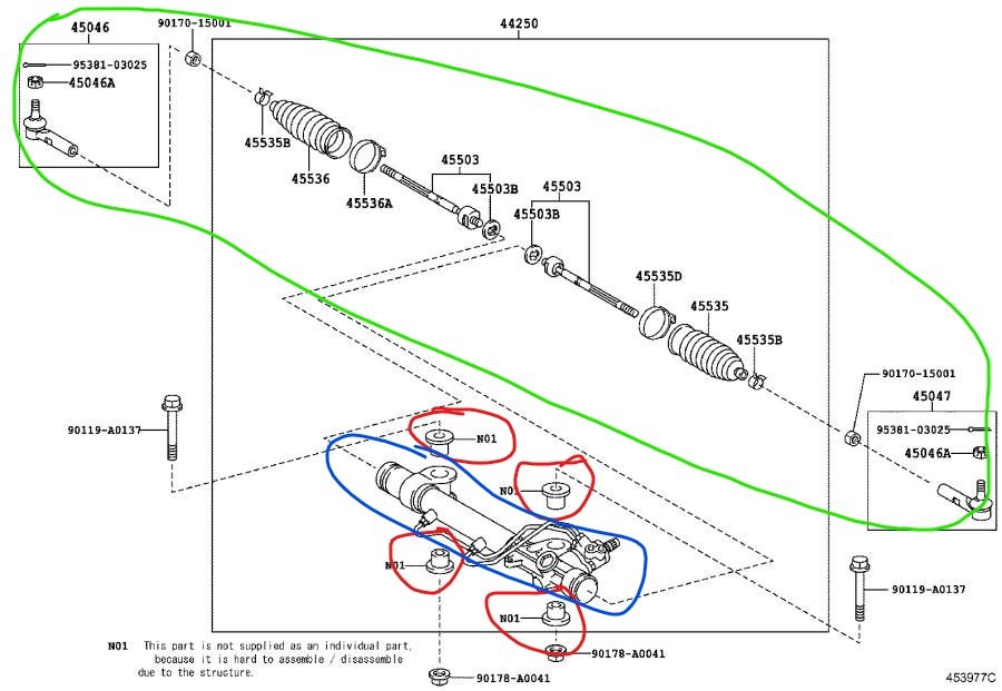

    For those of us who aren't mechanical what are we looking at in that video? Is that stuff not supposed to be moving when he wiggles the steering wheel etc?
  19. Aug 26, 2022 at 10:15 PM
    #19
    dezert.taco
    dezert.taco Well-Known Member
    Nov 9, 2020
    #346299
    448
    Nate
    Northern Nevada
    2018 Tacoma
    No, shouldn't move as much. Bushings will always have some deflection especially when under load but should be minimal on good bushings. What you're seeing in the video is what is circled in blue and red below, the red circles being the bushings themselves where the blue circle is the steering rack and the green circle shows the inner and outer tie rod assemblies that goes on the ends of the steering rack.
