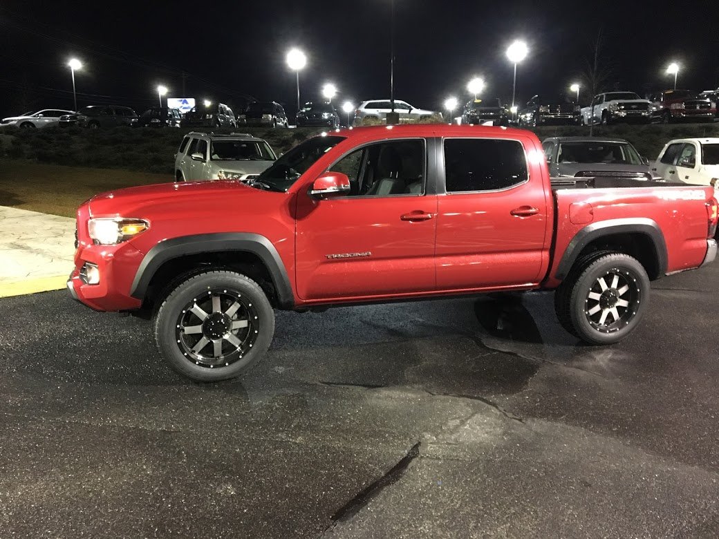

  10. Feb 11, 2018 at 7:05 PM
    jubreunig
    jubreunig [OP] 3" RC, 20x9 285/55
    Jan 20, 2018
    #241871
    59
    Juergen
    Tuscaloosa
    2018 TRD OR
    20x9 +18 BigBlock 726m, 1.25in Hubcentric, 285/55 LEXANI SLAYER AT PLUS
    here is it

    Yep, I'm born in Germany and I'm here for temporally 2, perhaps 3 years. I work at the Mercedes-Plant in Vance AL. And hey, your german is good!
    Thats pitty, the tires fits optical perfect. I want to travel with this, but not so. I think I have to switch to 265/50
    ..and if I go back, I want take him with me
