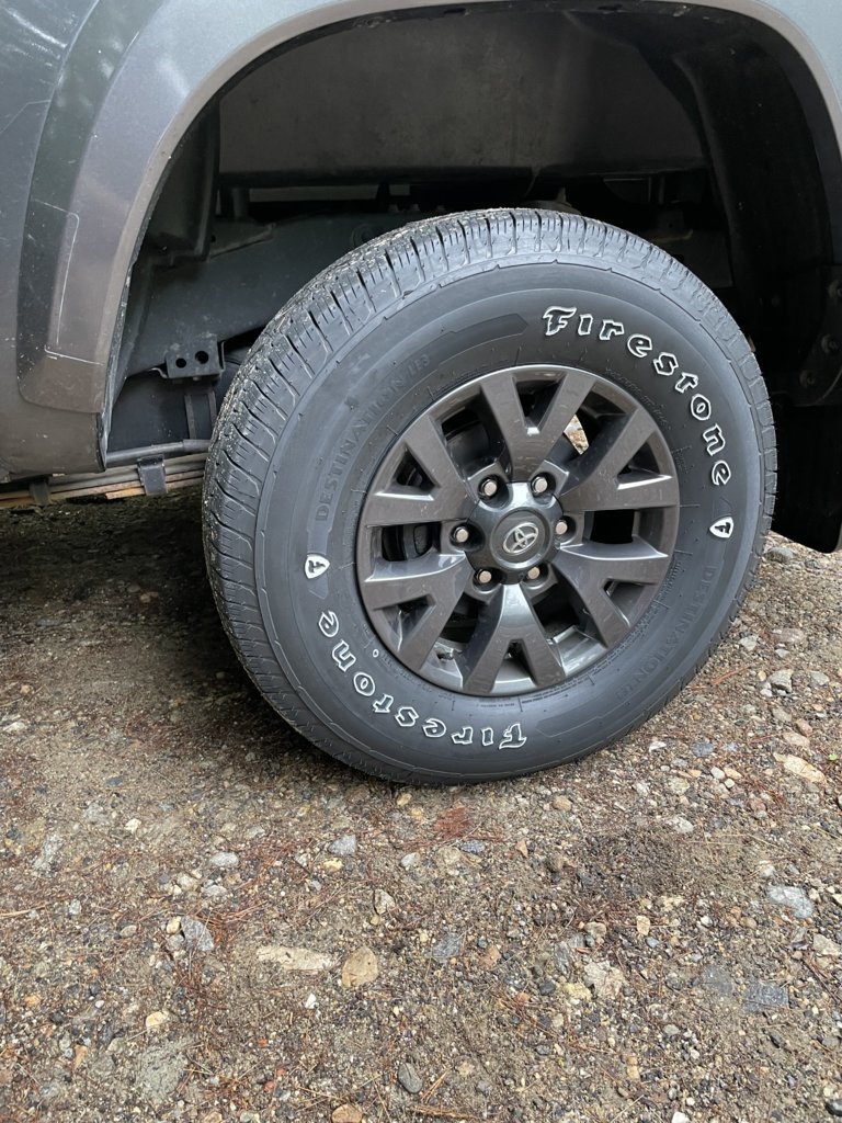

    The problem with tire selection is most people overthink it. I’m one of these people, At 38k miles I sized up and went with a set of Toyo H/T 265/70/16. They are a great tire, but weren’t for me, a much louder tire, low mpg, and handling was more like a truck with no power steering. Most of my riding is 95% highway with the 5% in the fall for hunting off of logging roads.
    So I switched back to 245/75/16 with Firestone Destination LE3; quiet, great handling, great mpg.
