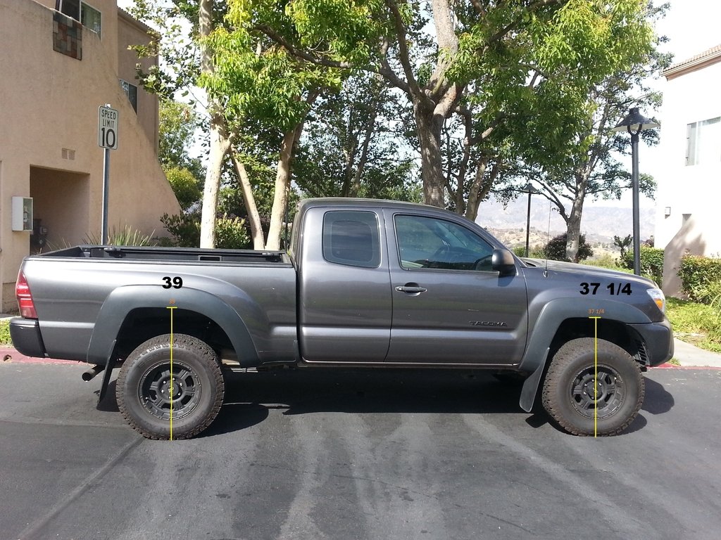

    Here's my truck with a 2.5" lift running 265/70r17s (+1" over stock)

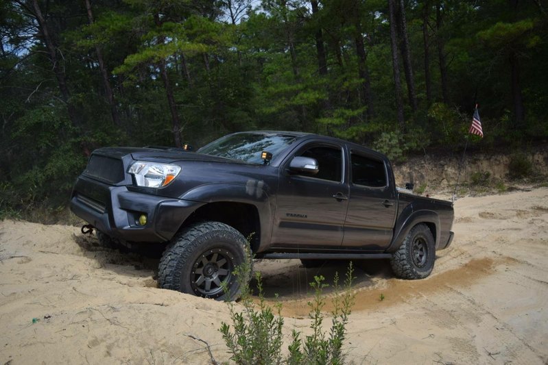

    Here's that same lift with 285/75r16

    As far as wheels go, the farther it pushes the tires out, the more you're going to rub on the firewall. Ideally you want something that's 8" wide with 4.5" of backspacing. This helps to keep the wider tires from rubbing on your UCA.

    :wave: I ran 285" on a 3" lift with little trimming and wheeled the shit out of it:thumbsup: Its a perfect combo :cheers:

    Dude what a difference...Love the rim and tire combo :thumbsup: Oh and DCSBMGM...:drool:...:cheers::cheers::cheers:

    Thanks man!!! It's amazing the difference some bigger tires make.
