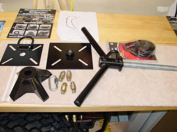

    Here is what was in the box

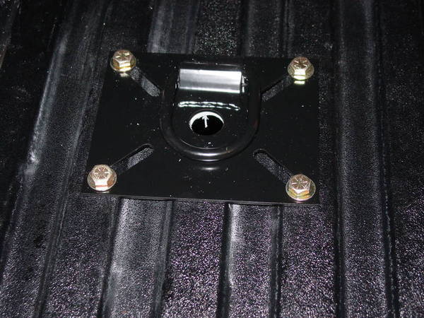

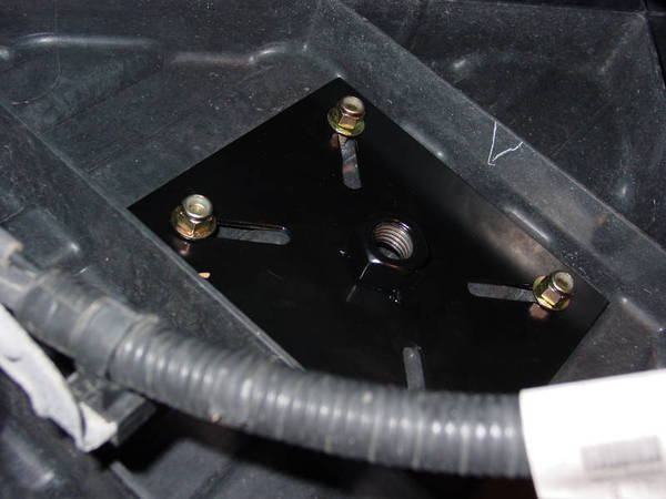

    Here is the top plate with the screws added, I used a large round course file since I drilled the holes a tad bit smaller 3/8" for the four screws and 15/16" for the large center hole.[​IMG]
    Bottom plate
    Since I wanted to keep my bed mat, I measured the top bracket and added 1/4" and made my cuts.

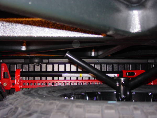

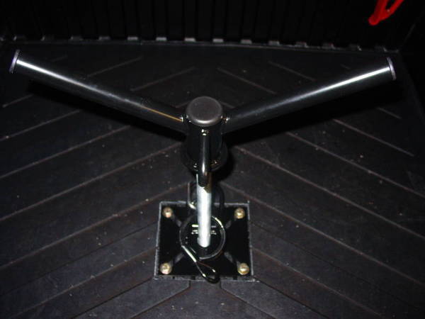

    Here is it somewhat finished before placing the tire. I looked at a number of ways to run the cable. Decided to run the main shaft down the middle of the coil.

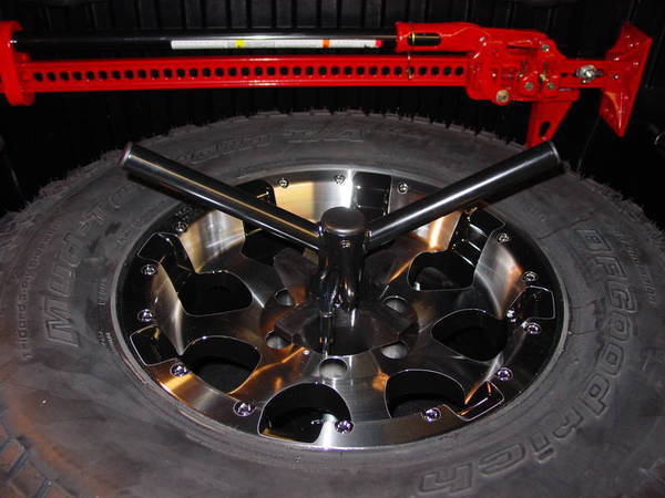

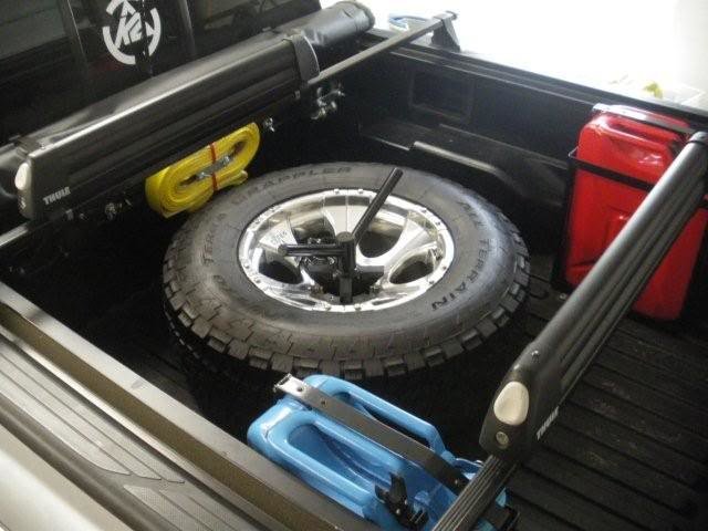

    Here is a shot with the wheel on, now the big thing....will my Undercover still close.
    YES!! cover closes with room to spare. Still need to get a lock, someone will have one heck of a time stealing this.
    All in all I am really happy with the outcome. It is not a mod you just jump into. The center hole is the biggie. Go very slow in drilling, regular bits grab the crap out of the bed, and if you are not carfeful I see someone cracking it.
    I was thinking about measuring from the top, "don't do it" get the bottom plate the location you want and start with the center hole first. The rest is "a piece of cake"

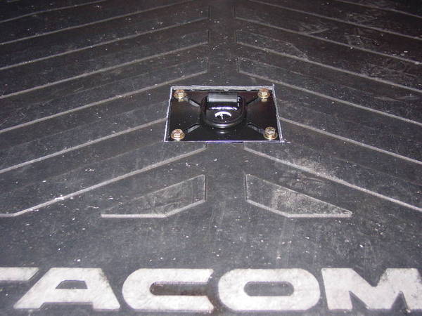

    Nice job.....Is there a reason why the nuts (underneath pic) don't have the bolt threads running completely through them? I see they are nylon lock nuts but I would think there should be at least a 1/4" of thread past the nut.
    Could just me and the instructions call for different. enjoy your mod.

    No, those nut's are not tightened down in the photo.
    To be honest I needed another pair of hands, so in waiting for my daughter to show up I took a few of the pic's.
    And you are correct, the threads are 1/4" past the nut now.

    I like it. Nice install and write up. Probably should get some 1/2" longer bolts though, they may loosen in time.

    ok not tight, gotcha....you can always clamp a pair of vise grips onto the top and go below.

    As for the screws, I went by the instructions :) But I do have different bolts I am going with, Same size dia, little longer in SS, but the are torx and have the pin in the middle, so a special torx bit is needed.
