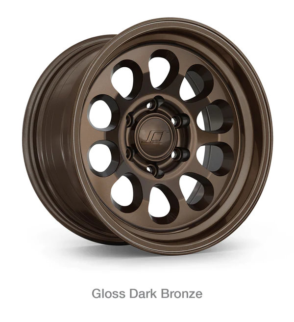

    Hello everyone! This is my first post and I appreciate the feedback. I will be picking up my first Tacoma in a couple of weeks and wanted input on tire size for the aftermarket wheels I purchased. I scoured the forums and could not find concise answers on the below questions.
    2023 Toyota Tacoma TRD Sport Double Cab 5' Bed V6 MT Blue Crush Metallic
    OEM wheel specs: 17x7.7 +30mm offset
    OEM tire specs: 265/65/17 (Goodyear Wrangler Duratrac)
    Aftermarket wheel specs: 17x8.5 -10mm offset (Stealth Custom Series Gloss Dark Bronze)
    Aftermarket wheel specs: 275/70/17(?) (no tires yet purchased).
    I think I should wear out my existing tires first and upgrade to larger tires after. That said,
    1.) Will the OEM 265/65/17 tires fit on the aftermarket wheels I purchased without any issues? (I can suck it up looking dumb for a bit while I wear out the tread).
    2.) Are 275/70/17 tires the largest I could go on the stock suspension without rubbing or other issues?
    3.) Are Falken Wildpeak the go to for most people when upgrading tires?
    I do plan to go ahead and get a KDMax tune, ACM delete, and Redline MT-09 tranny fluid swap to have the manual gears shift a bit more smooth and be able to drive as intended. Any opinions on this is greatly appreciate as well.
    PS: This truck will be more of a daily driver/weekend warrior (when able) over the next couple of years. The more expensive mods will be coming after my school program is finished. Thanks again!

    1 - Yes, the factory tires will fit on your new wheels.
    2 - You are more likely to run into rubbing issues when using a negative offset wheel. Most people find that a 265/70/17 is the biggest you can go without too many issues. I had some -10 wheels (SCS) and I rubbed a lot with 265/70/17. Others don't seem to have an issue. YMMV, as the kids say.
    3 - Wildpeaks are very popular but have become expensive and there are a lot of great tires out there.
    (Smart move using up your factory tires first.)

    Thank you so much for answering all of the questions I had! I assumed I would need a lift/leaf/leveling kit of some kind, to fit bigger tires. I'm hoping that I won't run into any running issues with the negative offset on the SCS wheels on the stock tires.
    Thank you for the link! I was finding more info on the TRD Off-Road than the TRD Sport, so I though posting would be a safe bet to confirm what may be needed for my current setup. Hoping to run the SCS wheels and stock tires until the tread wears. Then upgrade to bigger tires/lift all at once.

    You will in no way run into rubbing with stock tire size. If you go up to 265/70/R17 you will have to remove the lower front chin air dam along with removing the front mud flaps. You may still get slight rub on full lock out left/right & while reversing. The - offset is what complicates things more with going up to 265/70 tires. If you chose a wheel with a 0 offset, then you could go up a tire size from stock with no problems. I personally have SCS Blaze10 wheels on my stock suspension trd sport. Absolutely no issues.
