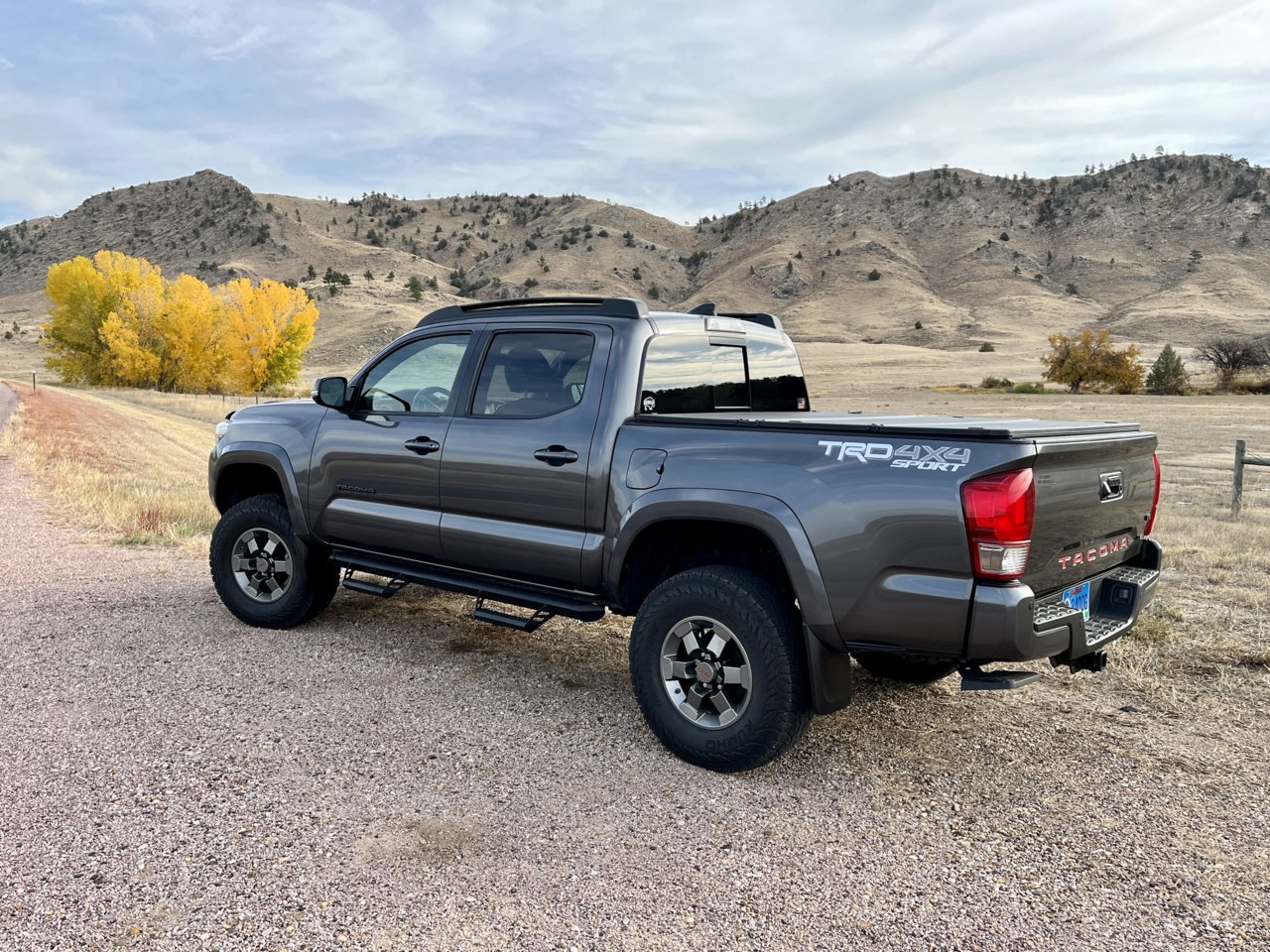

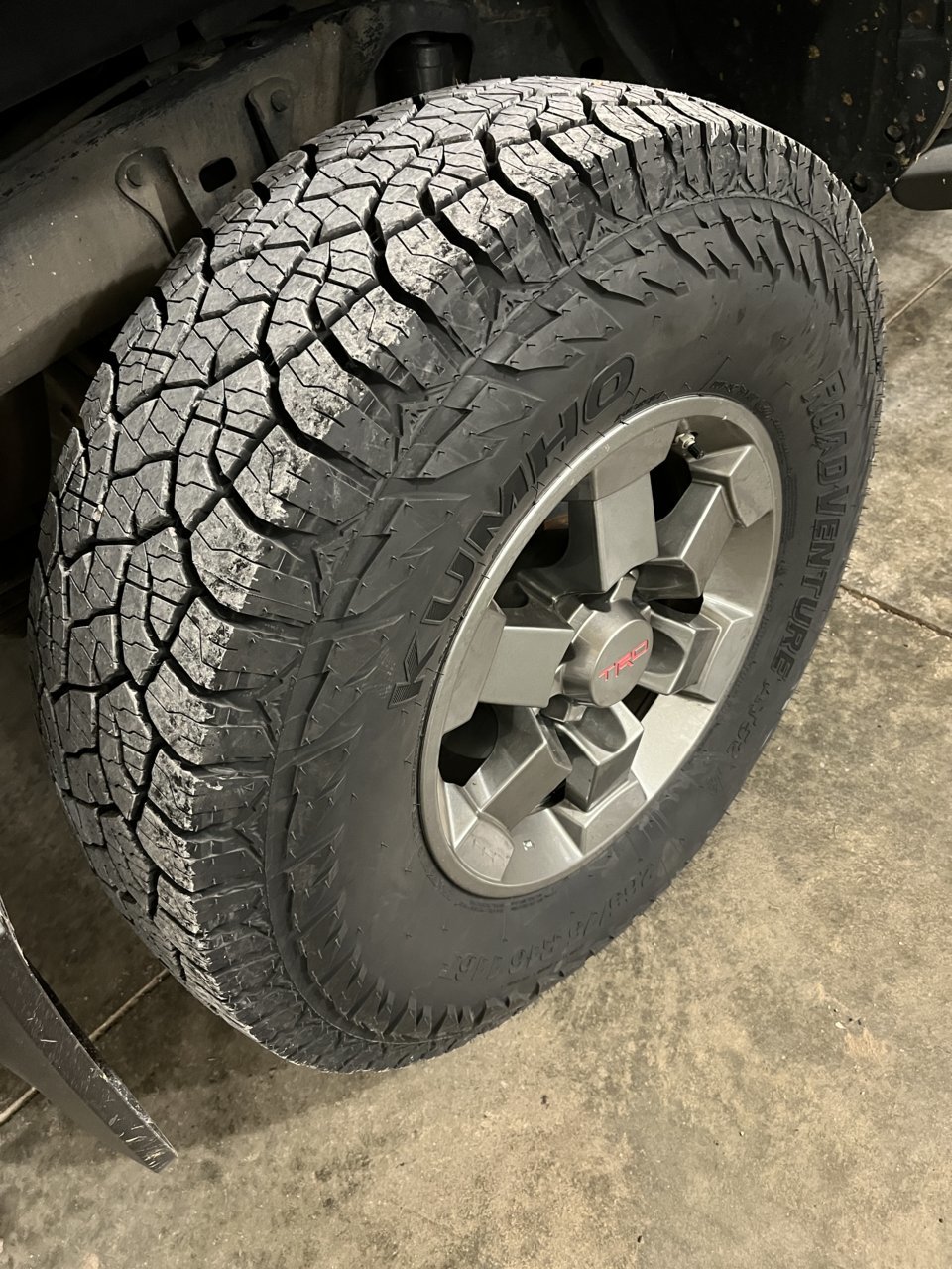

    Thinking about getting this set up. Do you have pics? What size wheel? Thanks!

    Mine are 265/75/16s. Suggest you go to a tire store and look at all options as there are lots. I’ve got lots of snow and slick roads this week and traction good. But I’m also comparing to my prior KO2 tires that were not good on snow and ice.
