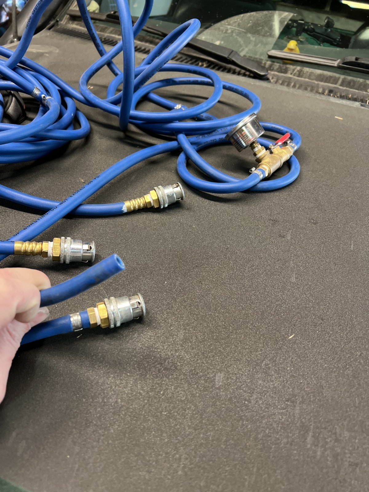

    Yeah, I made my own as well, not just awesome for airing up but airing down too, just one gauge to watch for all 4 tires, easy to control, fill up with a Viair 40067954726685__04719AF6-E81B-4AAB-A864-5823D6BA6EA1.jpg
    I used to use an ARB deflator that removes the valve core for many years. Only had one mishap early on where I messed up a core and fortunately had spares, but it was always a hassle, and fill ups were with an old MV-50 that I eventually cooked.
