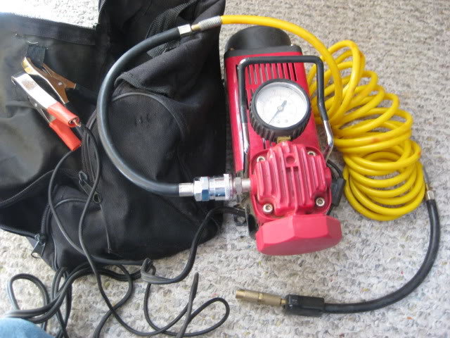

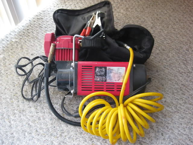

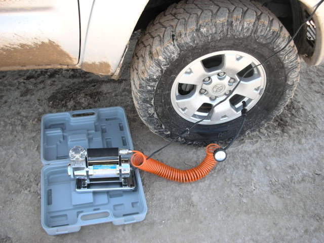

    Hmmm... I think maybe a plumbed in air system with a disconnect fitting on each side of the truck.
    I use a portable pump that takes 4 minutes to add 20 psi per tire (15 psi sand pressure back to 35 psi street pressure). Going from tire to tire, then a little cool down time to put it away adds to the 16 minutes of actual fill time.
    I also have the pump from Harbor Freight, it filled each tire in 3.5 minutes, so a tad faster. However, it stores in a bigger, plastic case... and it blows fuses... so the Tsunami one wins out.
