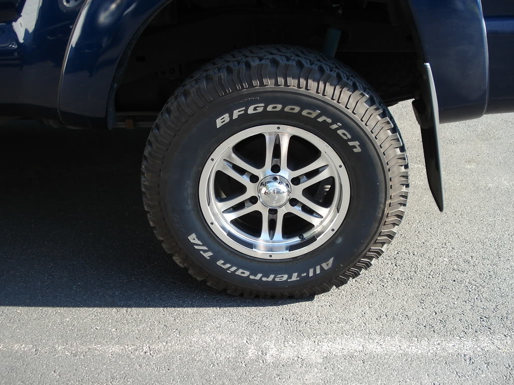

    Hey Willy, you really need to find an aftermarket rim with 4.5 inch backspacing like my Ivan Stewarts. I ran the 265s with no problem on my stock TRD off roads but I would have never tried that with 285s. If you are looking for an affordable rim go to Discount Tire and look for the Gunner 6s MB racing. I sold mine to another member. They looked nice. Heres a pic.

    Here you go Jumpmaster! When I called up I was looking for Toku's discontinued Rockers and they sold me on these by giving me the fourth for free. I talked to a guy named Zach about a year and a half ago. I think they had 4.25 inch backspacing. Good luck!
    Gunner 6
    16X8 6-139.7HR-6AM
    Reading the Wheel Size
    Finish: Anthracite Machined
    High gloss grey metal with more of a dark silver look and machined lip.
    $145.00 ea.
