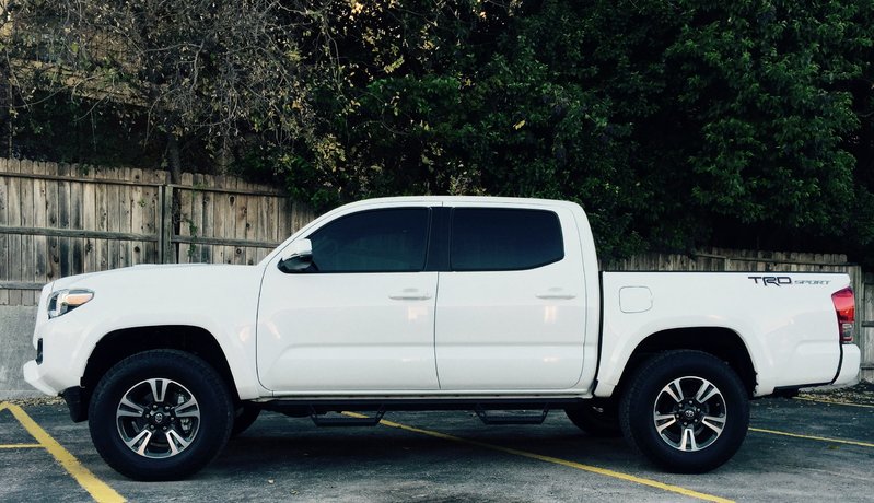

    Bilstein 5100s all around, Toyo All Terrain AT II 285/70/17, Custom Car Grill, front windows tinted at 35%, door still protectors, bed Matt, tail gate lettering, center console organizer and detailed with Adam's Polishes products
    I'm running Bilsteins on all 4 corners and the front is set at .85. I'm running 265/70/17 Hankook Dynapro ATm tires. You can judge for yourself because your truck is sitting higher. Since your truck is higher then mine I'm guessing that the 265/70/17 tire may look kind of funny.
