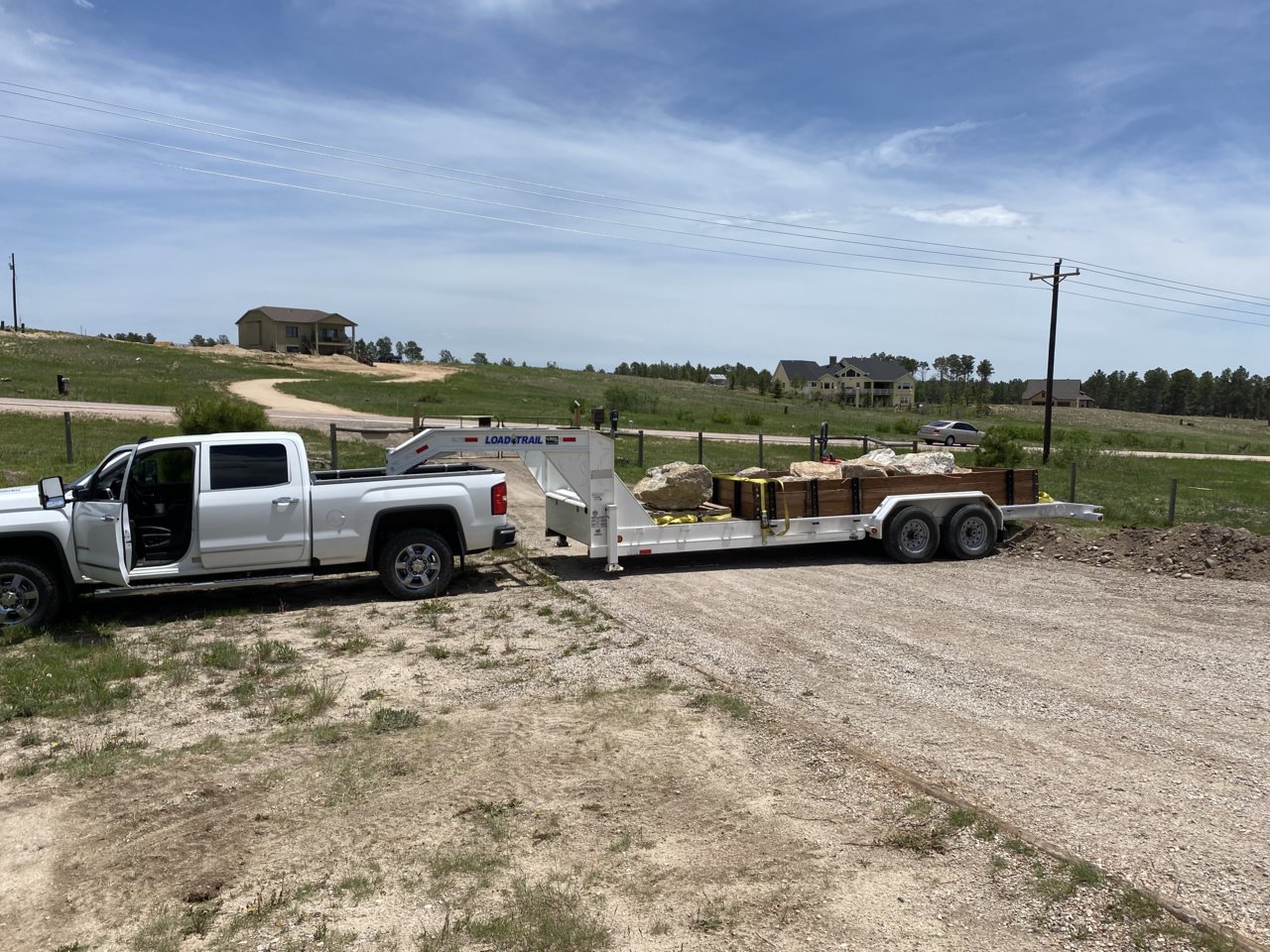

    I always smile when these debates come up (often).
    “These LR E tires ride like shit!”
    You don’t say? Probably due to the fact LR E tires are for this…
    1E8ECCC5-B252-4F4F-B6F2-C2F97B589D3A.jpg CF48C07C-24F0-4C9C-AF05-21D11D335C07.jpg
    Not this…
    Not to mention the extra weight between LT vs SL tires (around 8 lbs each corner).

    Nobody drives any vehicle standing still...:rofl:
    All jokes aside, you are what I would call the exception, not the rule. Most people on TW don't need E rated tires or shifting weight at 85 mph offroad.
    The rigs you seen in the picture above are LR C and D...FYI. Most of my Ultra4 racing friends run the same BFG's I do.
    su.b.rat[QUOTED] and Thatbassguy like this.
